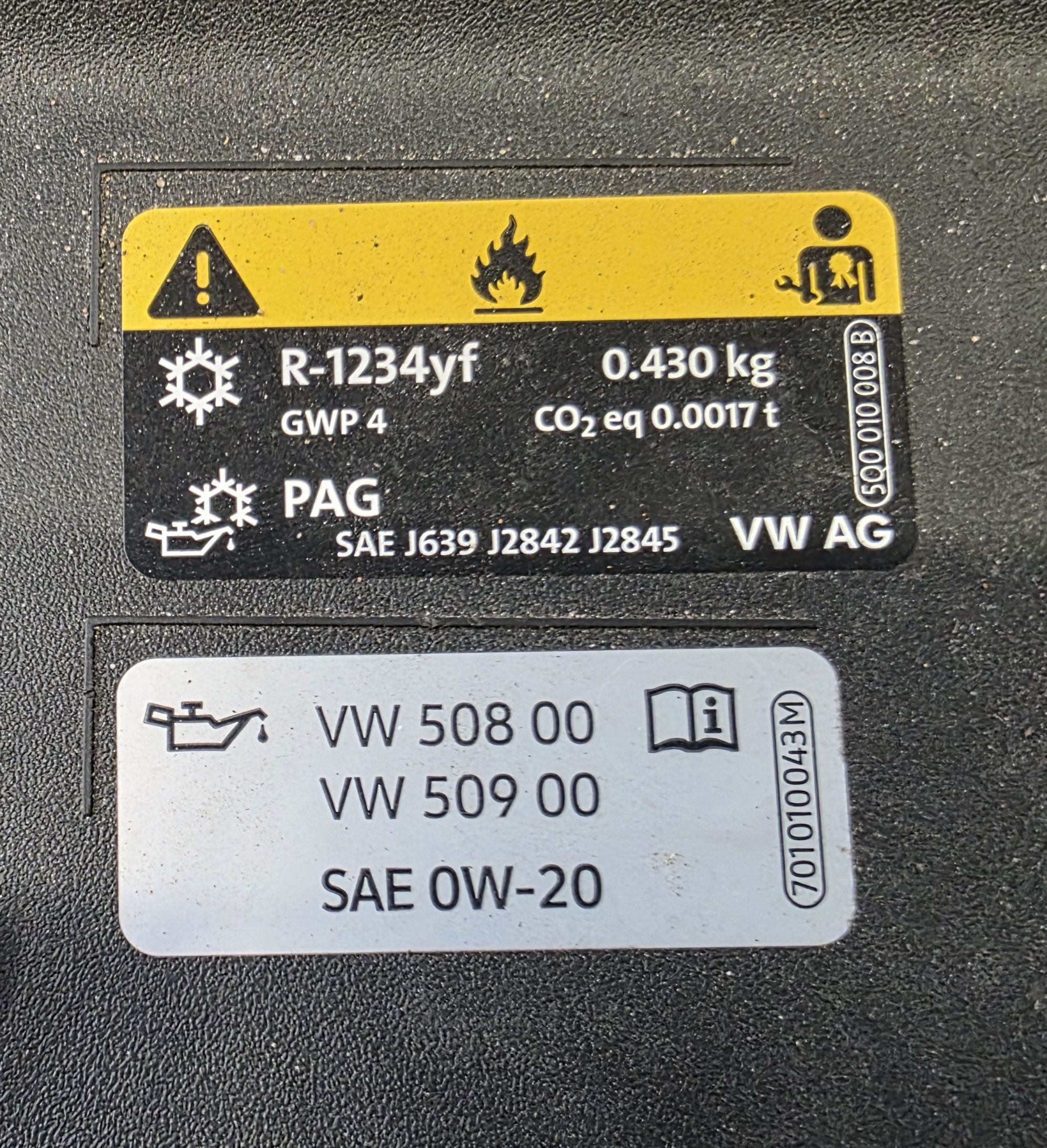

Instead, users are advised to refer to the engine bay sticker or consult a dealer to confirm the correct oil spec.

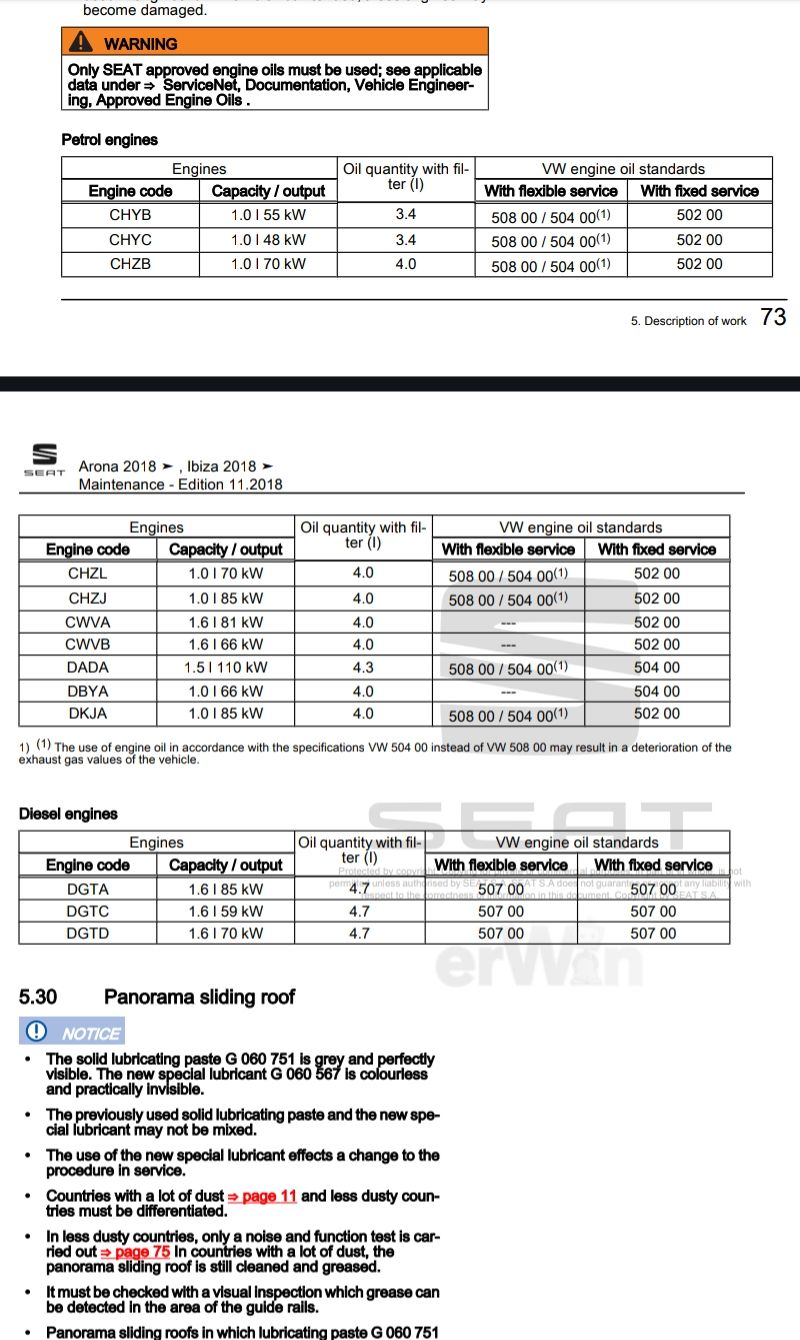

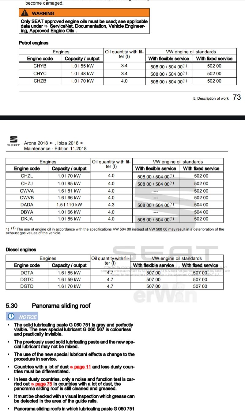

Well I would have gone straight to the Erwin maintenance manual for the answer rather than the cars pdf manual which are known to contains errors - cut and paste jobs. James is right on the lower VW spec oil ;). I was thinking of 502.
The 2018 page looks like this but you have a more recent engine. Hence the need to download it yourself.
2018 spec:
There is a lot not in the consumer manual and its those questions that come up here but the final answer is in the maintenance manual from Erwin. Although some flexibility in some areas such as AC fluid / brake etc.

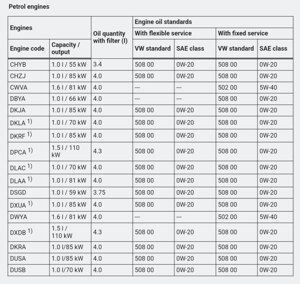

I'd always spend circa €15 on two hours of Erwin time to get all the manuals. Here in the UK there are the Haynes manuals the Erwin material gives you much more detail. Erwin is the go to place, the Vag official manuals used in the trade. The odd €15 is neither here nor there against the cost of the car and provides a resource if you need to start taking the car apart.

FYI, exactly the same oil but 508.00 is the petrol spec, 509.00 is diesel.
2018 spec:
Thanks a lot — that really cleared up my doubts. I didn’t expect Erwin to contain such specific engine-level details, especially beyond what’s in the consumer manuals. I’ll definitely use the platform myself next time. Appreciate the tip.
