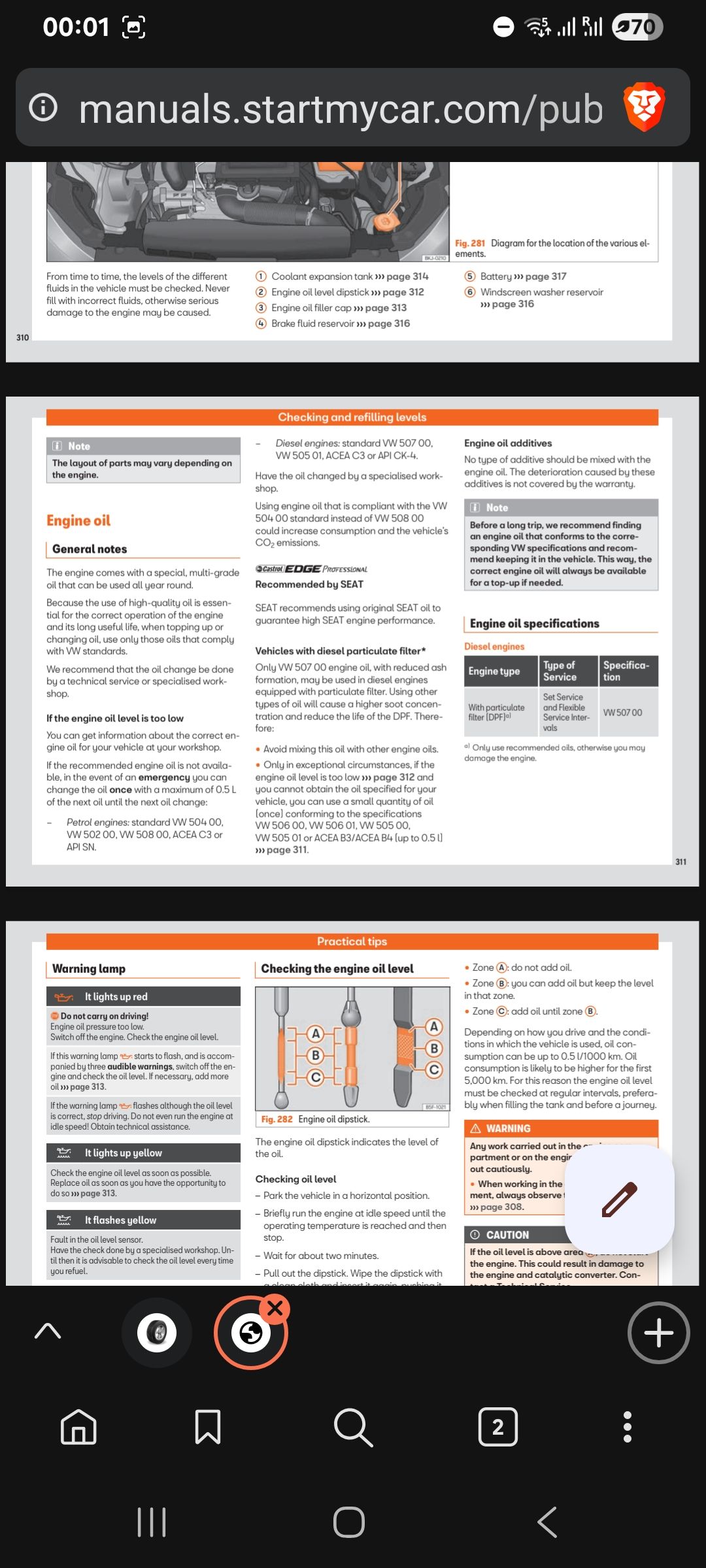

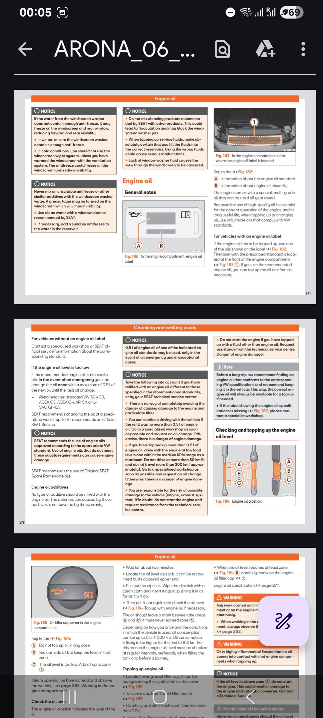

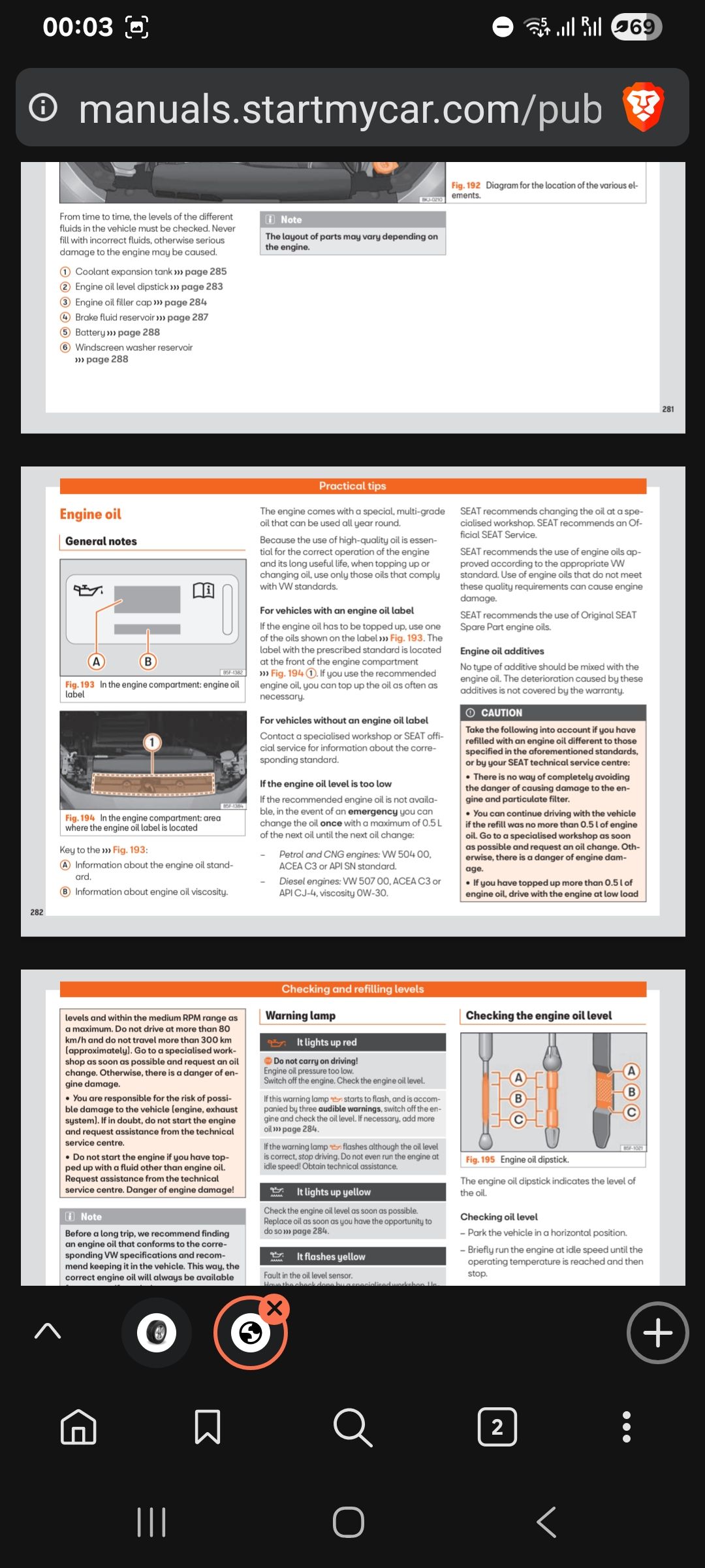

Just wanted to follow up with a few screenshots from the official Seat Arona user manuals — 2020, 2021, and 2023 editions.
All three refer to TSI EA211 engines, but the oil specification section changes noticeably over the years. In 2020, VW 508.00 is clearly listed. In 2021, it disappears. And by 2023, it’s still missing — even though many oil manufacturers continue to recommend it for EA211.
I’m not posting this to criticize anyone, just to help clarify things. If anyone has manuals from other models or markets, feel free to add them. Maybe together we can figure out why this change happened — and whether it affects how we maintain our cars.
