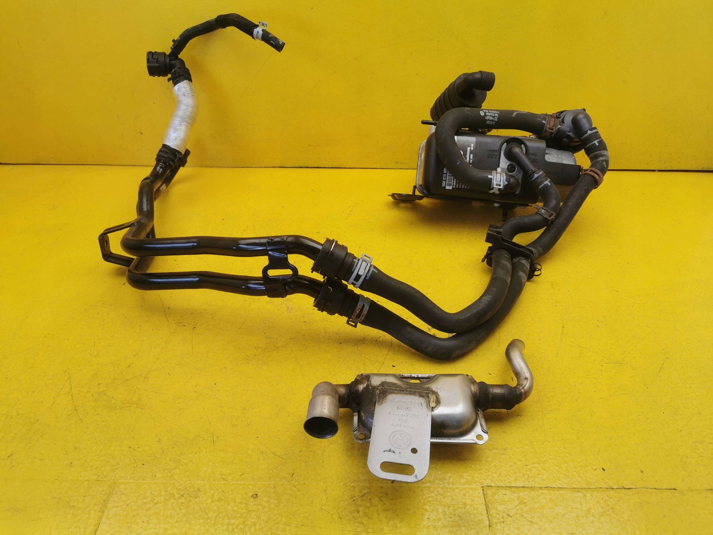

  • 1x 5Q0815005AF - heater unit - other part numbers might work too, heater units which PN start with 5Q0 are guaranteed to work in MQB cars
  • 1x 5Q0898595B - heater unit bracket
  • 1x 5Q0898144 - air intake silencer
  • 1x 5Q0898061 - exhaust manifold
  • 1x 5Q0819193B - exhaust

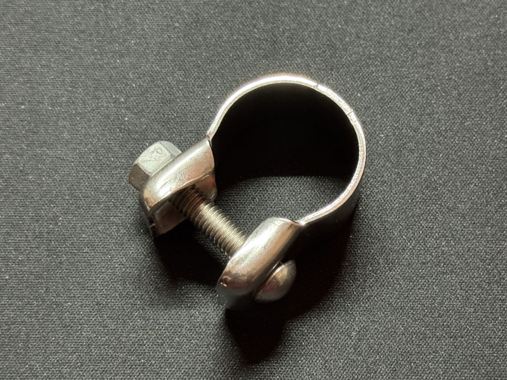

  • 1x 7H0819600A - exhaust clamp

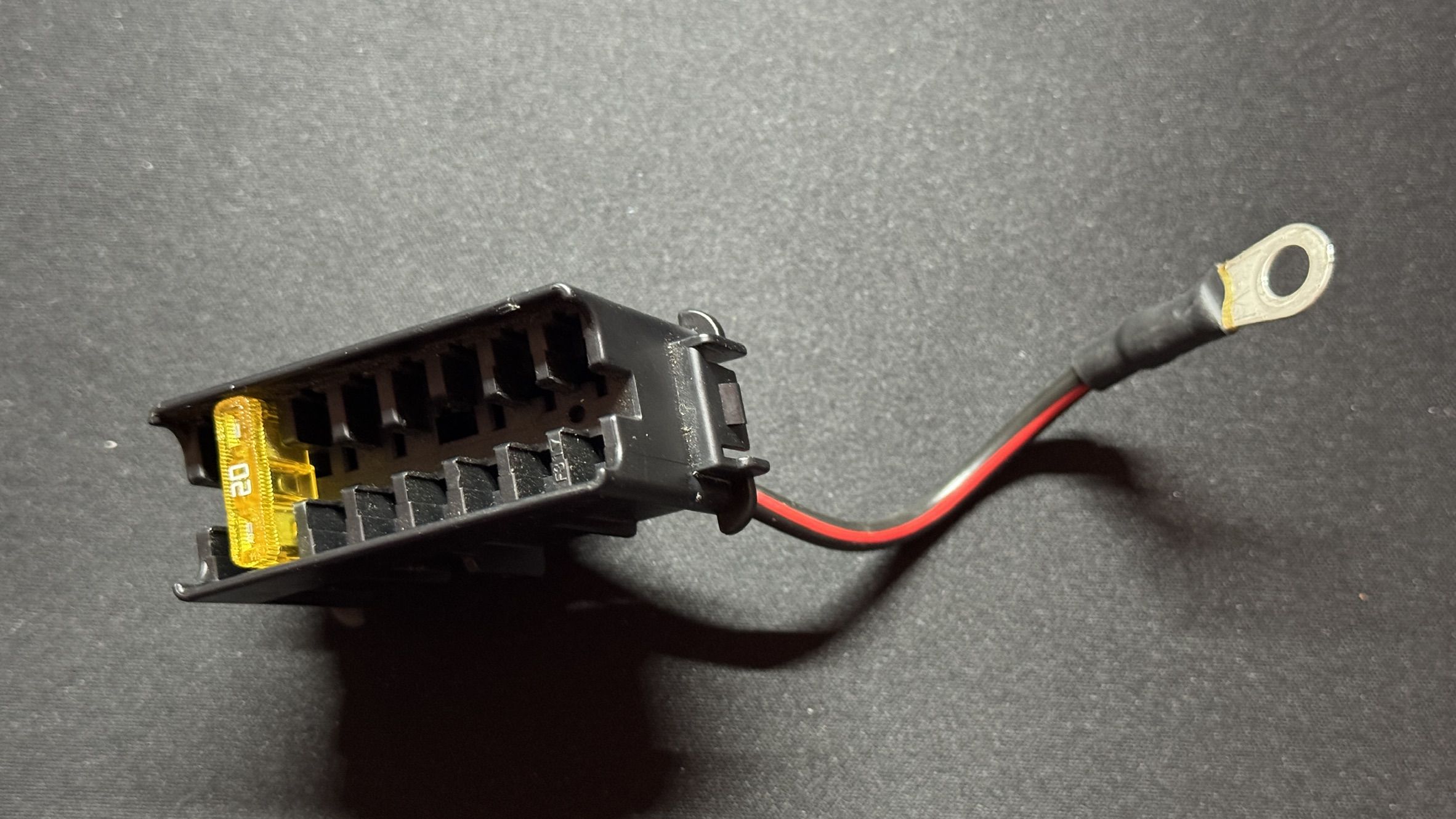

  • 1x 5Q0941824 - engine fusebox fuse holder - be aware that this part number does not have preinstalled thick cable (see photo); if you want to recreate OEM wiring (use SB37 fuse for auxiliary heater) I would recommend ordering second-hand fusebox and disassemble this fuse holder
  • 2x 000979227E - terminals for engine fusebox

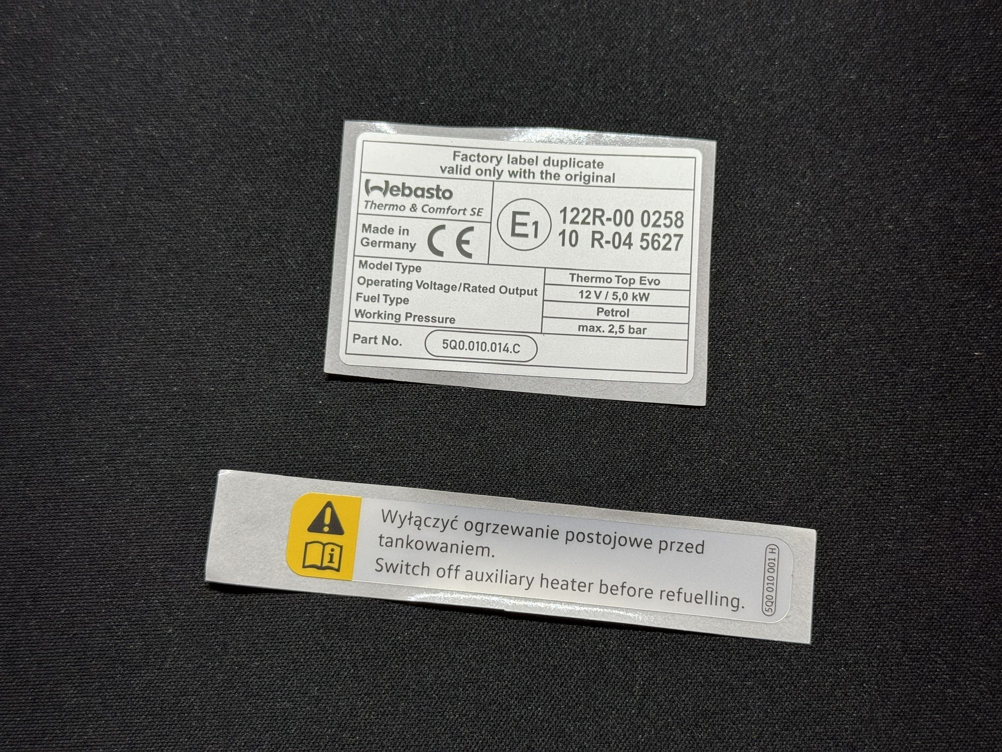

  • 1x 5Q0010014C - information sticker
  • 1x 5Q0010001H - information sticker

- second-hand heater unit with most of the required parts - hoses, intake, exhaust, coolant pump and other small parts.
VW-T-Roc-WEBASTO-OGRZEWANIE-POSTOJOWE-5Q0819183B-5Q0815005AF

- stickers
