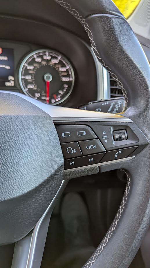

Hoping someone can help with issues that have developed on my Ateca.
2021 SEAT Ateca XPERIENCE TSI EVO
Steering wheel buttons are mostly not working:
  • Left/right navigation: unresponsive 90% of the time
  • VIEW + OK buttons: unresponsive or working sometimes
  • Up/down scroll: works fine
  • Can't navigate MFD properly
Also MFD gets stuck sometimes.
Likely to be defective buttons. As for the software updates, we can perform them
