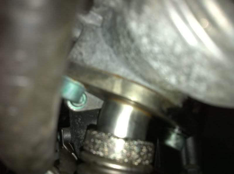

So I've tried to have a go at removing my egr valve and fitting the Allard Delete kit, the two bolts on the top & side are easy enough to get off, but there is one F*#KING bolt I can't get to no matter what I do access isn't 100% . I've spent a good two hours today and cut my hands to bits so I'm on here to seek for advice, one thing I have noticed online like YouTube it's they have Allan keys and there is 3 bolts on mine.

3rd bolt is bit of mare mate! U need to remove loosen the the hot air/gas pipe that connects on the exhaust manifold first. take the teo Allen headed bolts out first downwards , the feed pipe can then be moved far enough out the way that the 3rd Allen bolt holding the egr valve is accessible !
Hope helps 

Crap pic had in iPhone but might help explain
