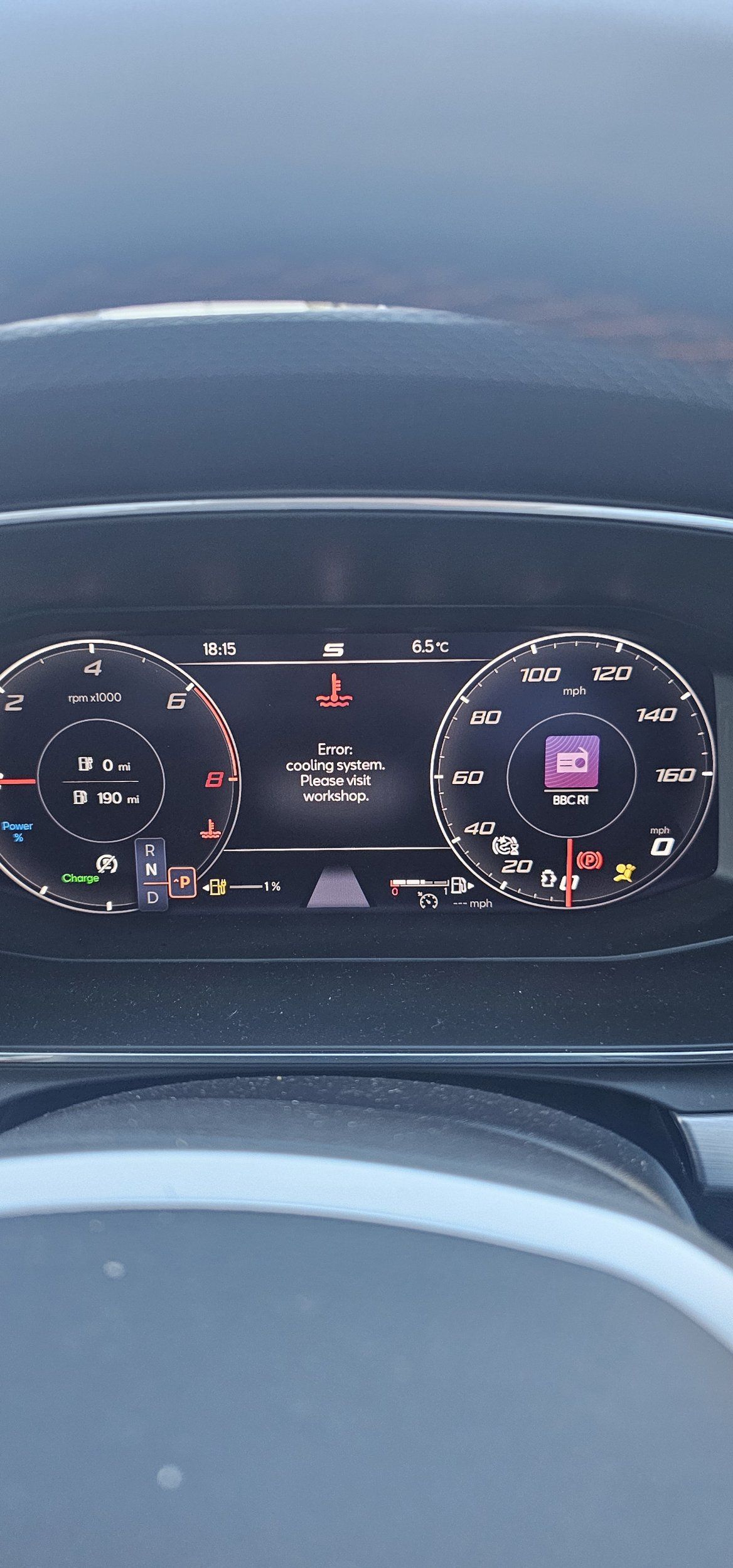

So my car developed this fault about 2 months ago now, had to wait 1 month for a slot to get it looked at at the dealer.
The car went into them on the 30/09/2024 and I was provided a courtesy car.
An initial inspection happened the next day and I was informed it looked as if the coolant from the electric drive system was leaking onto the batteries but further diagnosis was required.
Was told there would be a charge of £470 for the diagnosis if the fault is not covered under warranty.
Today marks one month exactly of them having the car and still I am awaiting a diagnosis of the fault. They need 2 master technicians to work on the vehicle at any one time and due to holiday, sickness etc my car is still in the queue to be looked at, I've been informed it will be at least another week before a diagnosis can be offered.

So just a quick update. I finally have my car back. Despite initial concerns the fault turned out to be with the High Voltage Coolant Heater which has now been replaced under the 8 year/100,000 mile battery warranty.
Upon asking for an estimate of what the cost would have been had it not been covered under warranty, it was roughly broken down as:
£570 Diagnosis
£740 New Part
+ 4 Hours Labour
TOTAL: £1600 (approximately)

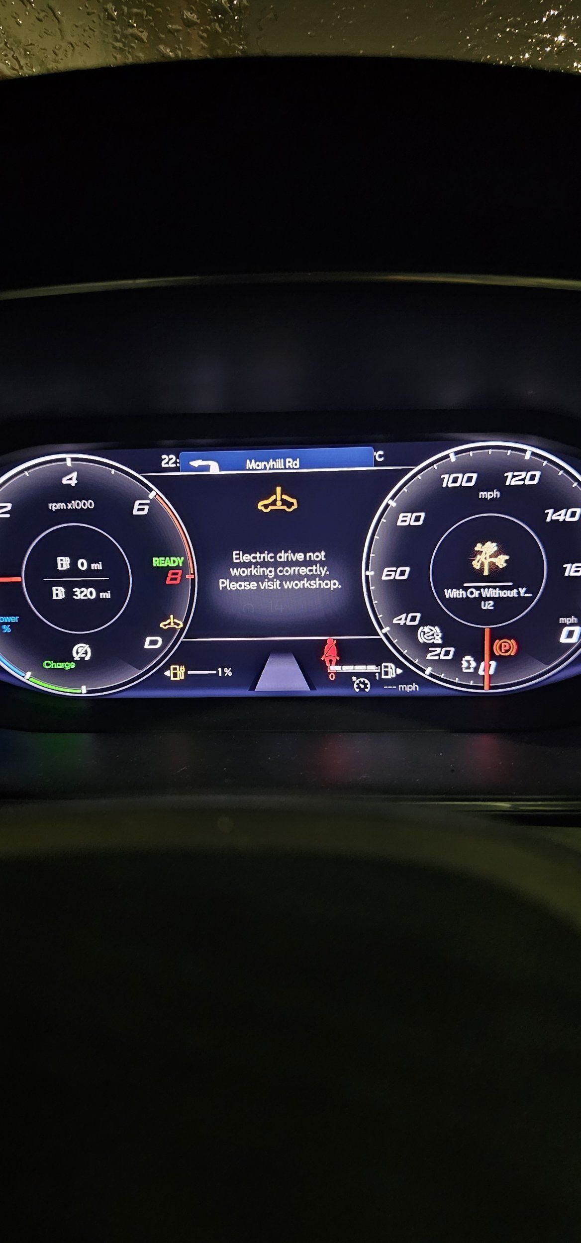

And today, another new fault.
This car is definitely the worst I've ever owned in terms of reliability.

Late update. Got car back on 26/04/2025 for the most recent fault.
This time they replaced the High Voltage Chiller, flushed the coolant system and replaced the coolant.
Once again covered under warranty.

Here we go again. Fault has now occurred for a 3rd time. I can't even get the car into gear and it says engine speed limit to 3000rpm, which is ironic as it won't even start
