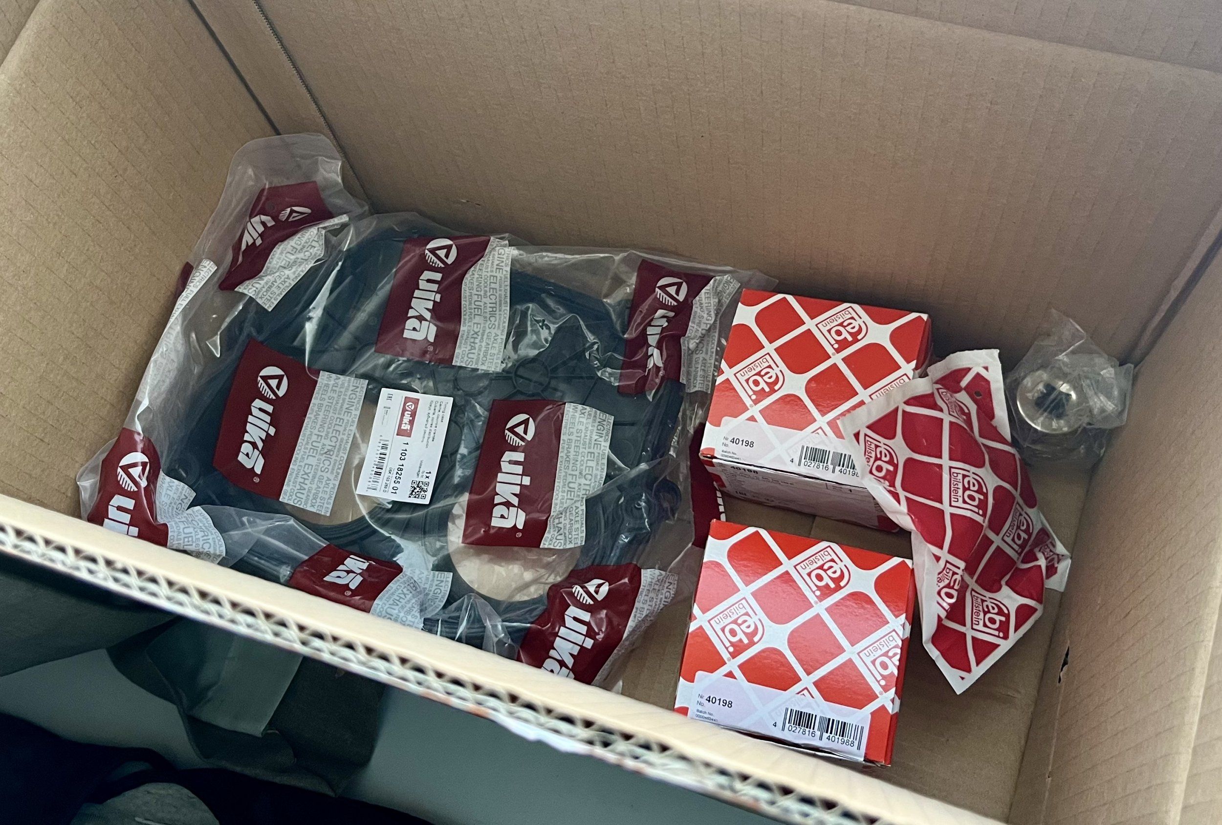

Update: mechanic has confirmed both cam magnets need changing. I’d already bought the 2 magnets, timing cover with bolts n gasket, new dipstick and oil cap. I’ll try replace these myself at the weekend.
I replaced them without the timing cover. Replacing the cover is a lot more work compared to only changing the magnets.
Check from about 10:30
I know, but a bolt on the timing cover snapped and the gasket for the timing cover is failing, and oil is leaking from there. So may as well do that too.
Replaced the cam magnets, and the snapped bolt for the timing chain cover. Old cam magnets were definitely finished. The small notch in the centre would not move at all. The notch of the new magnets moved freely??

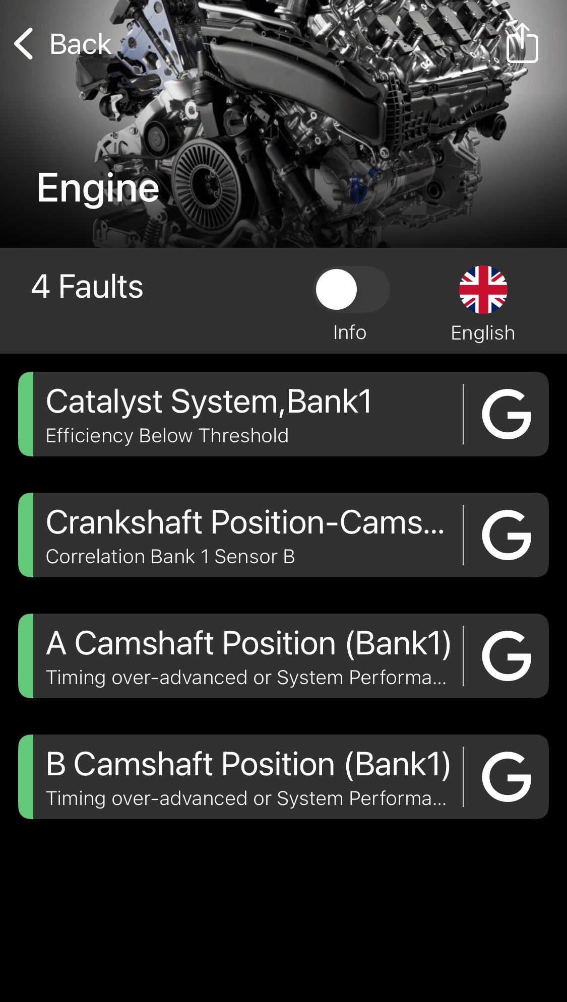

Hi guys, any ideas about this? Leon Cupra 280 DSG, on just over 120,000 miles. These are the error codes. Has been happening for a while now. 6 months after an oil change, car asks for 1L of oil every month or so. When the cars idling, it’ll rough idle sometimes, and revs will fluctuate and engine will judder, but only intermittently. Getting low to mid 20mpg with normal driving. No other symptoms. I’ve got a res delete, no other mods. Changed the PCV valve and PCV hose recently. Had a compression test last year. All compression is within spec, but at the lower end of the range. Ideas?
