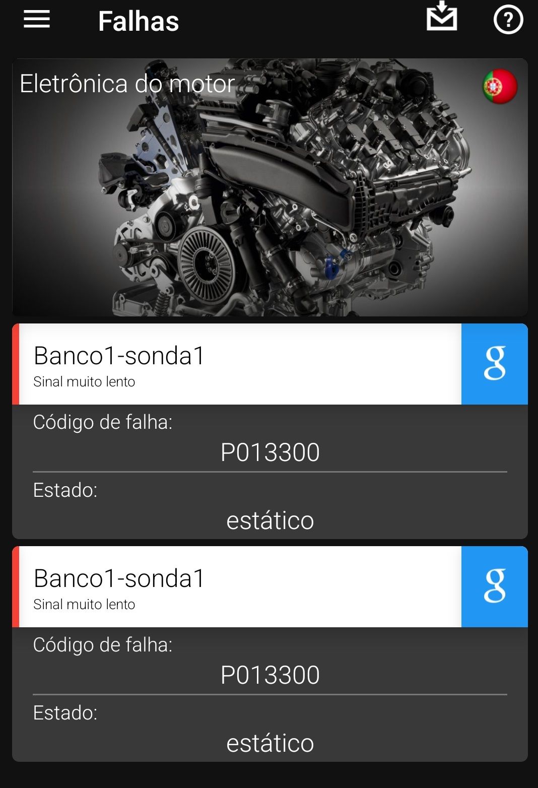

Currently have 35000 km (21747 miles) and the yellow engine light turned on, I scanned the errors with OBD Eleven device and the failure code it's P013300 - sensor 1, bank 1 - very slow signal.

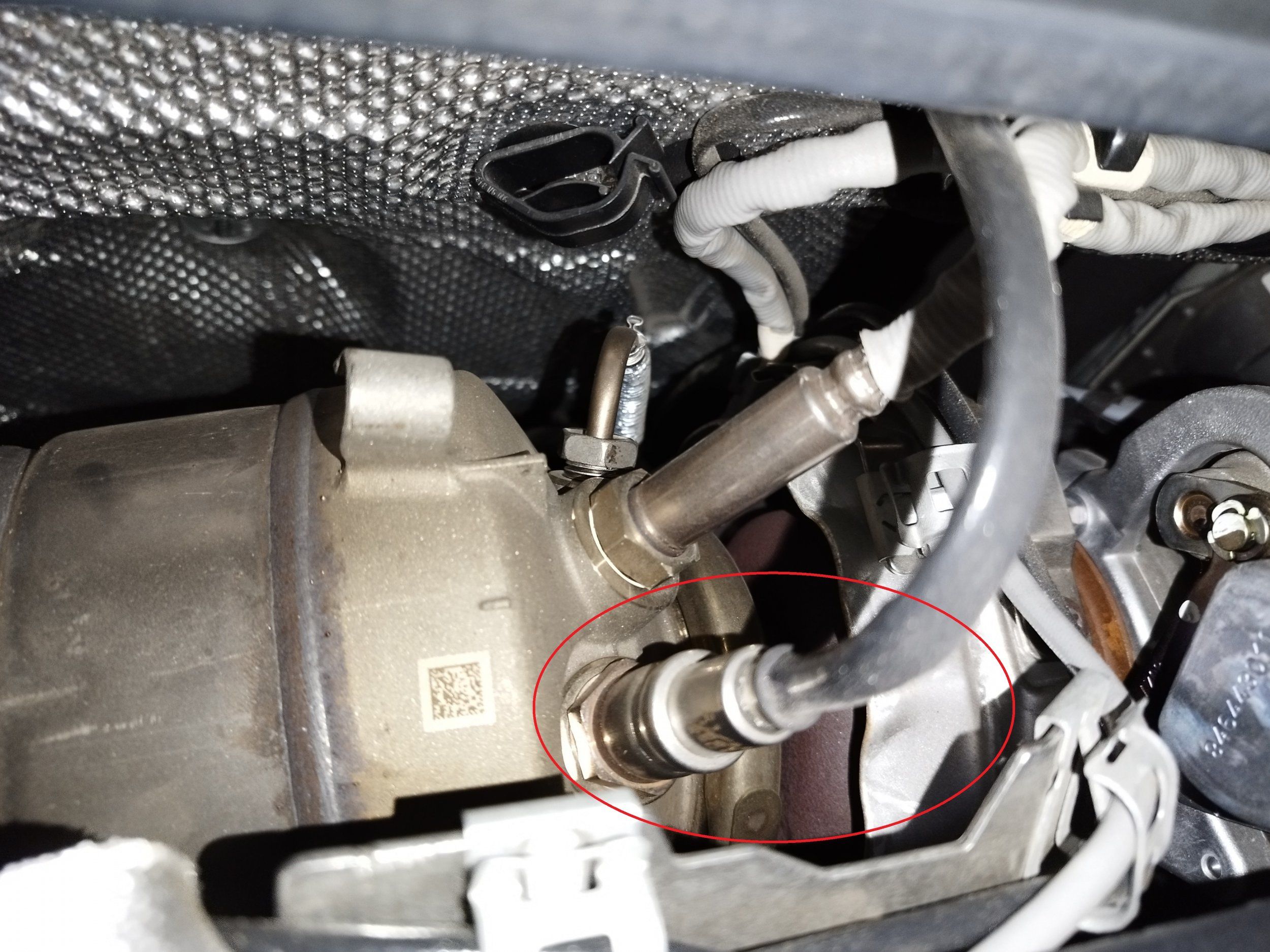

I'm afraid because the guaranty time already finished and I don't know exactly what is the issue. I think that the problem it's the O2 (Lambda) sensor but not sure, so I ask your help, if someone had that problem could please help?

In my case, the issue was fixed replacing the lambda sensor, outside the warranty by myself.
