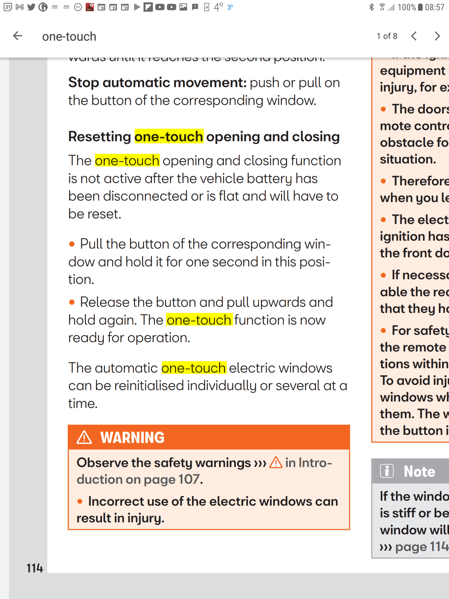

The correct way of working on wiring is to disconnect battery. Breaking part of the airbag circuit when live leads to the issue. If the whole lot is disconnected then it doesn't occur. The downside of this is that atleast in the Ateca one touch window lowering and mirrors in needs resetting. Suspect this may carry over onto the Leon 4. Keep a note on the tablet should this occur:
Resetting one-touch opening and closing
The automatic open and close function will
not work if the battery has been temporarily
disconnected. The function can be restored
as follows:
– Close the window as far as it will go by lift-
ing and holding the electric window switch.
– Release the switch and then lift it again for
1 second. This will re-enable the automatic
function.
If you push (or pull) a button to the first
stage, the window will open (or close) until
you release the button. If you push or lift the
button briefly to the second stage, the win-
dow will open (one-touch opening) or close
(one-touch closing) automatically. If you op-
erate the button while the window is opening
or closing, it stops at this position.
Indeed it's in the Leon 4 manual attached. The mirror in on automatic least on a Kessy is also effected. An undocumented feature till the process is completed.
