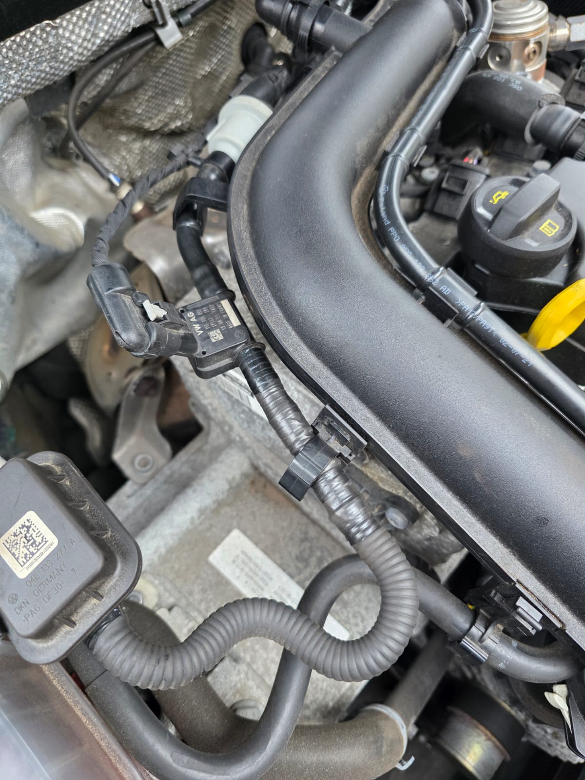

Did you managed to figure it out? if so how did you resolve it?
I had the “Error: Drive system. Please visit workshop” this evening though not on your specific model of car but on the Seat Leon FR 2021 1 liter this evening.
I luckily made it home with my family but the car really struggled with any inclines and felt like it didn't have any power. I was very lucky it was in the evening or I would have really struggled to 'get gone' at any busy junction.
Strangely enough there isn't any record of this error when scanning with a OBD11 report wise. Praying its back to normal tomorrow as I dont have any garage in my town that are able to deal with the newer Seat cars.
I've managed to resolve my issue, temporarily, at local garage and will have a permanent fix when the replacement parts come in. This area of the piping was possibly bodge fixed using insulated tape:
I've recorded a video for anyone that might find this helpful, especially the sound I had which sounded like a lot of air from the engine bay:
