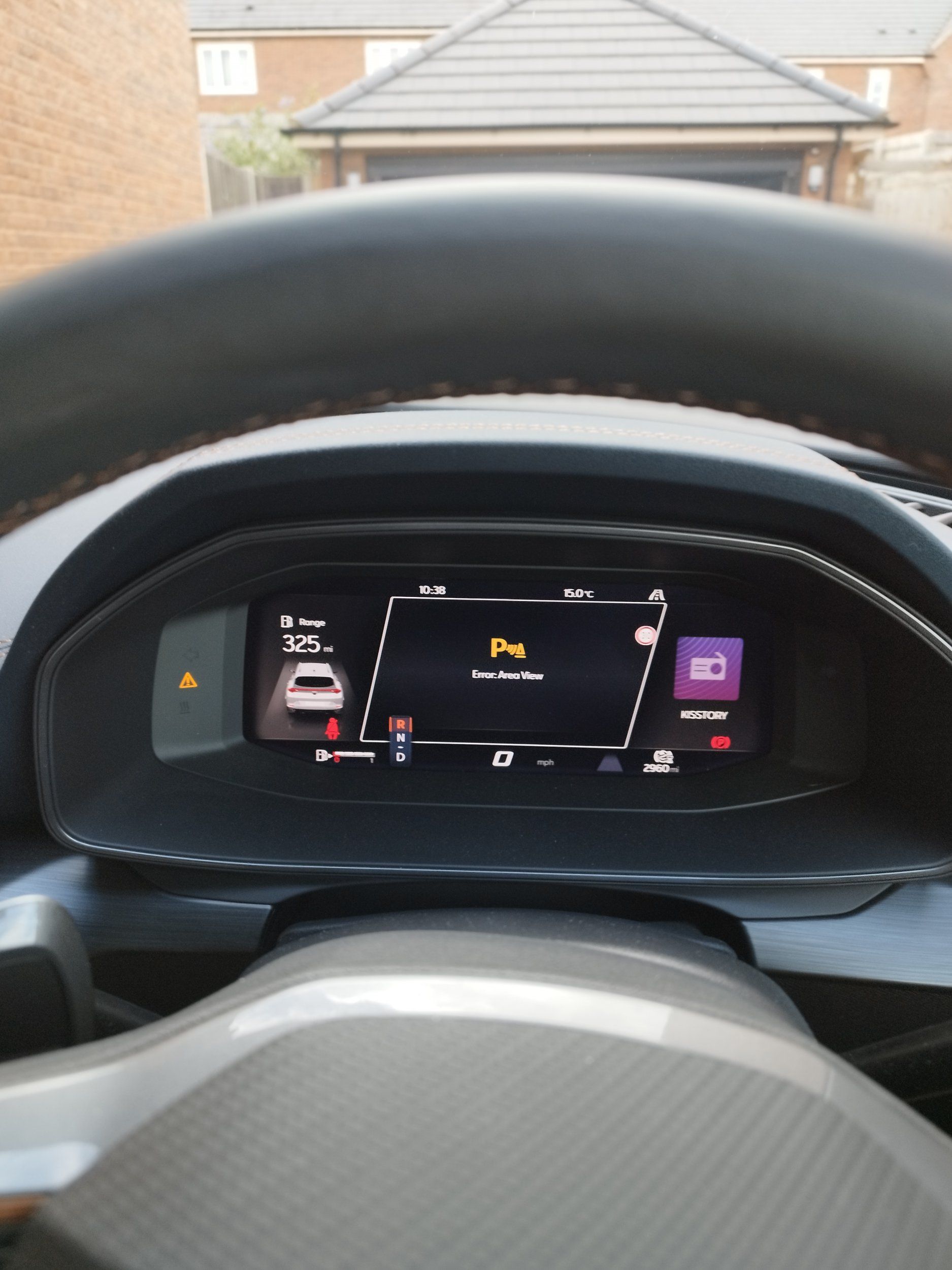

More an FYI for people in the future as didn't find anything on the forum for a fix.
Our 2023 Formentor with surround view did an over the air update this morning. Upon restarting I kept getting Error: Area View and none of the cameras were working.
Just about to go away on holiday and thought great but found it was a real easy fix. Gain access to the fusebox behind the glove box and removed fuse 21 7.5a which is the 4th up from the bottom on the left, first row of mini fuses.
Problem solved, hope this helps others.

Just pulled it out and straight back in. It's the power supply for the cameras. My cars fitted with the 360 system but it's the same fuse for the rear only camera.
