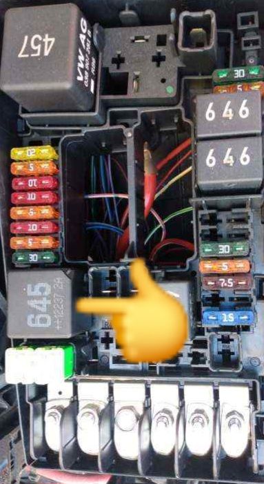

Hi guys, I have finally figured it out and it was literally the 645 Relay under the hood, I pulled it out and wiped it and put it back in and it’s solved my problem so hopefully if anyone else has that issue it’s an easy fix👍🏽

The contacts will be burnt out on the relay.
I took that picture the other day and was going to suggest you look in that area but when you said there was no codes (which I still find difficult to believe) I chose not to send you down the potentially wrong direction.
Take it out, open the casing, if the contacts are burnt then you'll need to replace the relay, or you'll end up in the same situation again.
