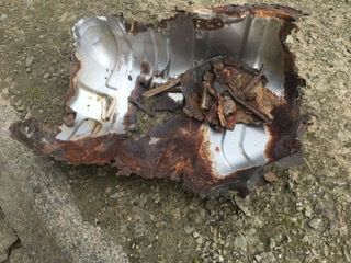

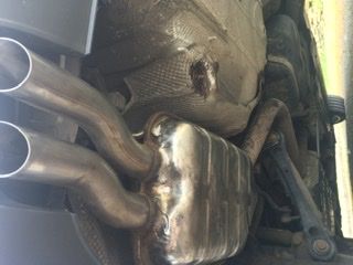

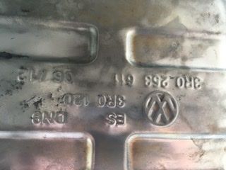

After a Sunday afternoon under my Exeo’s back end it’s now complete without it’s rusty exhaust outer covering and a wiz over with the wire brush on my drill and the stainless exhaust is nearly as good as new.
Ohhh and as others have said before there’s a VW Badge and part no now visible.
