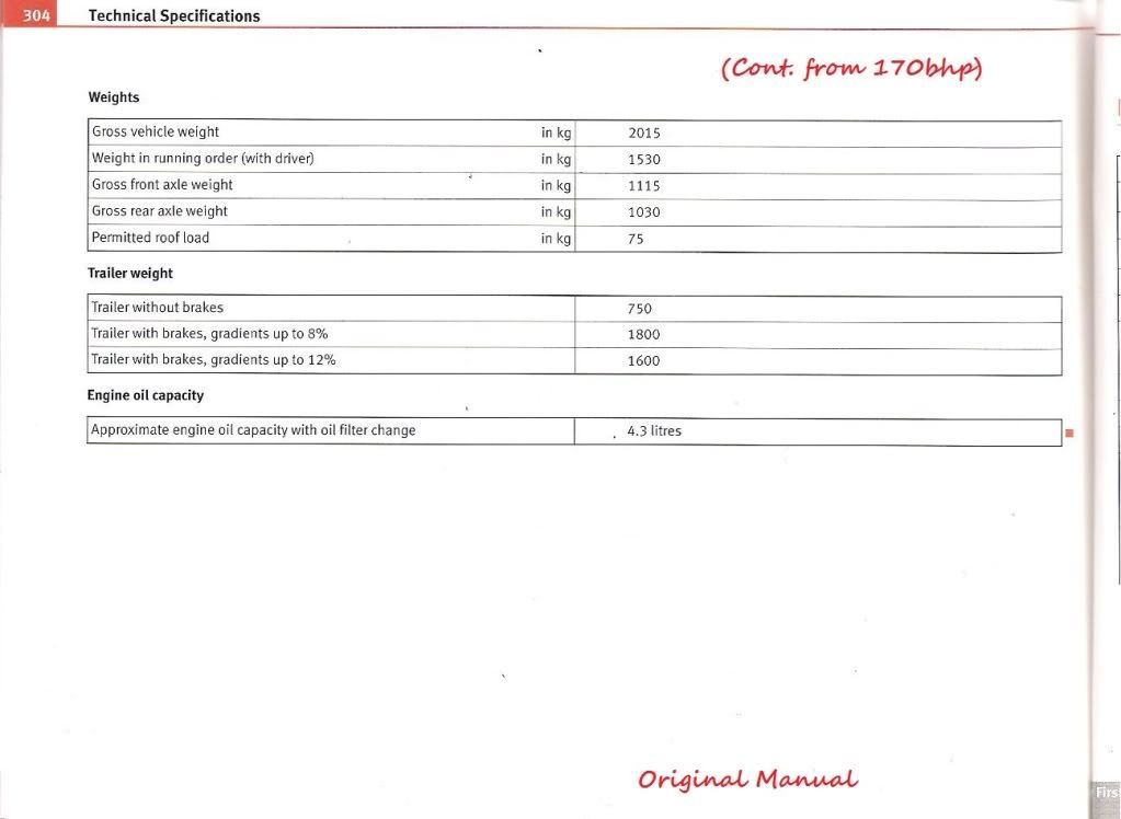

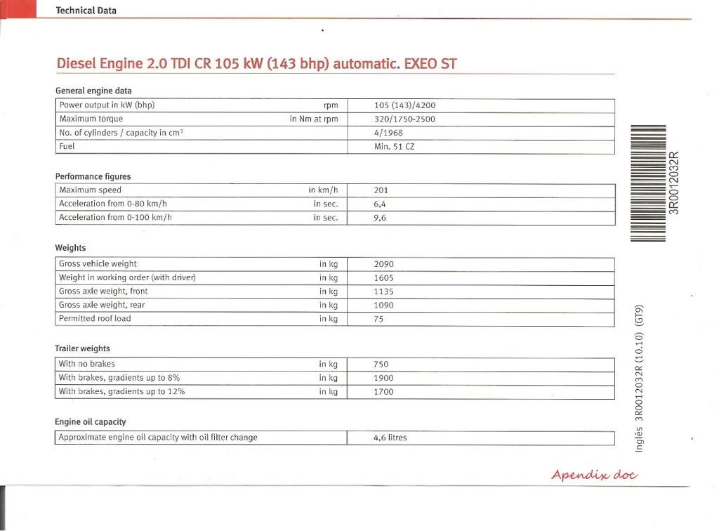

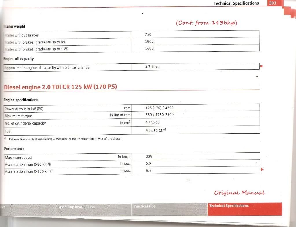

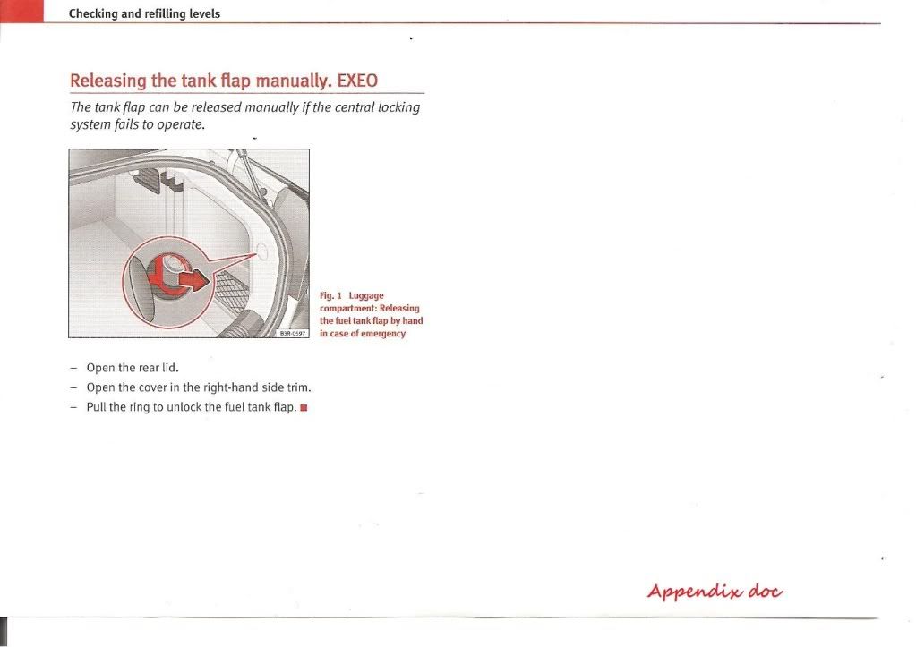

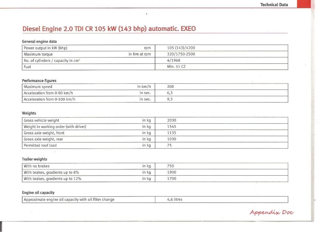

OK, the first 3 images are from the Appendix Doc (I have labeled each pic appropriately with red Script Type) They appear to be the changes for the Automatic gearbox though, so maybe not much help)

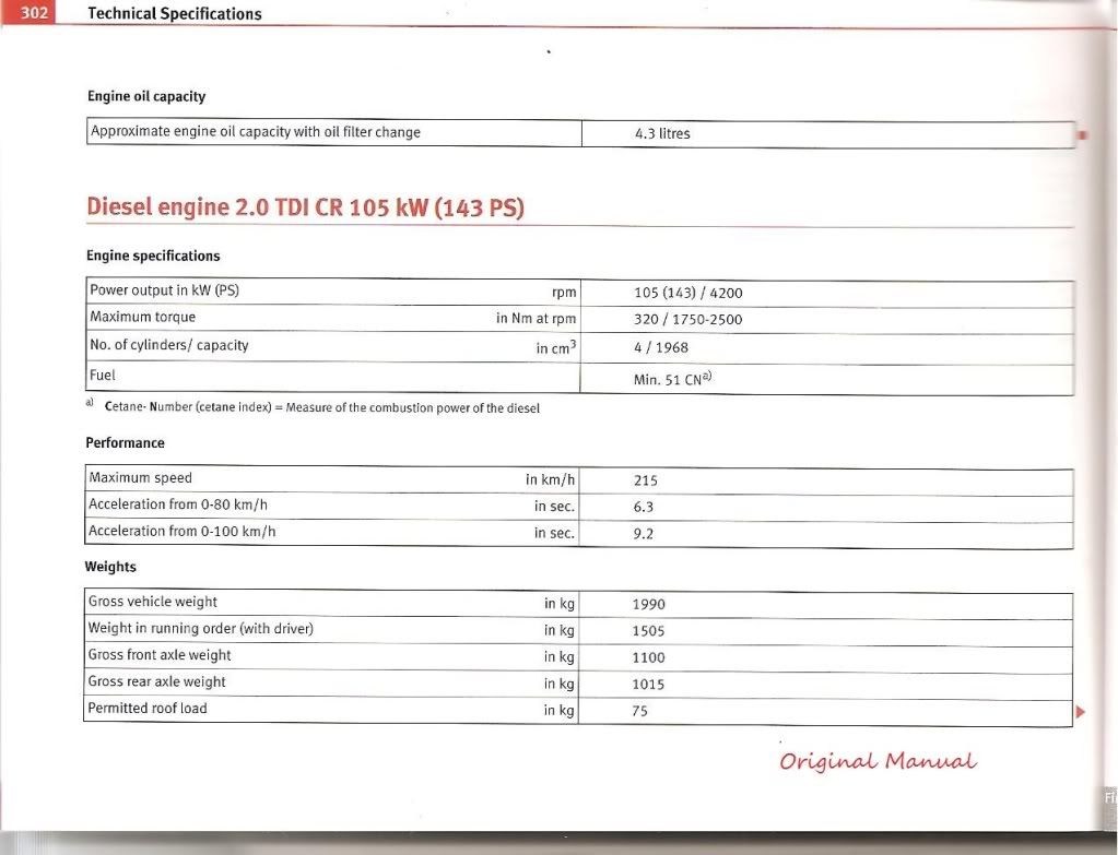

The rest are scans from the original Manual (again labeled)
This Exeo and documentation was delivered 25 March 2011 - hope it helps.
Thanks for the scans. Still says 1600kg as the towing weight for the 143 CR TDI manual, the amendments are just for the new multitronic auto model which can tow 1700kg.
Found out now that all 143 2.0 CR Exeo towing weights are now 1400KG due to a change in the gear ratio by the factory.
