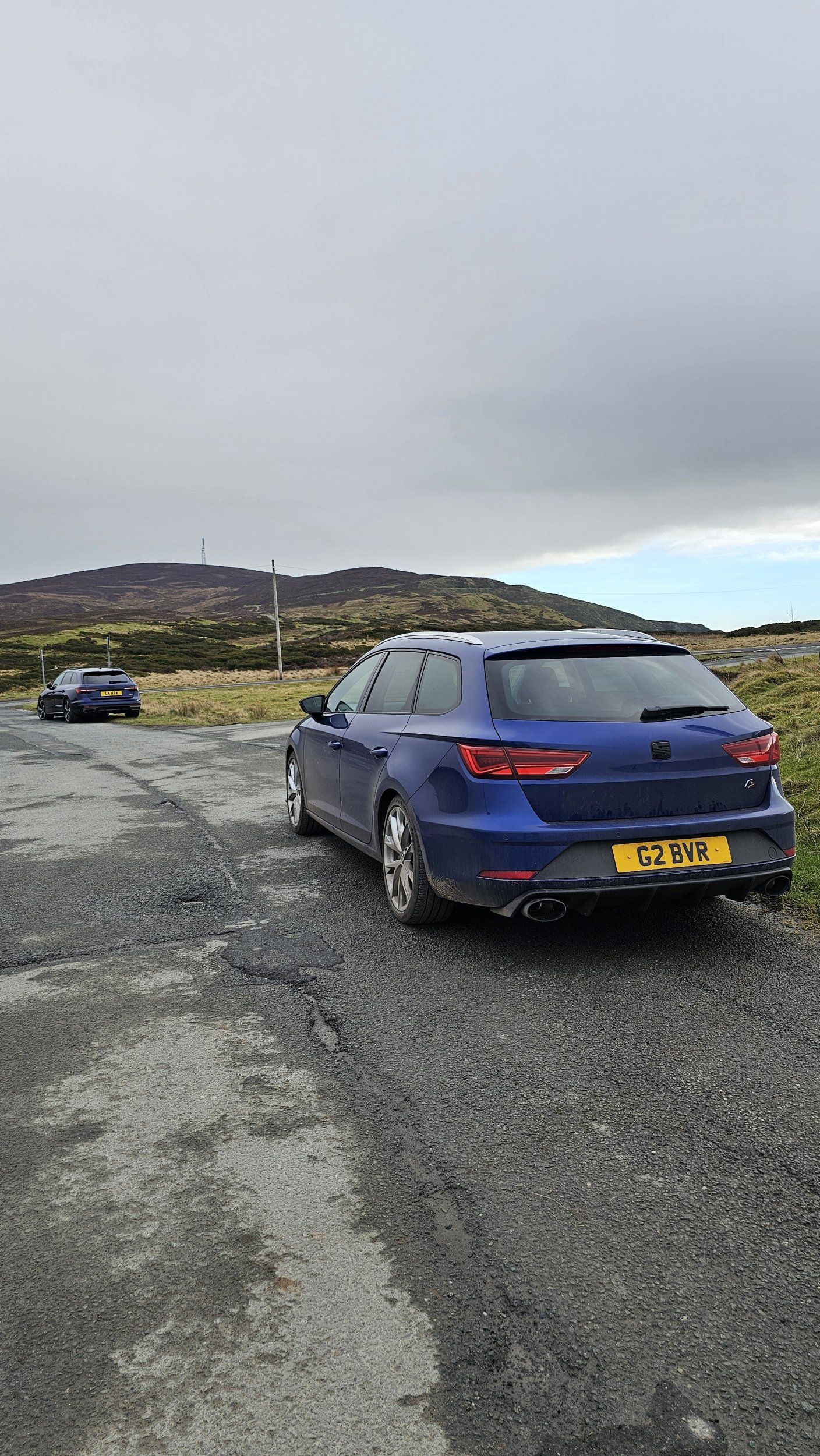

Hi guys,
Recently had a droning noise coming from the center of the car towards the back mainly between 1-2k rpm? Also average mpg down from 35/40mpg to 25mpg. Leon FR190 ST (2019). Any ideas? (Exhaust silencer??).
Around 12 months ago I had the backbox removed and the RS3 tips fitted which was done by DKU Performance who seem to be one of the best in the game?
