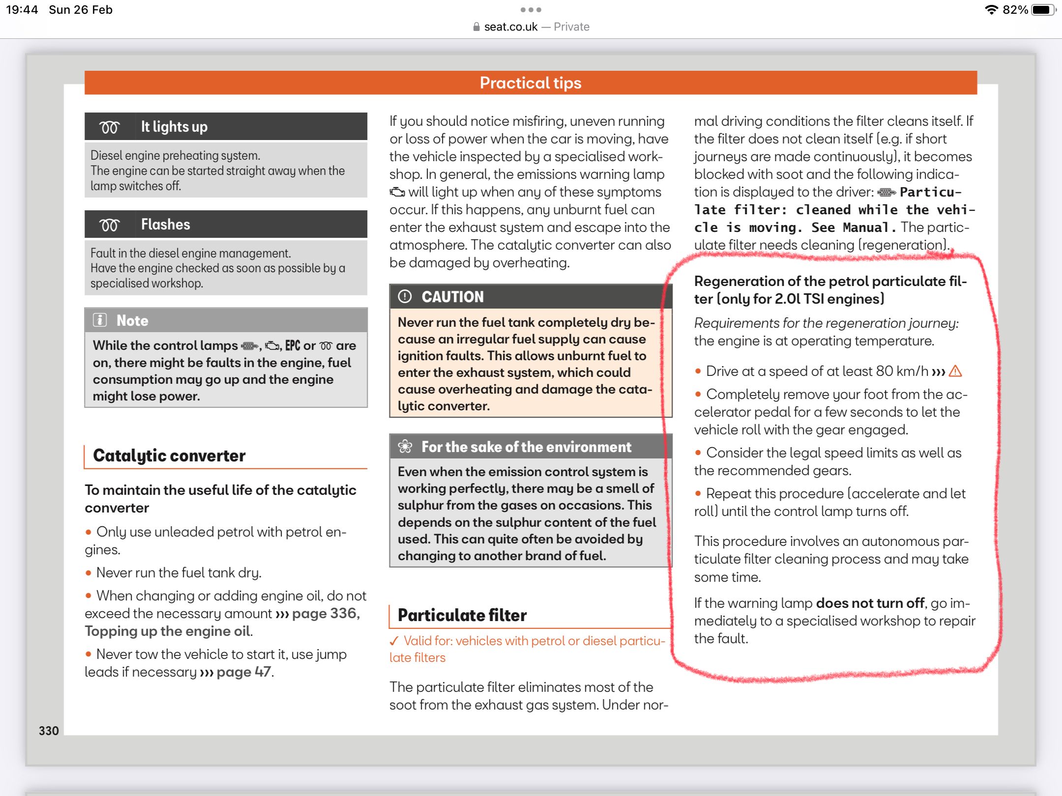

It’ll certainly do no harm to take your car on a longer run, although if you’re doing a regular journey of around 45 minutes on A roads or dual carriageways with free flowing traffic, that ought to be sufficient to keep the GPF pretty clear of excessive soot accumulations. Having said that, it’s not known what types / length of journeys the previous owner of your car drove on a regular basis.
Screen shot of section from the owner’s manual (Nov 2019 edition) for cleaning the particulate filter is below.
Removing your foot off the accelerator as described in the owners manual helps to draw air / oxygen into the exhaust system as the car decelerate, and the extra air / oxygen aids the process of burning off any soot accumulation in the particulate filter. I carry out this process periodically in my car on longer journeys to (hopefully) help reduce soot build up. I tend to change down to fifth gear, accelerate to around 3,500 - 4,000 rpm and remove my foot off the accelerator to let the car decelerate. I repeat this process usually around 6-7 times.

35k miles and 3.5 years and never noticed a regen but this morning after a LOT of short runs recently as working from home more had the exact same symptoms as above.
Took for a run as per procedure and all clear now. Was not worried as read about it before here.
My only point to make is my manual does not have above change / details my is an 18 (68 plate) and also no light on dash so can see an owner without knowledge and forum access why they would think something amiss and start worrying.
Maybe correct manuals not sent out with cars and dash light not setup - anyone get a dash light. Would def help resolve the worry when all above symptoms happen.
PS - thanks SRGTD for the updated manual page.

What’s the best way to force a regen? Just so I can at least rule that out.

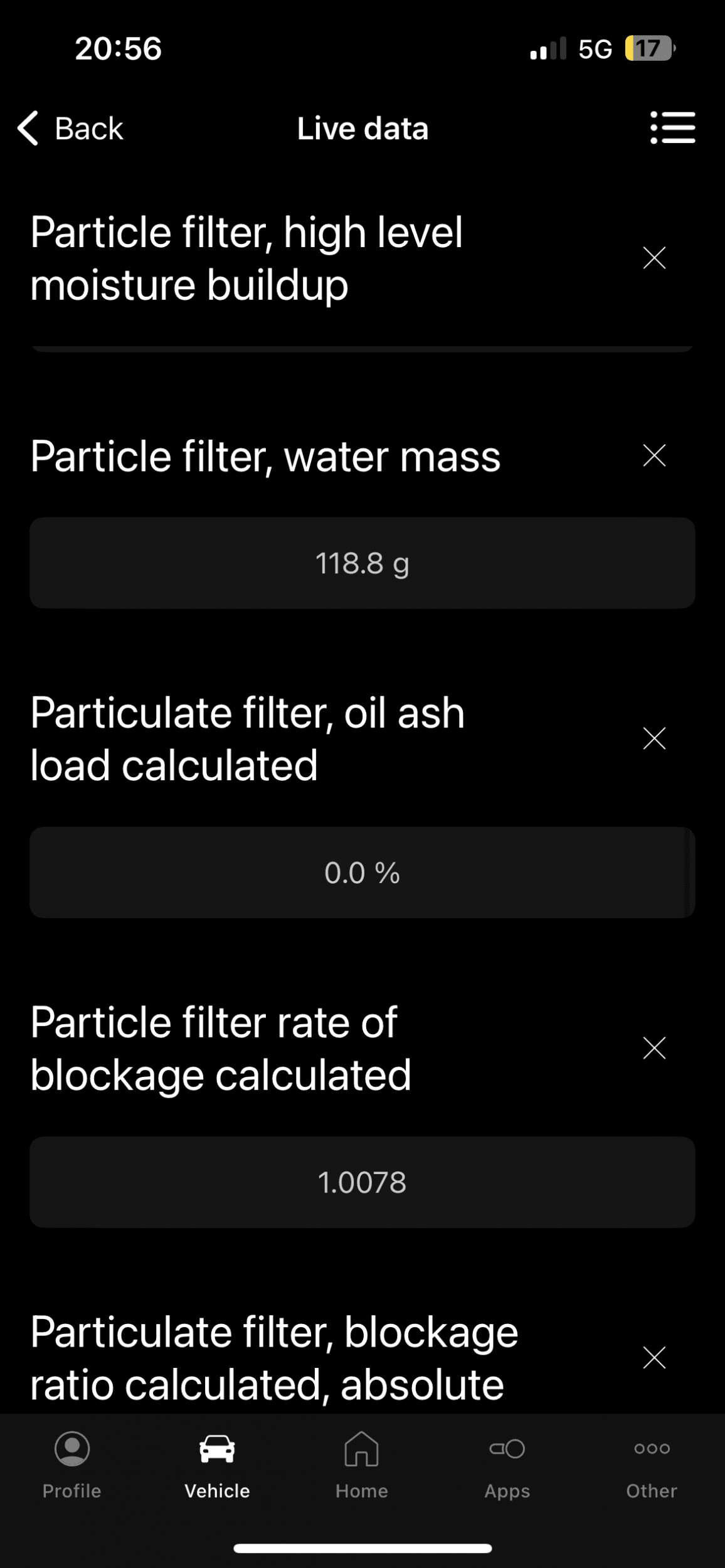

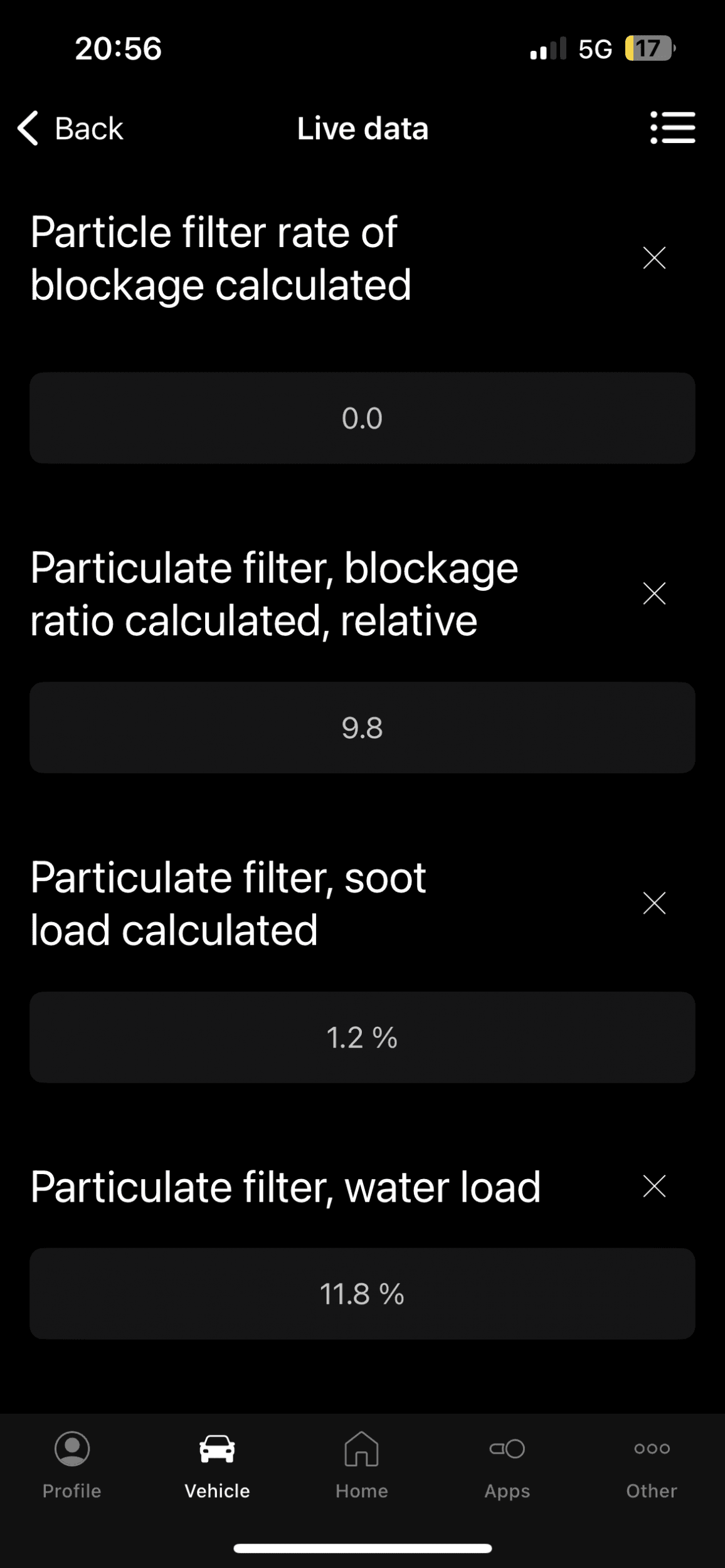

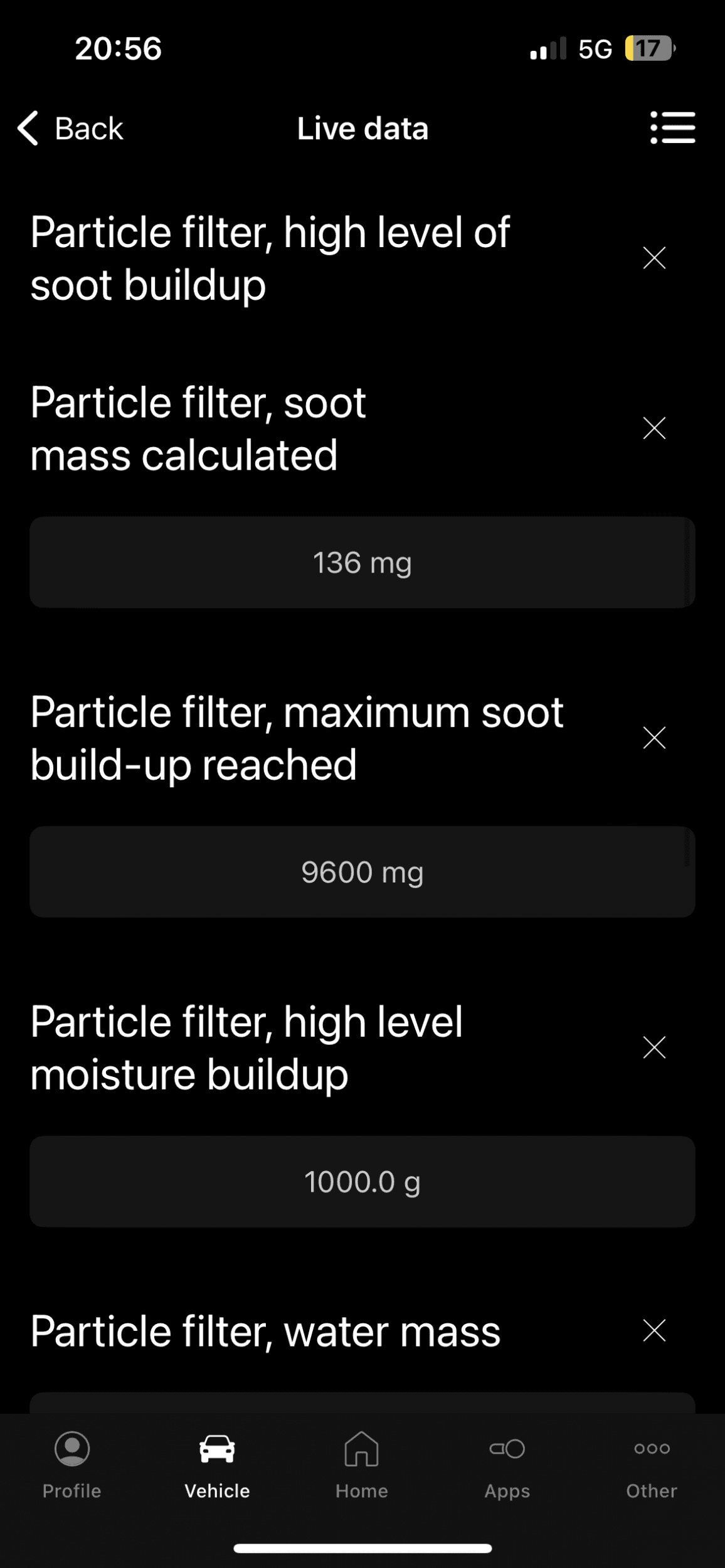

Took from screenshots last week from OBDeleven live data on engine block, after seeing this thread, not sure if it means much. Not exactly sure what I’m looking for and was taken shortly after starting car hadn’t driven it.
Been to a Main dealer about this fuel economy issue but seems they won’t investigate if they don’t see any fault codes which is annoying.
Definitely something wrong here what it is I don’t know.
also popped into the dealer today and apparently my fuel consumption again is normal. As my car is supposed to get 40MPG average.
So me getting sub 30 is okay.
