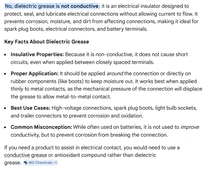

Not sure why people insist on putting dielectric grease on stuff like that :rolleyes: Glad you got it sorted
Reactions: SouthernSeat
Agreed:
