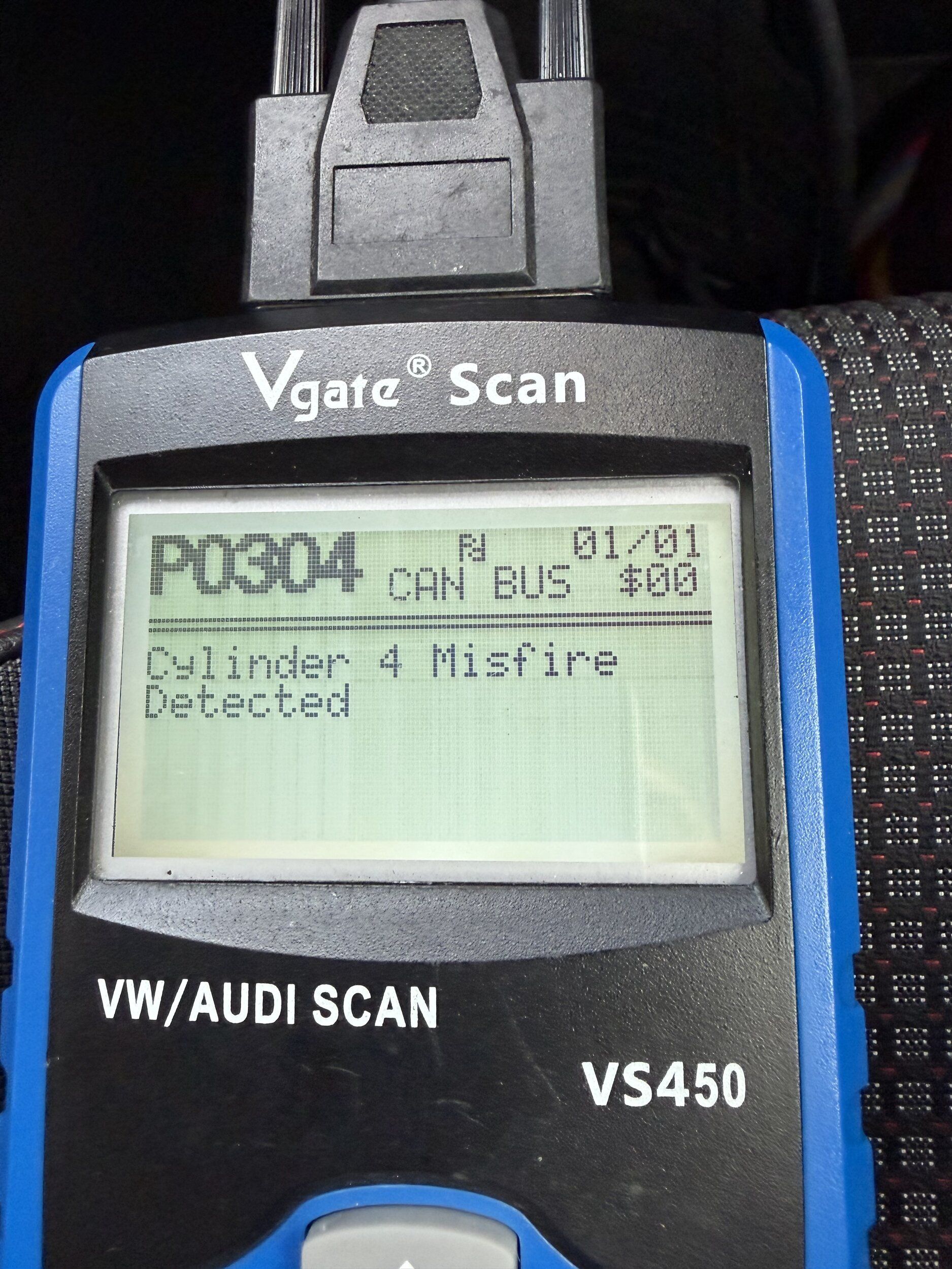

Hi all
My 2019 Dkza engined Leon has a funny problem, if I put it in D or Eco it drives fine slight hesitation under load but that might be the dsg . If I put it into sport and put my foot down, it seems to jerk on and off and the engine management light flashes briefly once or twice so I let off and out it back into D and no light appears.
Does this sound like coilpack? I will try and get someone to scan it before putting it into the garage to fix.
Thankyou
It’s come back with misfire in cylinder 4
I've just had to replace two coil packs on my 2019 DKZA.
If you're unsure, swap that coil pack to another cylinder and see if the fault moves.
