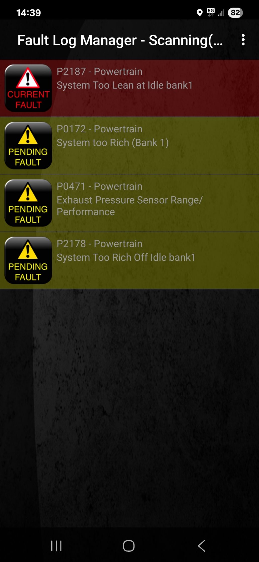

Hi all, returning owner here! My 3rd Seat Leon. Just had it delivered (used). Engine management light on the next day. Seller says there were no lights driving it down (150 miles) so unless they stopped around the corner and cleared the codes, it's rather unfortunate that they have popped up now. So it's either an easy fix or I need to get it back to them. The car doesn't have a MAF and I've checked for vacuum leaks - nothing obvious. I assume it uses MAP sensor/s only. The seller told me it had a new turbo and cam belt replaced before they sold it. The codes are contradicting, both lean and rich on idle. Then rich under load, plus the exhaust error. Any thoughts on the culprit? Thanks for any advice.

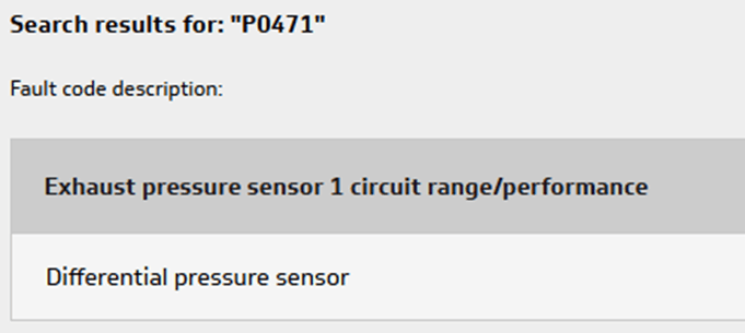

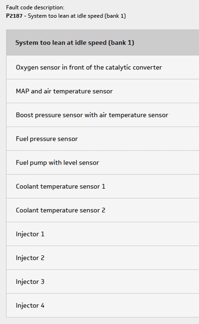

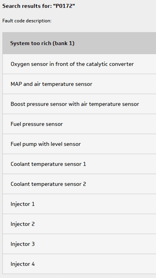

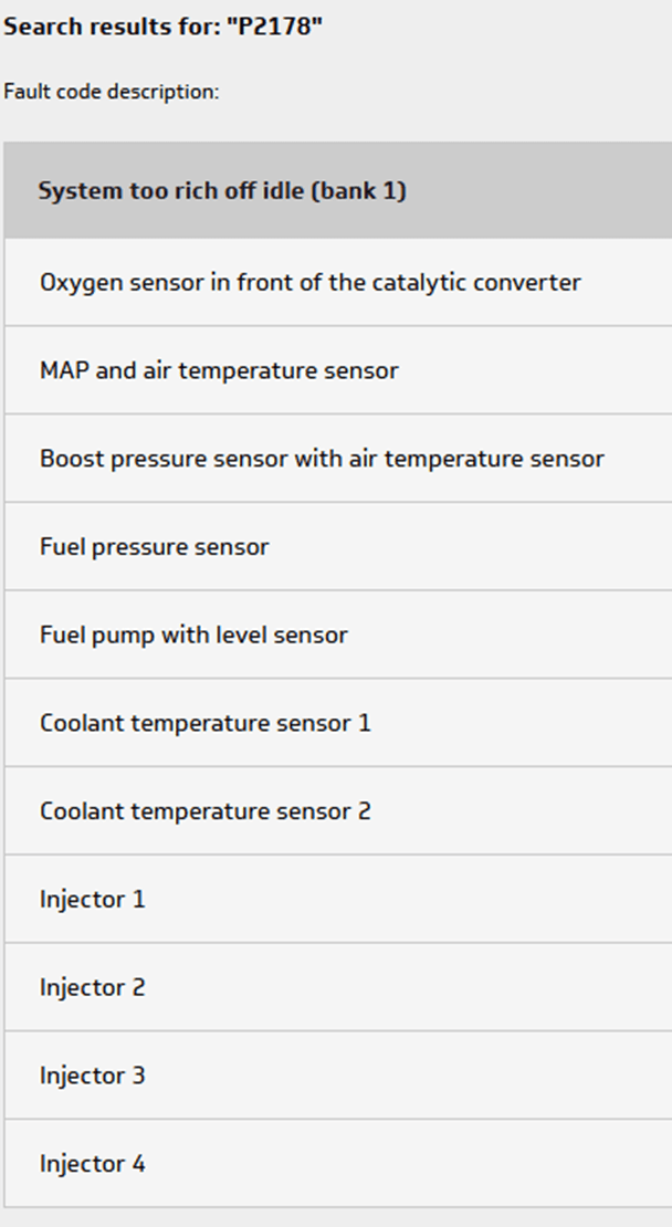

Searching for those codes I get these:
Was it a garage or private sale? If garage i'd be getting them to sort it!
Getting these codes after some major work was done it could be any number of things causing them!
Beyond checking that no connectors are loose/not connected after the turbo/belt job, If it was me and you can't return it to a garage - I would get it scanned with a dealer level tool to see if there is more data on what the exact fault is.
Thanks SuperV8. Is that a list of potential component issues under each fault? Yes was a garage but they are quite a way from here so was hoping to fix it myself unless it starts getting pricey. I'll see what the garage say. When I factor in fuel and train home and potentially having to go back and get it, it'll probably work out cheaper to take it to main dealer. Fortunately I did take out 18months extended warranty, but I think the first 3 months are with the garage...
I searched on my system for each of your 4x P... fault codes and it returned these lists of components which could be causing them below - so not detailed enough to just try parts roulette!

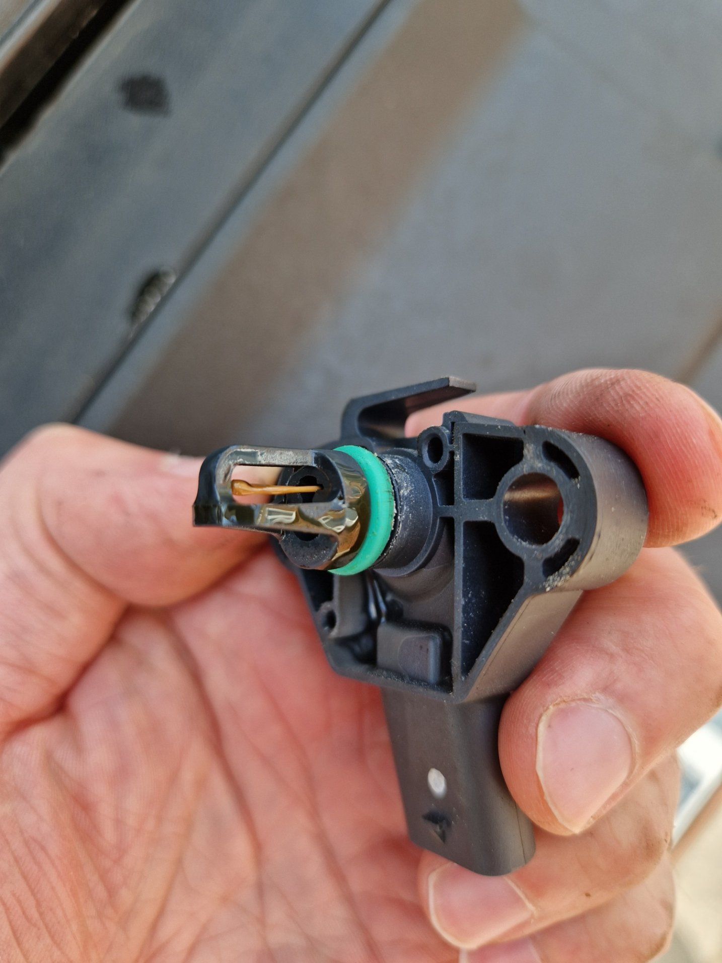

Spoke to the garage and they said take it somewhere local and send them the quote, so will give that a go. In the mean time, I popped the post throttle MAP sensor out, which was the easiest to get to (this model appears to have 2 map sensors, pre and post throttle, but no maf sensor) and it's covered in oil. Does the oil contamination in the picture look normal or no?

Doesn't look good to me.
Maybe you can pop some inlet hoses off 'after the turbo' - to see how bad the oil contamination is?

Hi, sorry for the delay. We sent the car back to the seller and they had it a month, just got it back a few days ago. Apparently, before they sold the car they fitted a new turbo, and it turns out there was a fault with the new turbo. They said they replaced it again as the new turbo was under warranty, and it does appear to have resolved the original error codes. I don't know if the oil on the map sensor was related, but just checked and the sensor is still clean.
Yes - if the turbo centre bearing housing seal is leaking, oil can get into your air inlet as witnesses my the oily sensor.
