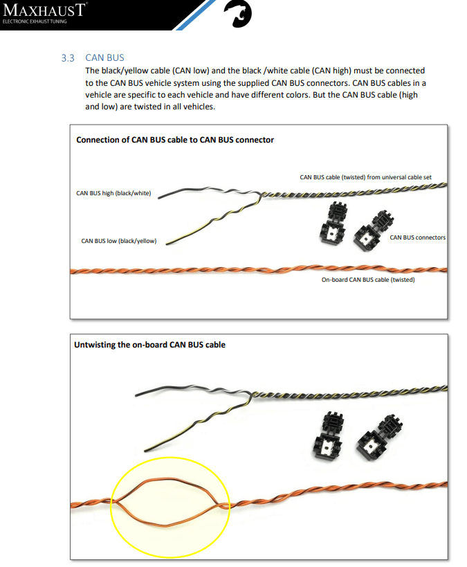

Hi, I bought an exhaust. Where can I find these wires where is can bus high/low
czarnyy Nov 25, 2021 1 0 Nov 25, 2021 #1 Hi, I bought an exhaust. Where can I find these wires where is can bus high/low
300bhpdaily Active Member May 26, 2020 1,246 568 Nov 27, 2021 #2 Take a look behind the headunit and find the wires that are twisted together. It won’t be hard to find as it will be the only wires twisted together.
