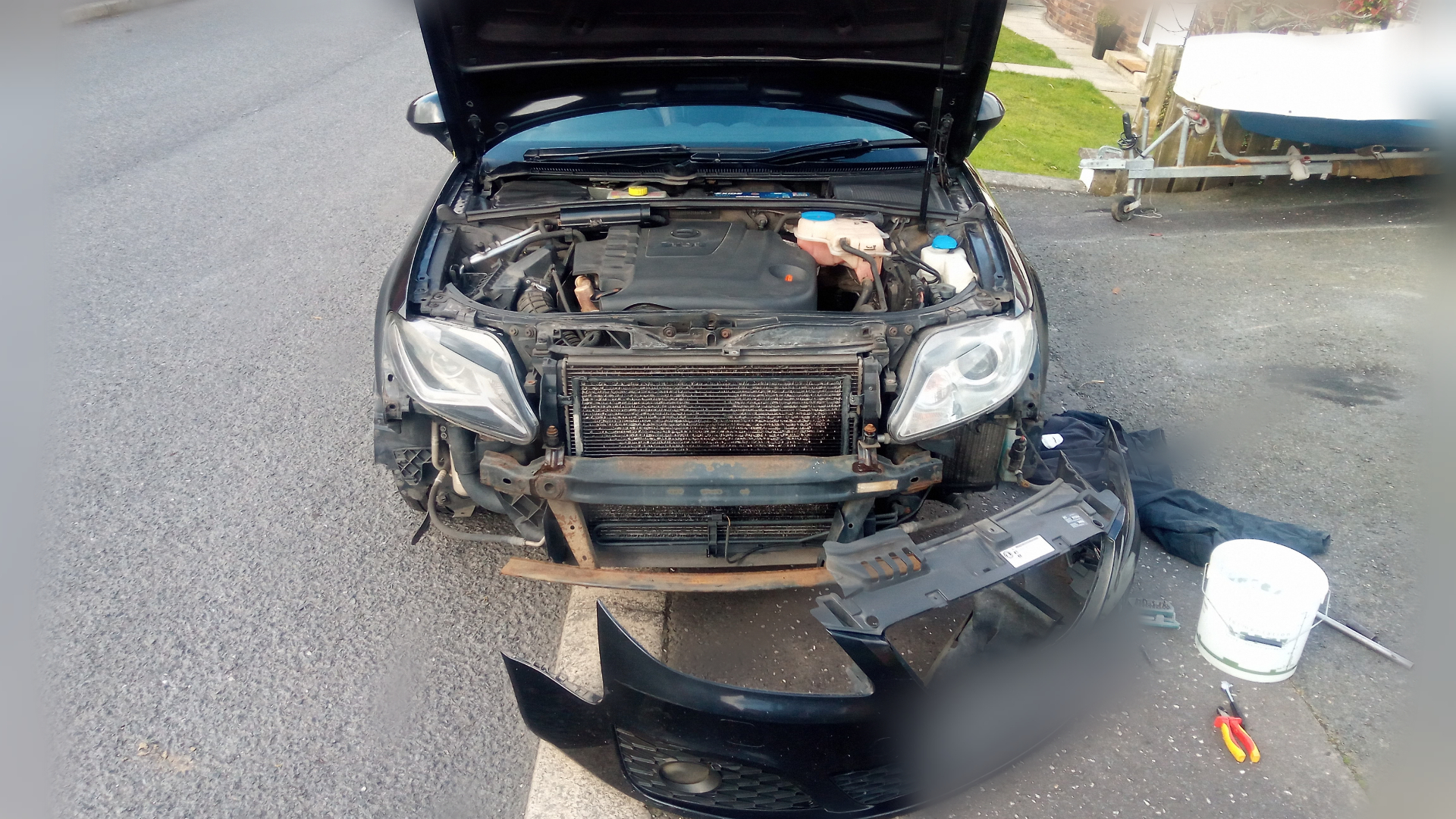

Fitted them today. Straight swap from the old bi xenon to the new. As you can see in the pic.
Now need to get the Led DRL working. The canbus just flashes up the DRL and parking lights are not working but there is no lighting the LED.
Anyone any ideas?
All other lights working 100%. Just the led strip isn't.

Hi folks. All sorted and working as of today. Got a new/used control module for the lights of eBay and fitted it. All canbus error have cleared and now led strips are working. Needs the CECM from a car that already had the lights with LED strip not only the bixenon lights.
