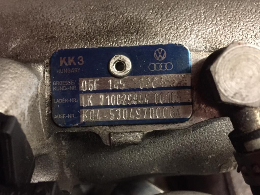

Does it have a triangle with kkk inside it or one big k on the casing anywhere, there should also be a metal plate rivited to the casing, with all the info about the turbo etched on to it! I'm no expert mate, far from it, and bill is greatly respected on this forum by everyone including me! But something just ain't right! I done a little research on this last night, there is alot of fake stuff out there, including people with genuine borg warner casings and fitting cheap poor fitting chra's! I'm not trying to be a stick in the mud here but I hate to see people being ripped off!
The info tag picture is on the first page mate, I will look for triangle with kkk or one big k and post pic if it there.
Yeah I kinda thought something wasn't right too hence the post.
But as you said bill is well respected and knows his stuff ,hopefully he might come up with a solution.
I have been doing some research too ,but cant find any easy way of identifying wether it real or not.

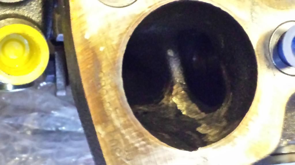

Hi Slim , yeah its got a triangle with a k in it and what looks like GGG next to it will post pics tomorrow .
That's on the hotside which Bill thinks looks genuine. As you said it doesn't mean the chra is real or the inlet.
Still wondering why there is machine marks on inside of hotside?
I Might need to send it to a rebuild company get them to check it out but thats money I could do without spending atm.

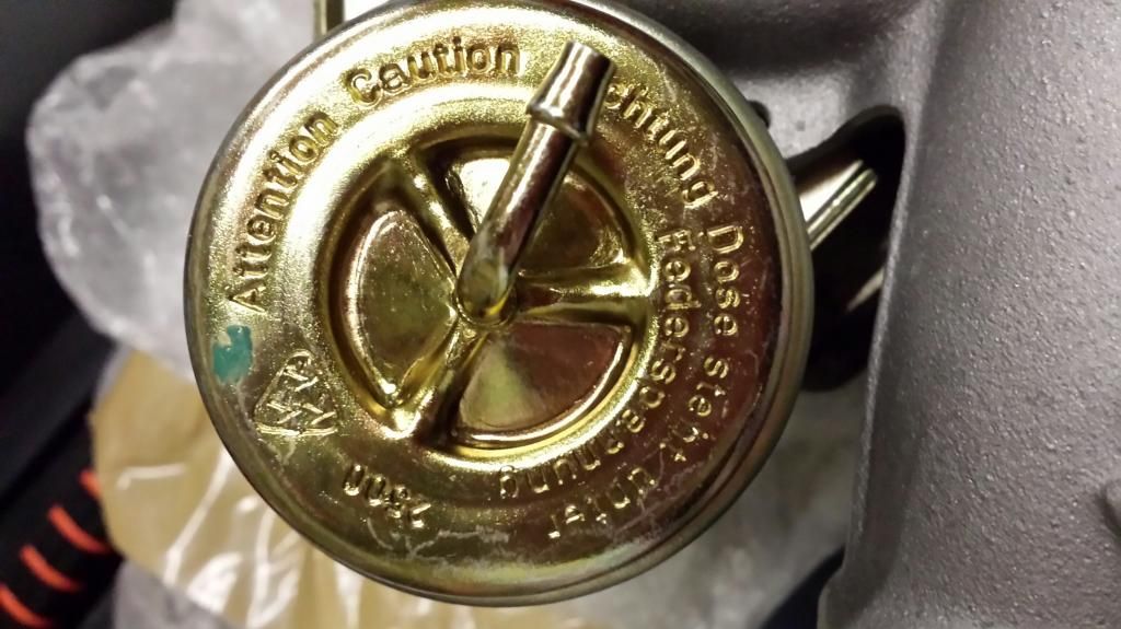

from asn forum a picture of a k04 off an actual car - a tfsi k04 btw no 1.8t
