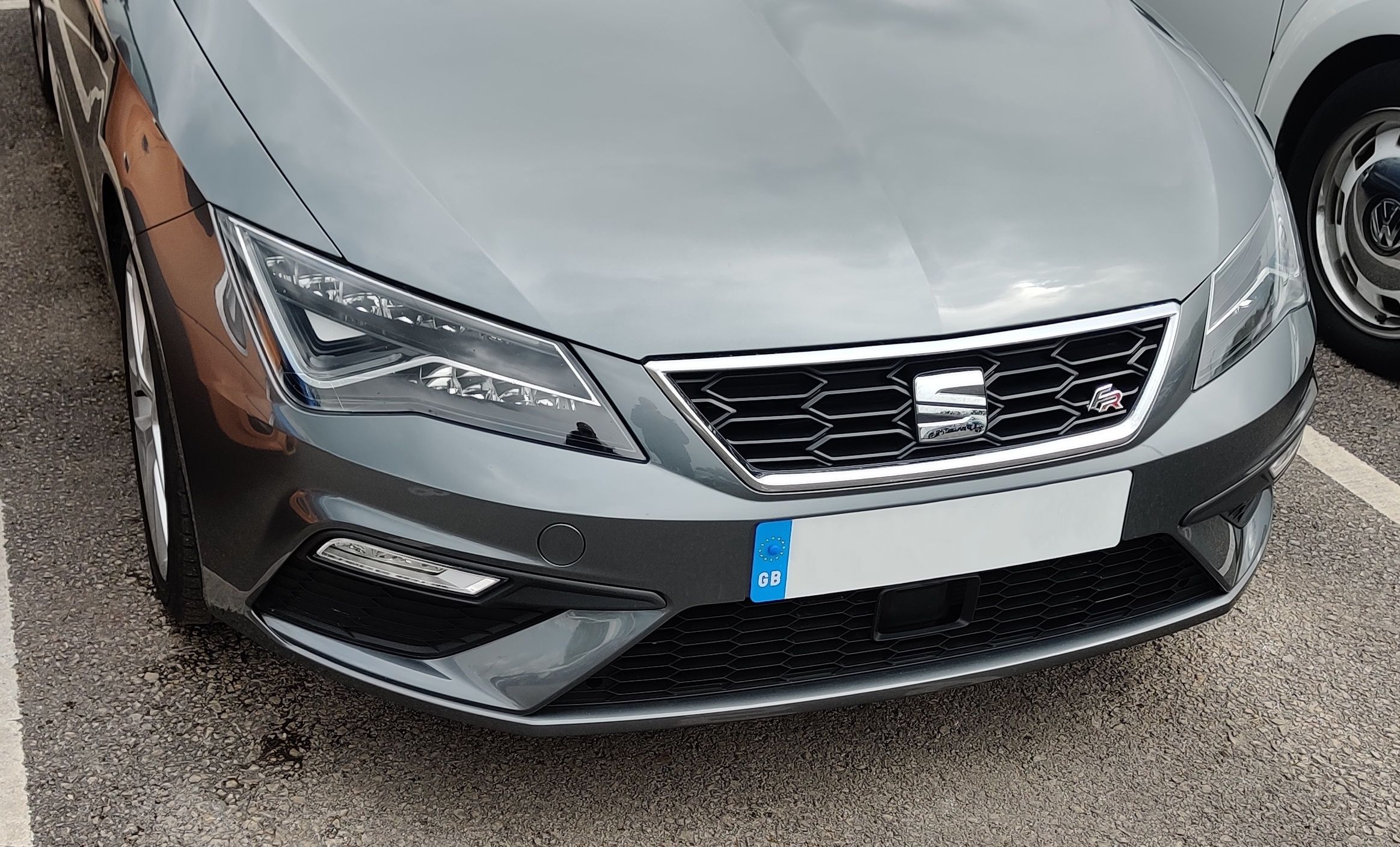

The FR ones are definitely solid. Dont think they're fake though - they obviously don't look like intakes, they're a fog light + solid insert

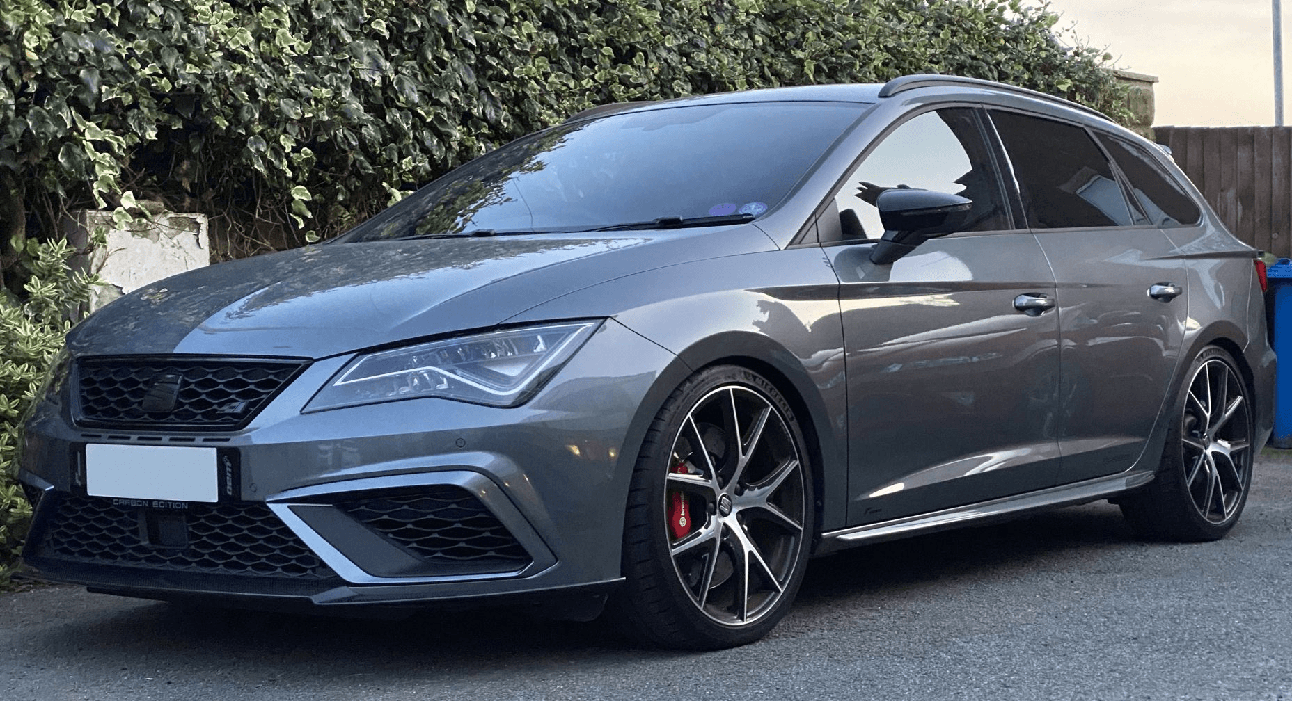

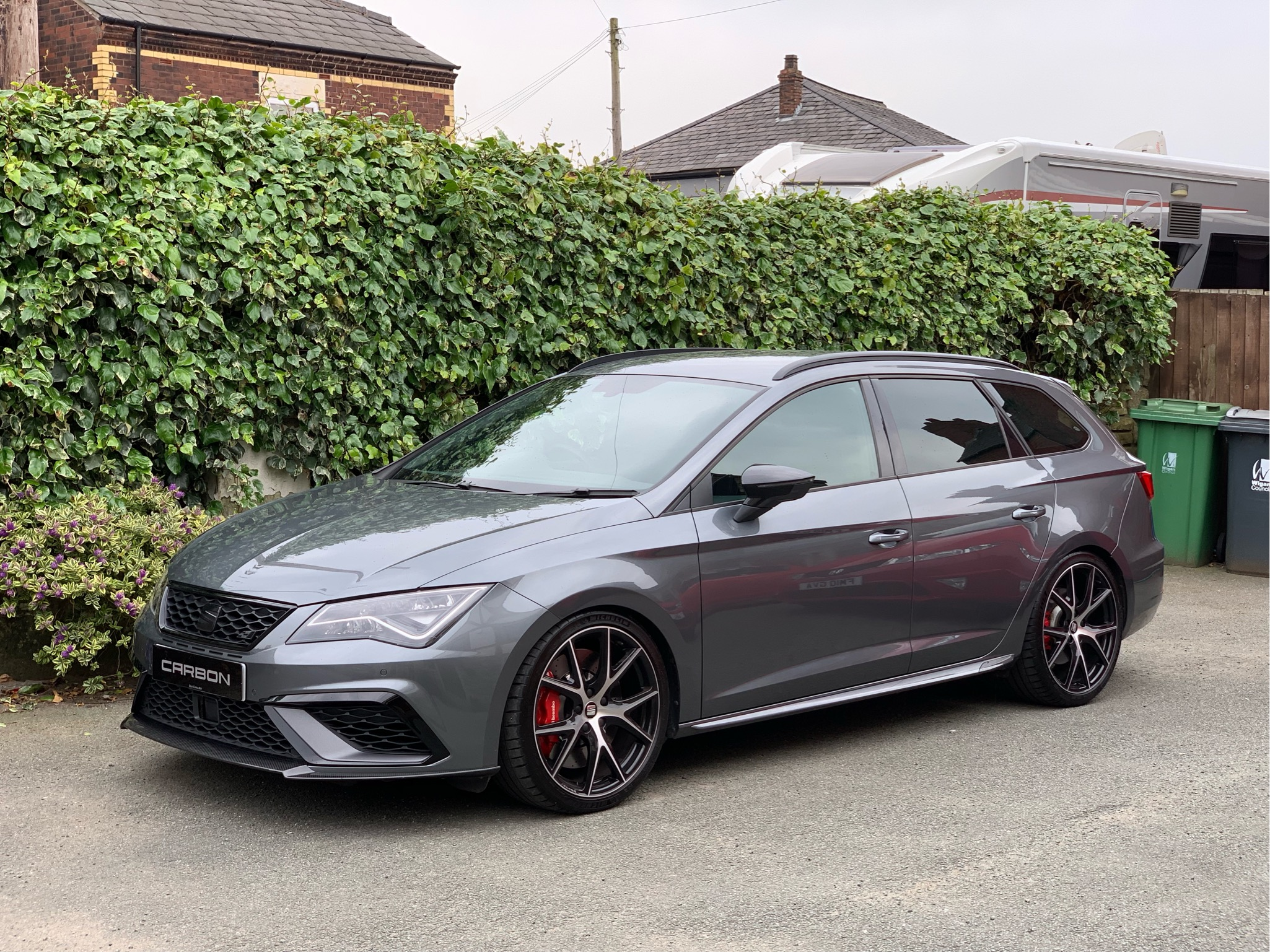

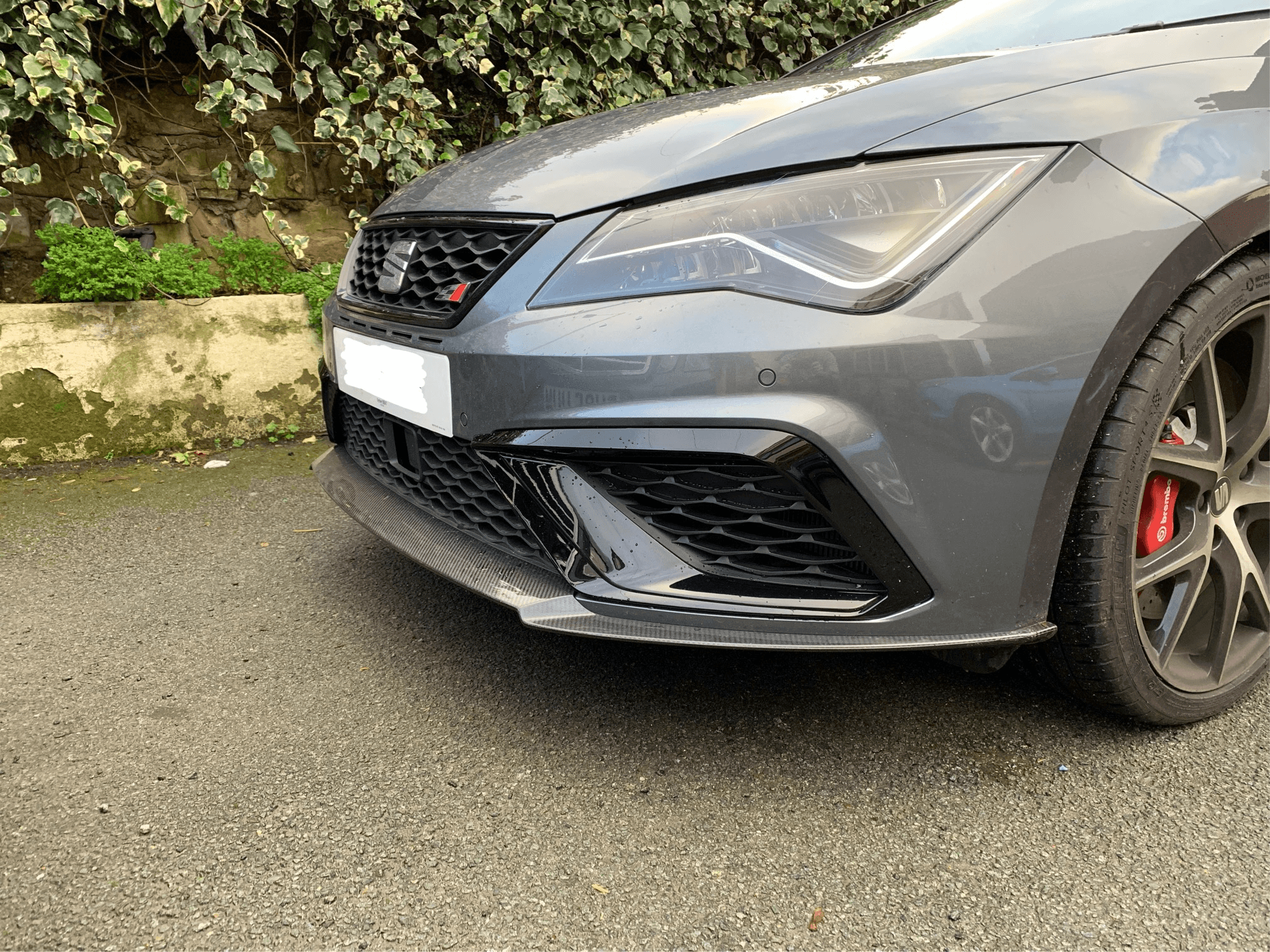

The Cupra R ones definitely look the best - as Damo says they match the main grill honeycomb style, and afaik they also actually stick out a little further than the standard inserts? The copper inserts look nice when they're body coloured too imo
Have to admit I've done a few versions, but my latest style is defo my favourite...
Black:
Matt Silver:
Matt Grey:
But then when they became widely available, as there was no longer a need to provide a VIN of a Cupra R, pictures of damaged parts etc. I decided I wanted something different to everyone else:
But the best bit is the fact the grills all match. My OCD is so much happier lol

Yours was actually the car I was thinking of! 😎
I'm definitely not imaging it am I, the duct edges stick further out from the bumper than the standard ones? They look more 'scoop' like to me than stock?
Mine for comparison, which are definitely solid but to my eyes don't look like ducts anyway;

If you're going for the Cupra R grills, then as you have the bumper off anyway to fit them (it is doable without but) I'd recommend doing all the grills to the Cupra ones so they match.
Some people may moan (not me) that you're making your car into a wannabe Cupra , but so long as your either de-badging or refitting an FR badge who cares. There are enough Cupra owners trying to make theirs look more like a Cupra R
