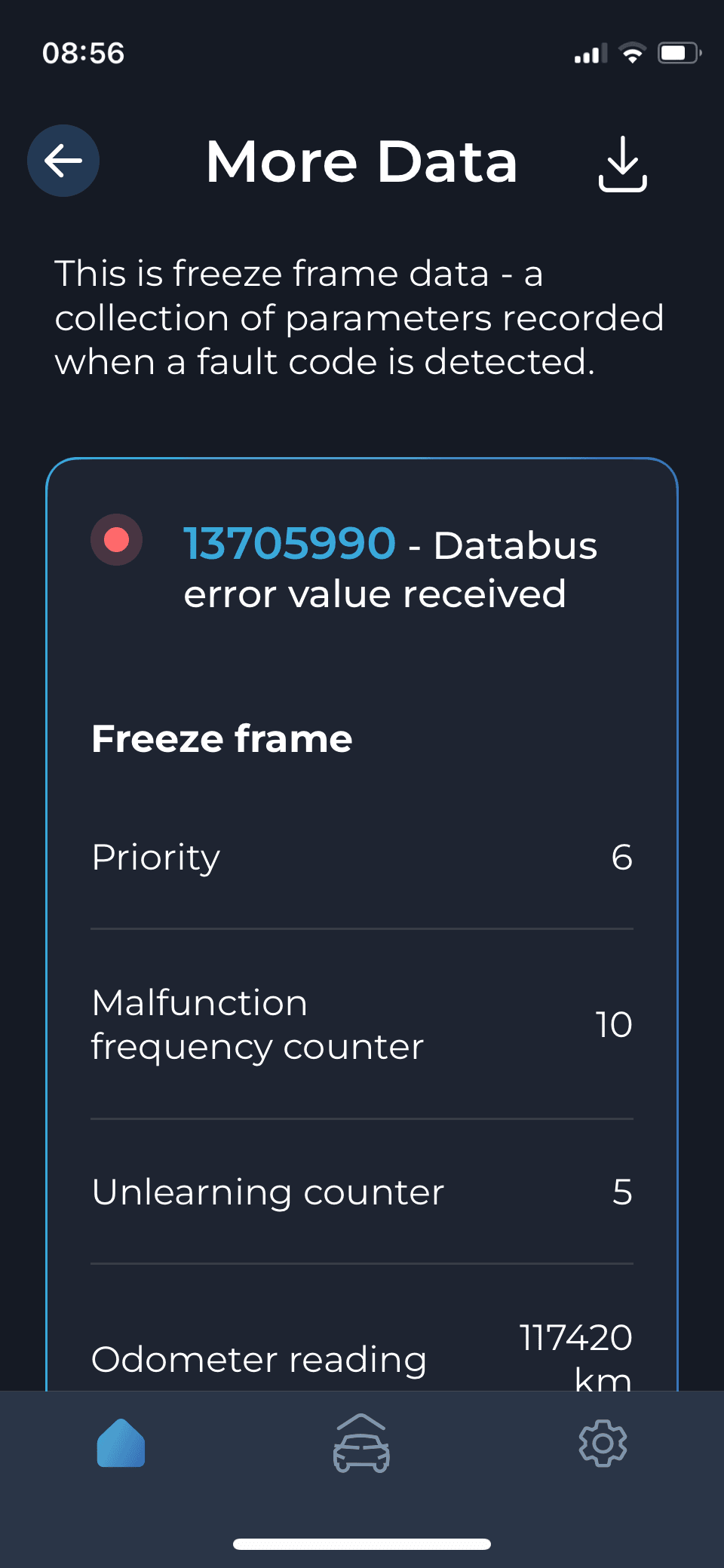

Hi can anyone help with a couple of faults that have appeared?
First is the headlight levelling sensor 13705990. have tried clearing it with Carista but it comes right back.

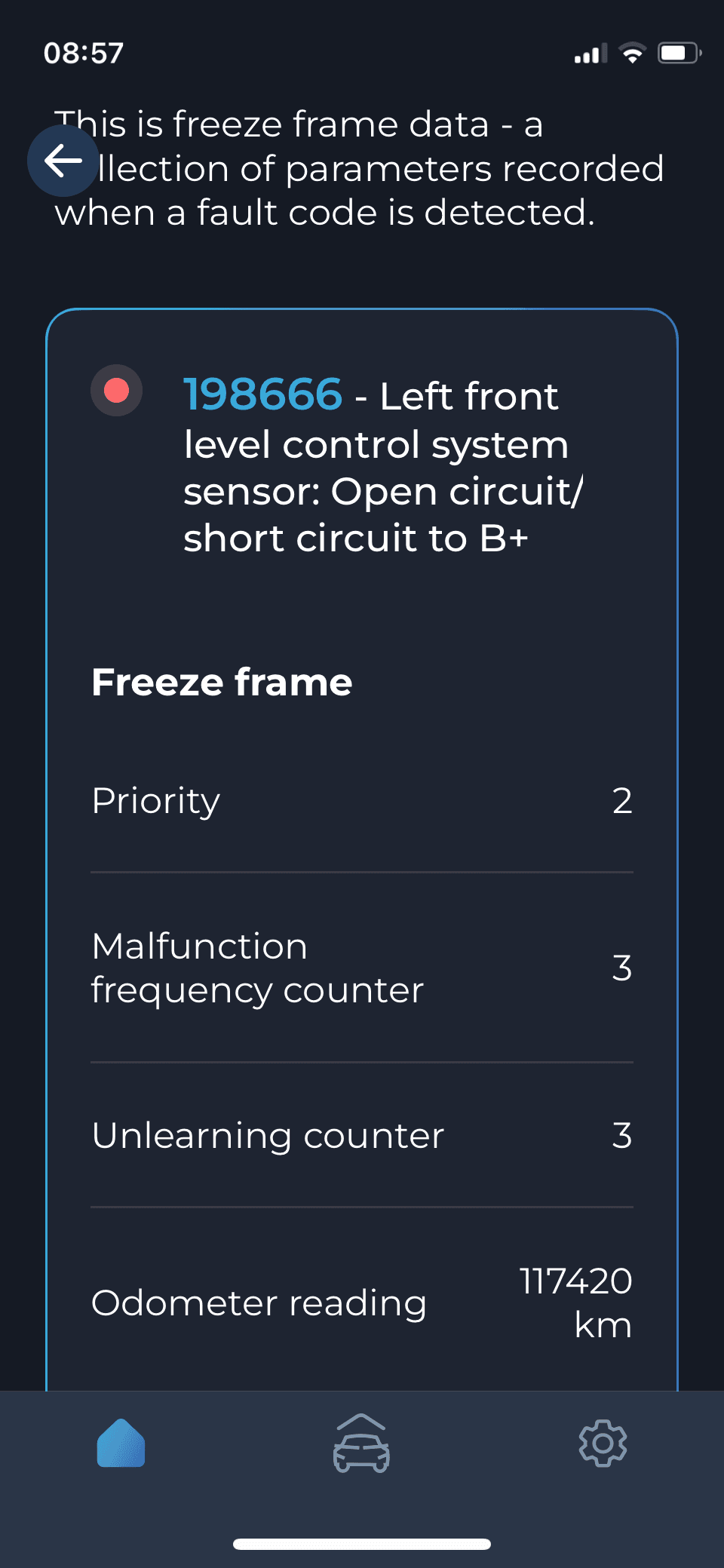

Second is front levelling sensor 198666?

Are these DIY fixes or dealer visit required ?

They may well be along the lines of these
note: they're handed (left & right)
Try terms like Front Left/Right Headlight Level Sensor For Audi Seat Skoda For VW Golf 7 VII Tiguan II 5NA FL FR
but first get under car and see if seized
Hi so are both these codes to do with headlamp levelling as the 198666 code is listed in Carista under suspension fault?
Also are these control devices difficult to replace by yourself (novice)
Very easy to change. You need to be able to take (front) wheel off so to jack up & support car safely (axle stands etc - and proper jack not that thing just about fit only for emergency changing of a wheel).
