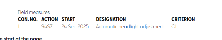

Hi everyone,
I logged on Erwin for an hour of access for some technical information about my car and incidentally saw that a field measure was entered for my VIN, just three days ago. It's a '25 Cupra Ateca TSI ACT 150 with a build date of October 27, 2024; but I believe most of the Atecas built around that date with different powertrains or trim levels might be affected by the same situation. It says "Automatic Headlight Adjustment" as you can see in the screenshot below, but there's no further information in Erwin, for an ordinary user like me at least. So I sent a message to Service Supervisor at my local dealer asking about it and she quickly got back with this: "Due to a wrong parameterisation in the automatic headlight adjustment control unit, an update is offered for affected cars". Now I'm pressuring her for a quick reservation to perform the update :)
Anyway, I might be the only one in my country who calls the dealer and tells them there's a field measure; they probably wouldn't be calling anybody for that and it would be performed only if there's a complaint that might be related. So I advise that everyone should be asking the dealer for field measures from time to time, or better purchase a one-hour access to Erwin and check by yourselves.
Cheers,
Serdar

An update on the subject:
Dealer now says it's not just an update for headlight range control unit (by the way, there's no control unit with that name in '25 Ateca, I believe they mean 4B - Multifunction Module), it is a "base line update" that involves a lot of control units. Not sure that's the correct action for field measure 94S7 that I saw in Erwin, because I don't trust the knowledge of tech guys in the dealer and their care for things like this. I remember them trying to install a genuine accessory RVC in my '18 Leon without success and I had to intervene and lead them to correct path in ODIS.

A baseline update basically means that a software update suite is required. The update suite involves updating all applicable control modules so they are of an equal version.
VWG started to use PV (product version) update suites early last year. They apply to anything using the 2024 onwards vehicle infrastructure.
You might of seen the term "PV2..." or "PV4" mentioned across forums before, that's what it refers to.

Hi @James_R , I have just one more specific question regarding the content of a baseline update.
As I said, Erwin does not provide further information on a field measure to an ordinary user like me, I have just the code and a short description of some "Headlight Adjustment". I made an inquiry to my local dealer and they told me that it's not just headlights but a baseline update.
What I wonder is whether the dealer is able to see which control units would be updated when that baseline update is applied, via Erwin, ODIS or any other software they use, or is it just a case of starting the update without knowing what it would really do.
Of course I could ask the same question directly to the dealer but I suspect that they would probably say "no we can't" to brush me off.
Any insight on this would be greatly appreciated.

Once the update starts, ODIS will read and compare the software levels of each control unit from the vehicle with those on the VWG central server. It will then show a list of any out of date software that is to be updated.
