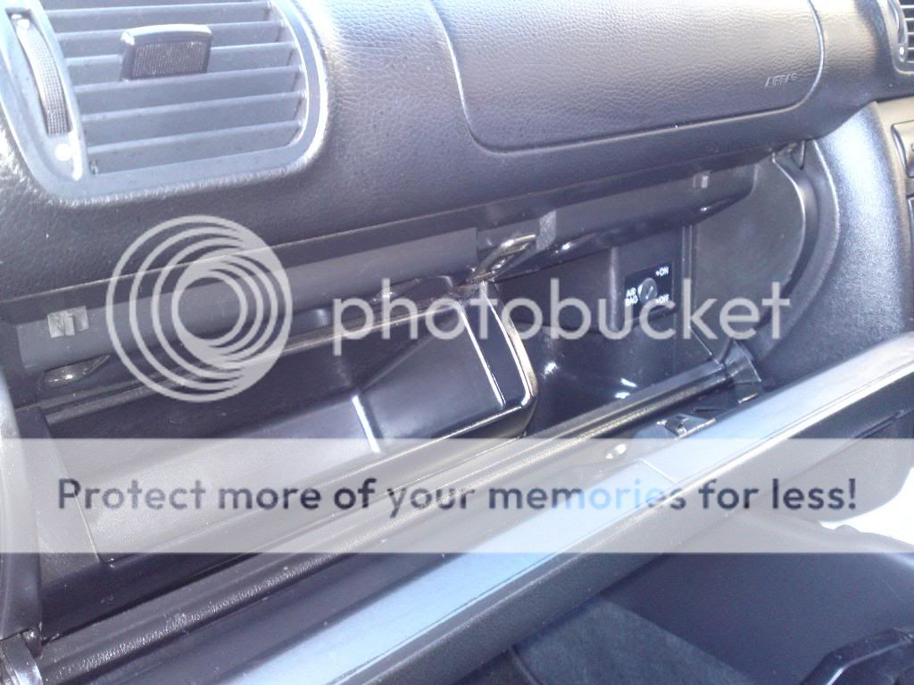

Cupra R glovebox fitted pics included
Fitted my Black Cupra R glovebox today, My old one was grey.Easy to do and lock from old one changed too. £20 from a bloke who was breaking his and included the tray insert from the 6 disc changer. BARGAIN!!!!
Before.
[/IMG]
After
I have read a few people have had problems changing the lock.
This is what I did.
1. Remove Glovebox.
2. Open the glovebox and you will find four screws at the back of the handle/ lock.
3. Remove these and gently prise away the unit.
4. at the side of the handle gentle prise away the retaining lips.
5. Lift back the 4 plastic "fingers" holding the lock in place and push the lock out.nb. which direction the lip is on the back of the lock so the "old" lock goes in the same way.
6. Replace the "old" lock into the handle and fit in reverse.
Job done. Sit back and gloat.
