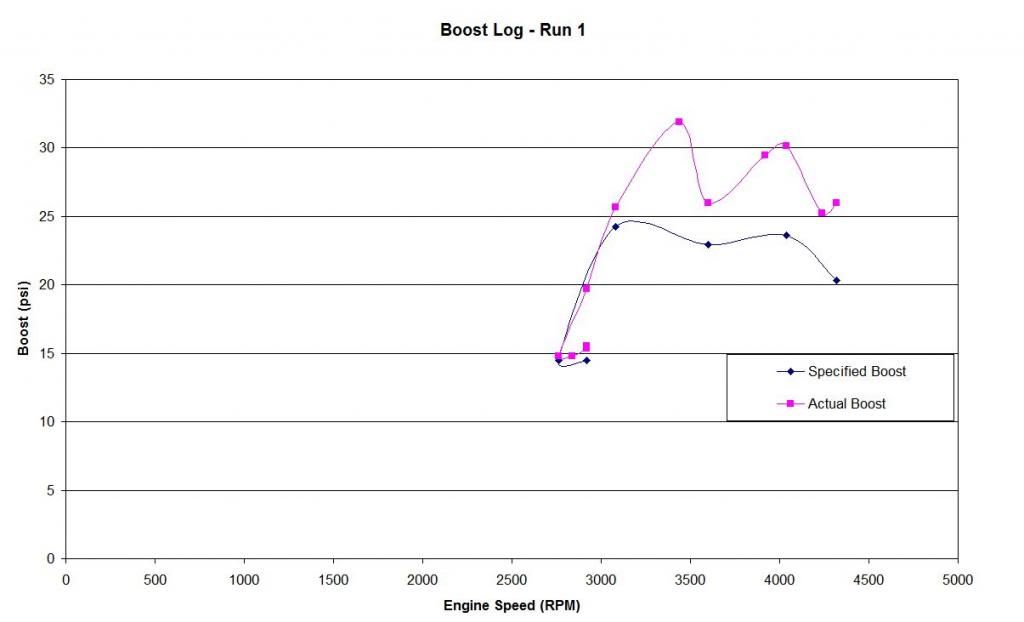

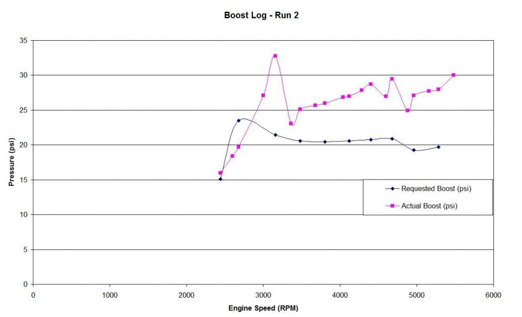

I did measuring blocks 115, 118 and 002 so I have data on the airflow and N75 cycle too but I have only graphed the boost just now. I did two runs, both in 3rd gear, the first was at WOT, the second at like half to 3/4 throttle. Heres the graphs anyway... No idea if these are any good, I will be doing some more logs tomorrow.
As you can see the error code is right enough, it is well overboosting. The requested boost looks fine (I think) for a standard AUQ 180 at 6 - 7 psi, I thought if anything it should be slightly higher than that. However it is spikes at around 18 on both runs then fluctuates, the fluctuations are accompanied by hearing the DV dump boost. The N75 duty (whatever that means) doesnt seem to do much, on run 1 it goes to 2% at the point the requested boost peaks and on run 2 it goes to 76.9% at the point the requested boost peaks but is at 0 the rest of the time.
So, what the hells going on then?!
Could the MAP sensor be faulty? I find it hard to believe its producing that levels of boost, is the MAP sensor before or after the DV? I seem to be getting a constant hiss coming from the DV even at small amounts of throttle then a large whoosh when it properly dumps boost.
If anyone has any ideas or has a better suggestion for things to log then fire away I'll be doing some more logs tomorrow.

Not to sure as i have a pd150......but can you change the spring in the dv? Has it got the uprated spring or standard? Could you try the standard dv to eliminate dv issues?
It has the standard (green I think) spring in it just now. I was going to try that but the car did this with the standard DV too, the reason I put the 008 in was to try and cure this.

No idea on the overboosting issues, surprised its not thrown the car into limp. N75 been connected wrong? reading threads on Vortex its either N75 or actuator, make sure the vac line is sound. Its what ive read more than know.
Can you not convert the graphs into the usual VC logs?
The temp sensor is the internal one to do with the aircon though, wouldnt have thought it does anything other than tell the aircon unit what the interior temp is? Yeah surprised it isnt going into limp mode too.
Do you mean the vac line to the actuator? Where does it come and go from?
No idea what you mean about usual vagcom logs lol, i just opened the log file in excel and graphed the bits I wanted.
