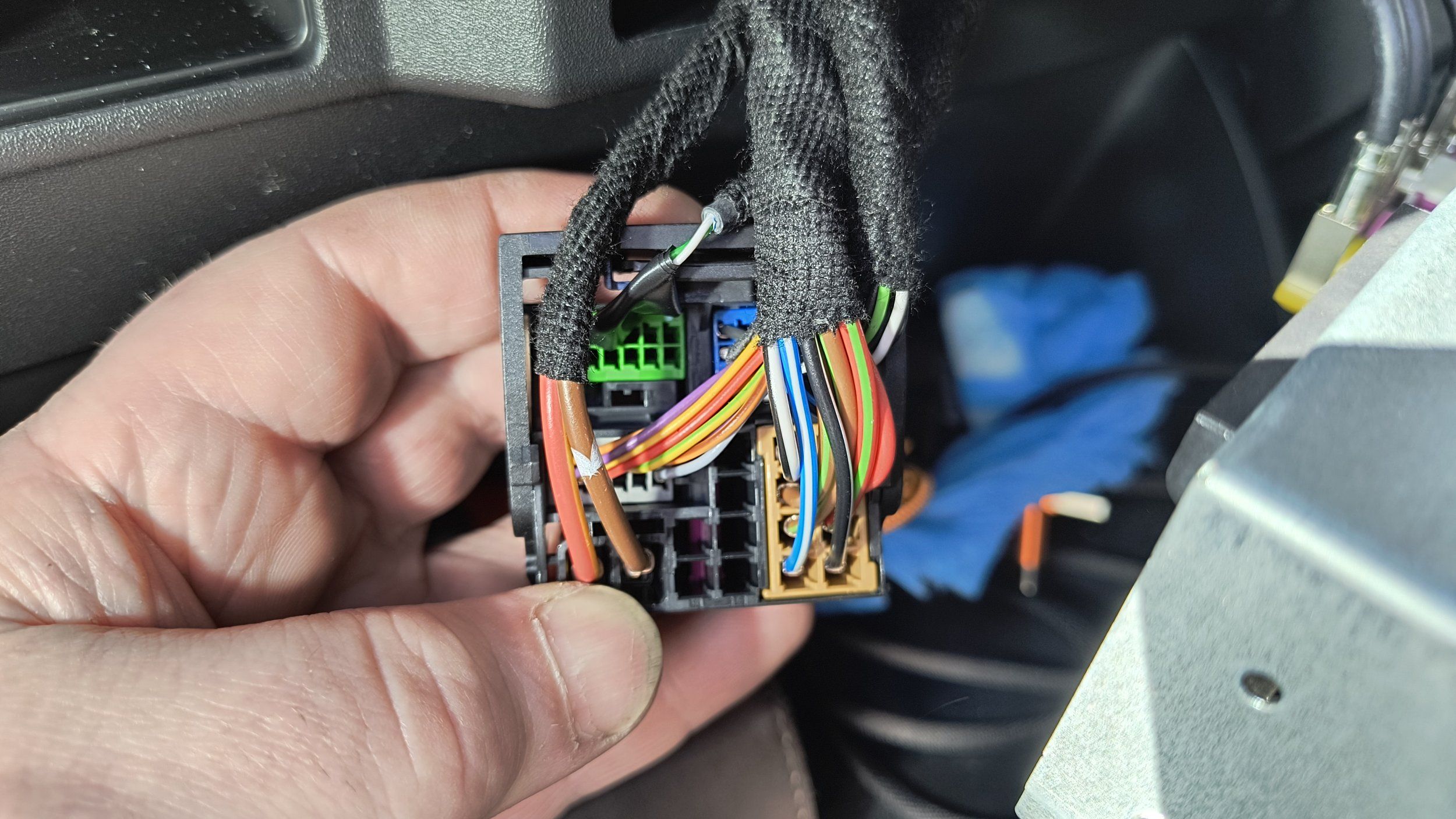

Hello all,
Can anyone tell me which block to come off of in order to run audio to a separate amp and woofer system(going in the boot) please?, I would like to come off of the speakers but no sure which is which. I think the grey block is the speakers but not sure as it might be the tweeters or something else.
Thank you in advance.
this should help, but don't cut the wires you can buy adapter cables that sit in the middle of the cars harness and the MIB box in the glove box you can cut the adapter wiring to add the sub then and you can keep the car harness stock - sections labelled RL/FL/FR/RR are speaker wires
Can you advise where to buy the adaptor cables from, I had a look but I'm not sure what they are called or where I could get them from and don't want to buy the wire kit.
