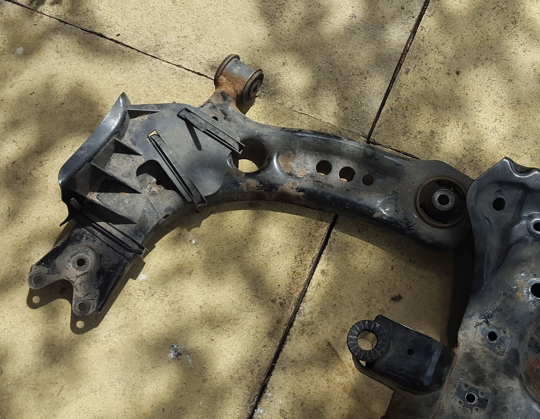

And final update on this thread from me, I have taken off the front arms and replaced them but below is a picture of the old arms with the ducts attached so its easier to see in position.

Well that was £30-00 waisted, I bought new ducts as I have fitted the super pro alloy arms
According to the web site you have to order different ducts, I spoke with them on the phone and emailed to confirm I wanted the modified ones.
The response was that the stock ones would fit but they did not realise they needed to be adapted.
So today I fitted one side and with a small amount of plastic being removed off one of the tabs they fitted fine, so the old ones will now be going on EBAY to get some of the cash back :)
