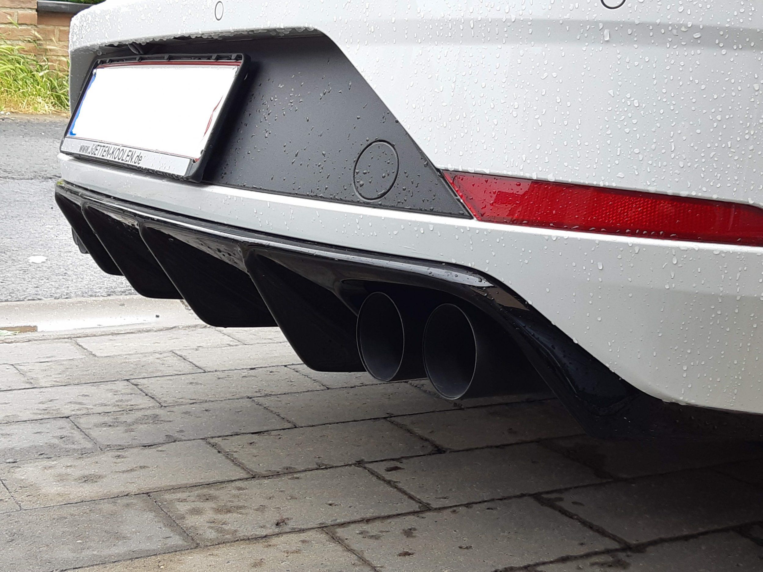

I choosed the 2x2 from Remus. But they came in shiny chrome which I didn't like so I painted mat balck.
With the original diffuser :
With rieger diffuser :
Sh1no
Aug 27, 2020
17
Nice result (y)
No peeling for the moment?
I heard that results are sometimes disappointing because the coating is not lasting as long as it should (even with high temp coats because of the condensated exhaust gaz acidity)

Pierre Goffin
Nov 22, 2019
15
Nice result (y)
Do you have the same resonance in normal mode between 2500 & 3000?
Thanks !
No peeling yet but some small gravel impacts (tips are quite exposed to it), the exhaust already did 10 000km
