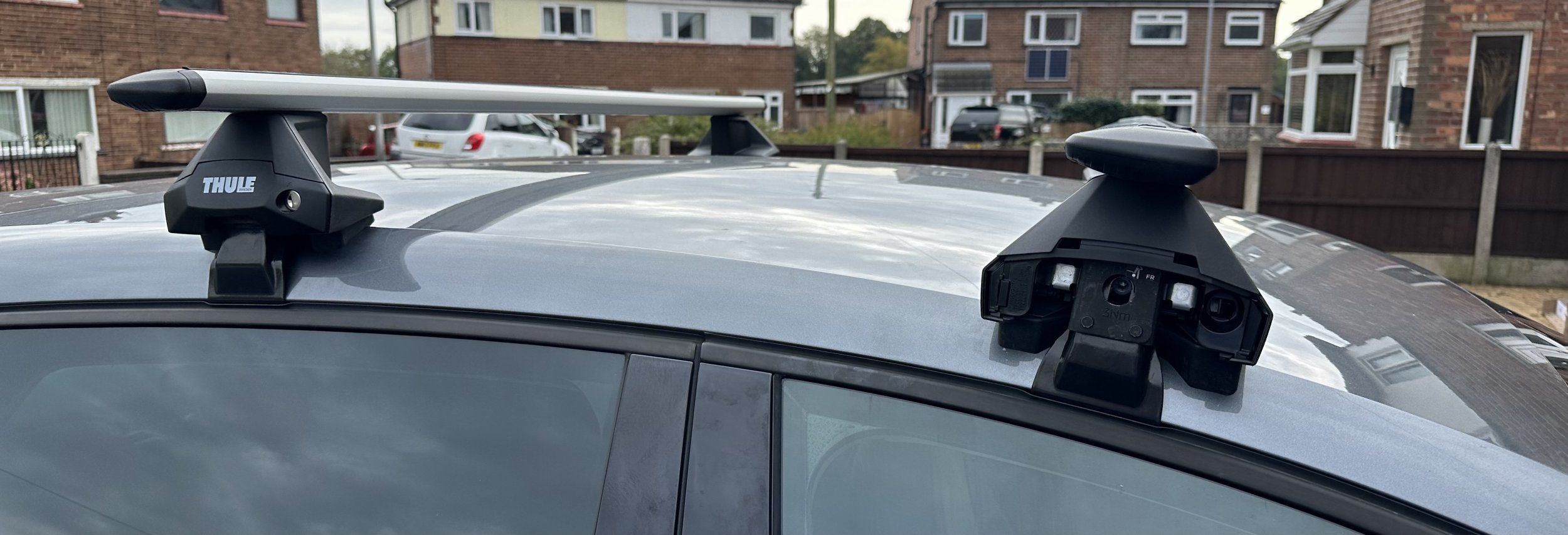

Hi I’ve purchased some roof bars the Thule wing bar Evos for my mk3 5door Leon.
the problem is I can’t seem to get the front to sit right looks like it’s sat tilting forwards and closer to the roof than the rear bar.
Has anyone else fitted the same system is this correct. Struggled to get the pads to sit right on the roof like the measurements were off double checked the instructions. And I had them all set right.
Can't see clearly but any chance the front/rear feet are mixed up ?
I would have expected the wider foot/clamp to be the rear bar.
