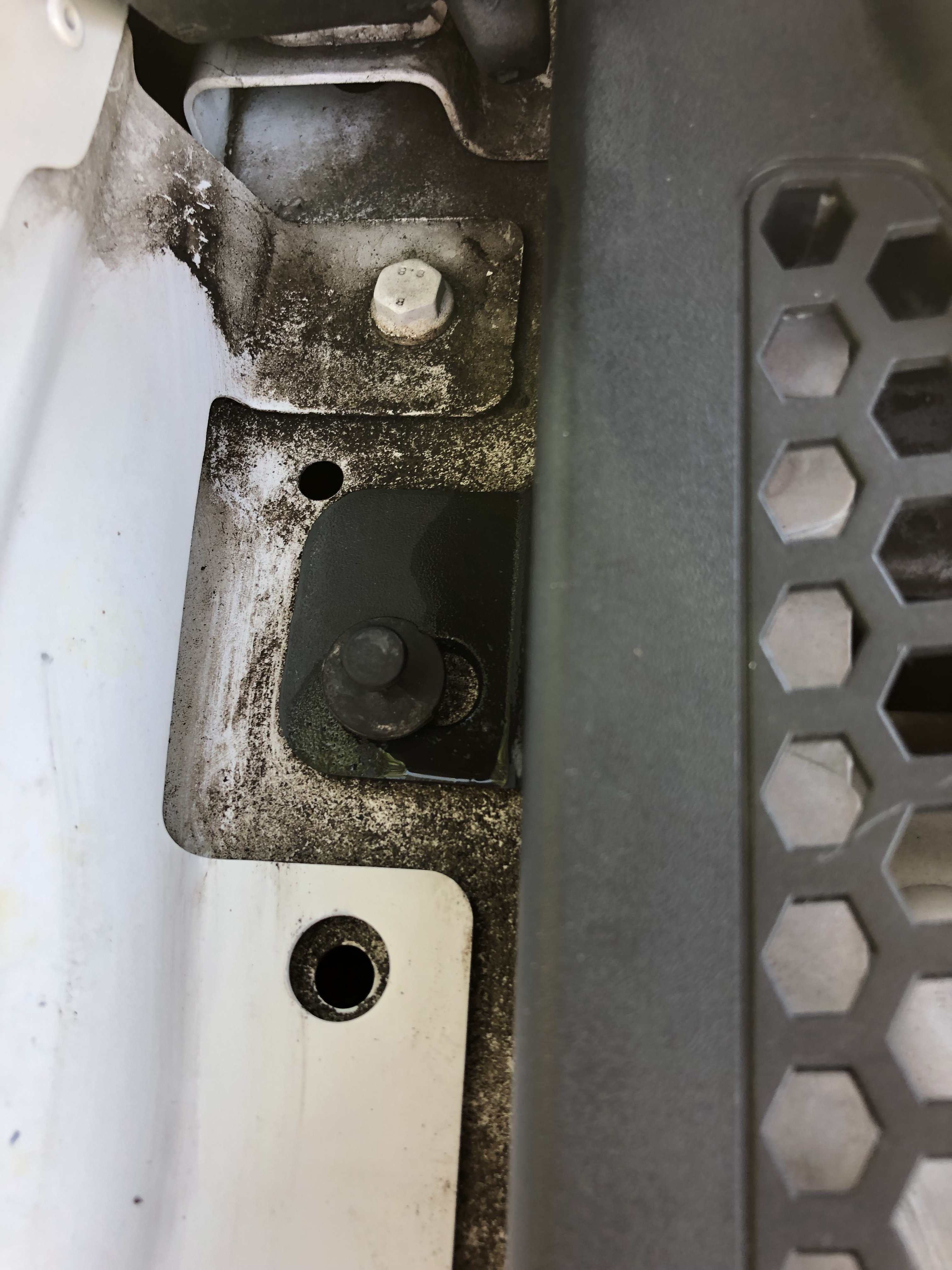

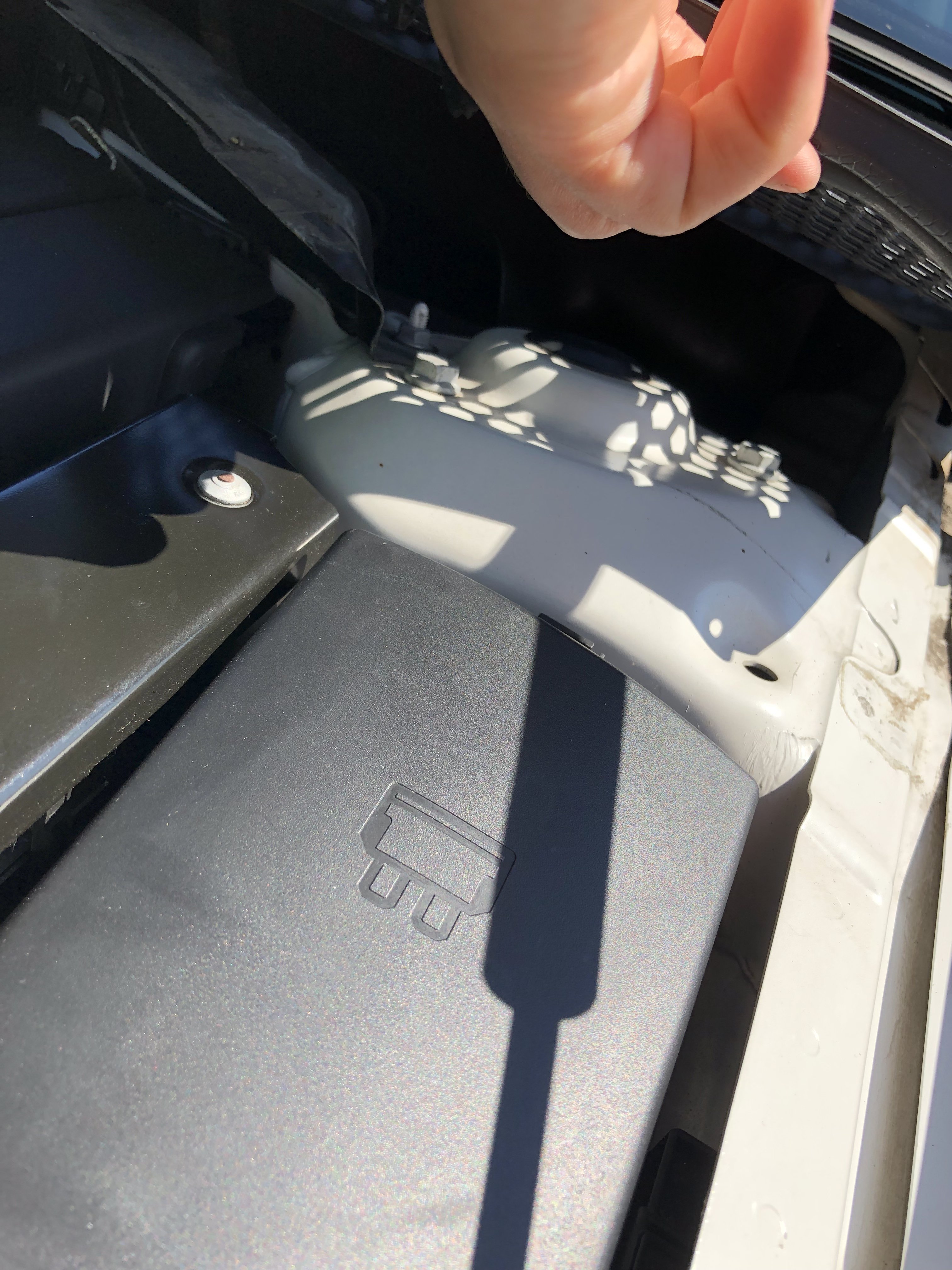

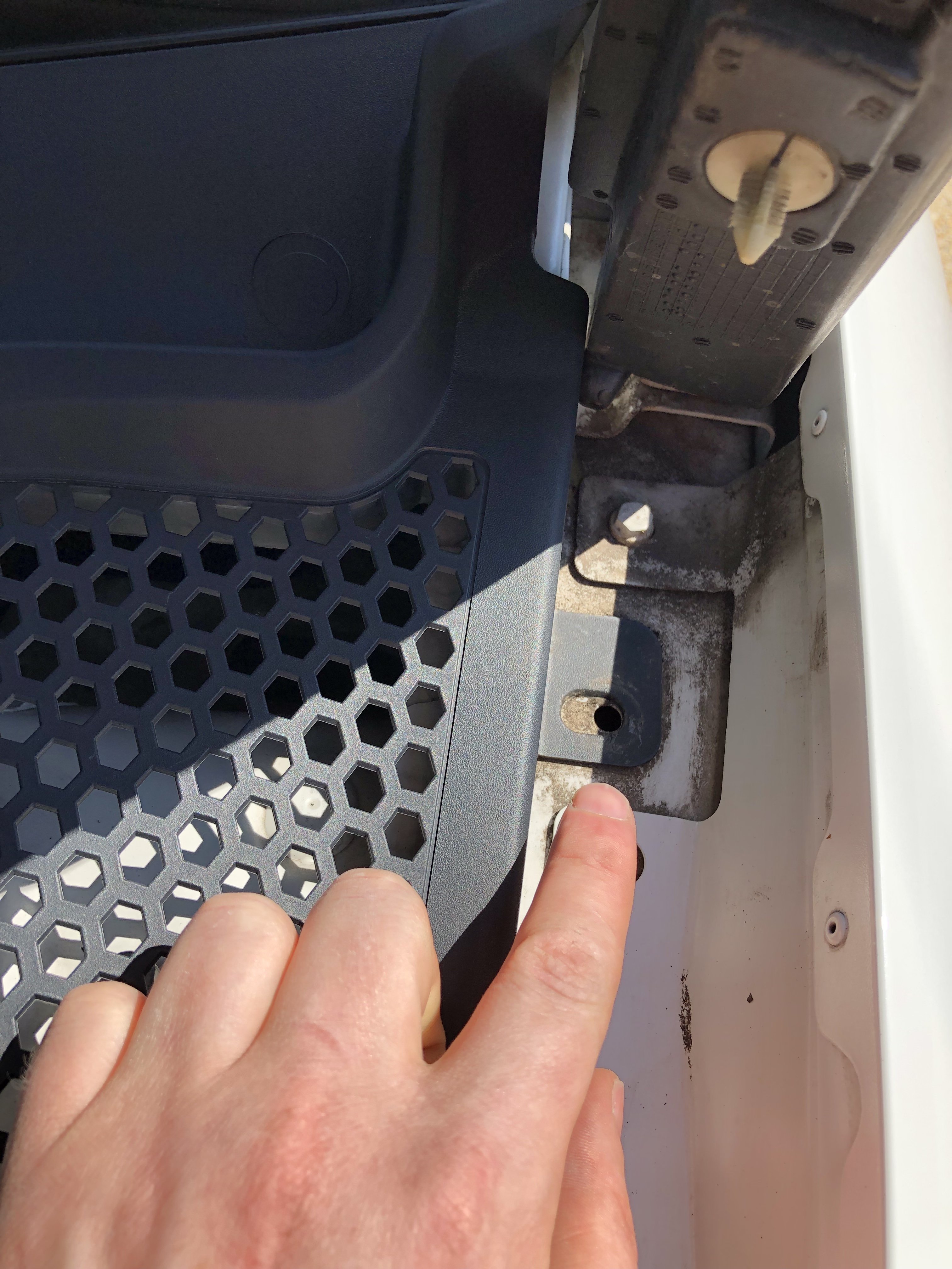

I find out If remove the corner clip on the scuttle tray it gives you even more room for ratchets without risk of damaging the tray.

Cheers for the guide , got mine in the same batch and fitted with help from your guide .
Nice find, didn't even notice those were there!
