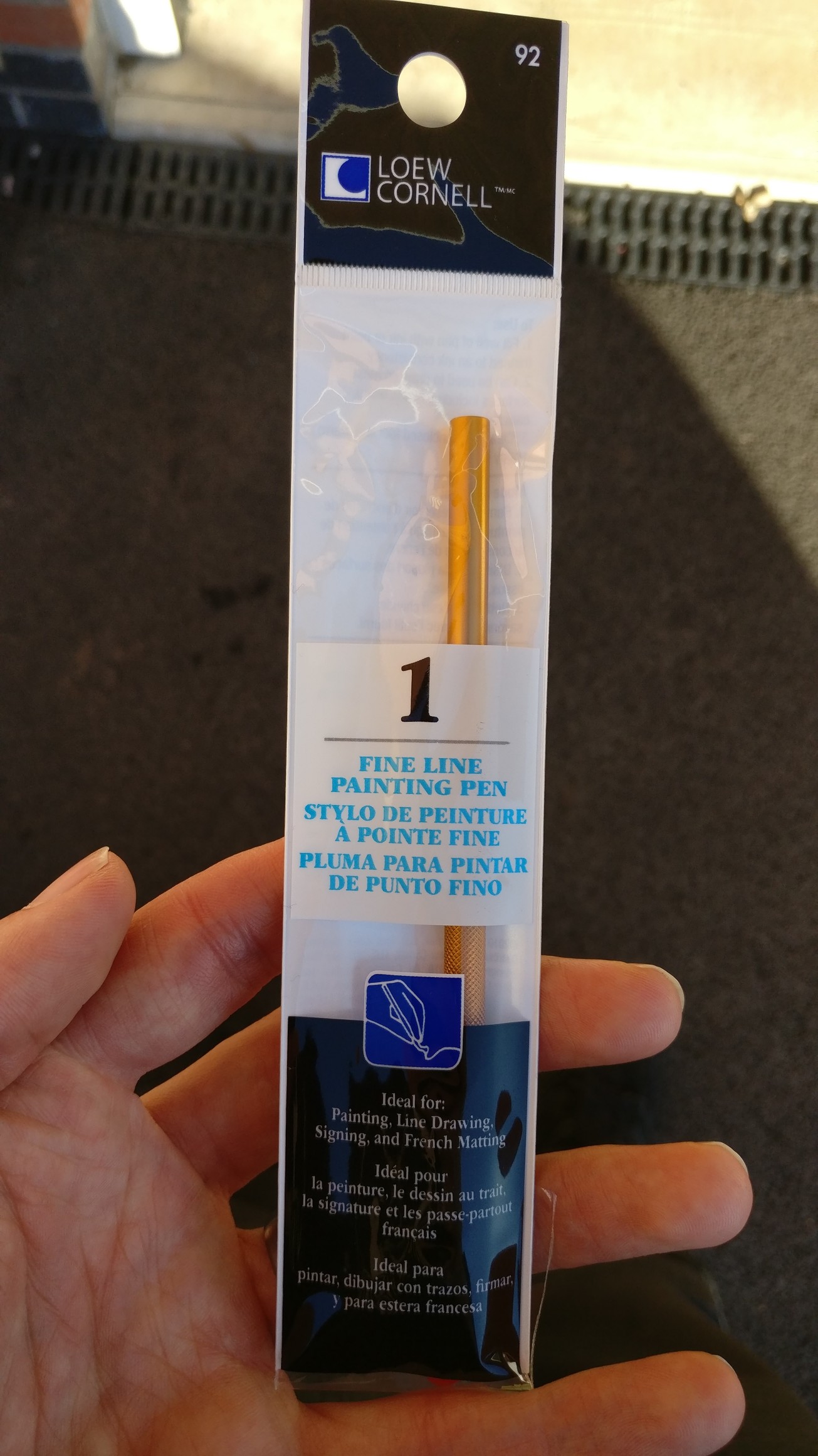

I have just sent for one of these for doing touch ups, the chipex applicators are good too, but hoping this "Pen" takes it up a notch.
https://www.bing.com/videos/search?...DF47B78E45A99BE34267DF47B78E45A99BE&FORM=VIRE
That's a good shout! Looks like it will work a treat although be careful not to leave a big blob lol I may even get one if it works well after you use it. My 8 year old speed blue has a few holes... The only issue I see is unless there is a cap for the top whe in you do a chip on the bumper it will all spill out lol

Yes may be awesome, if u see it in the for sale section you will know its pants LOL. Pro Detailers are right into them, can see the pros to especially when doing a few chips as when you "Load" up the paint their is usually a blob on the first chip.

Where did you get yours from? I'm interested already without waiting haha
Subc
May 12, 2008
426
5
Scotland
If you paste this into the Bay of E it will come up.
Loew-Cornell Fine Line Painting Pen: Hobby Artist Drawing Metal Art Car Detailer

I was intrigued with the tool suggested by @Subc which arrived yesterday

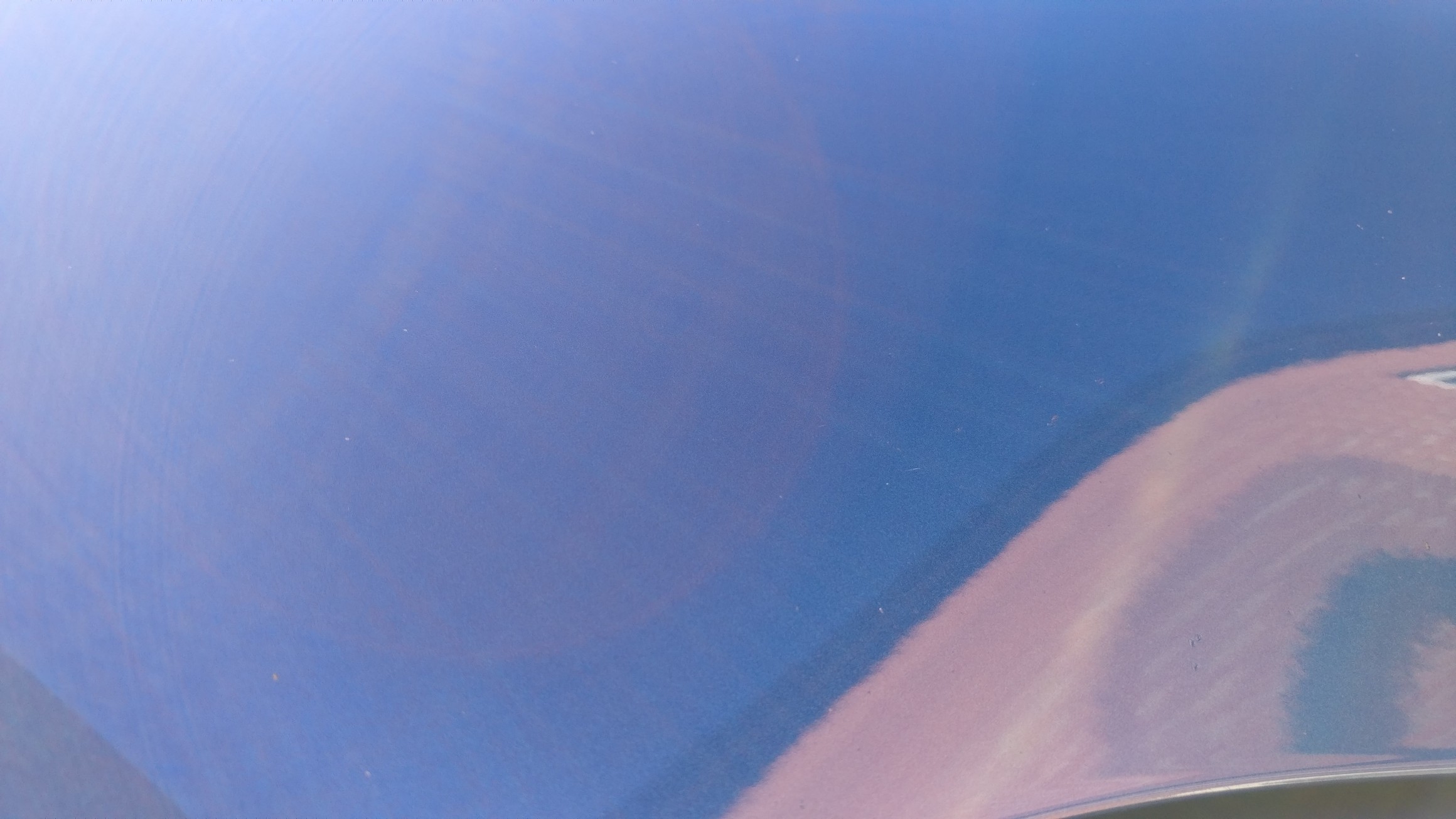

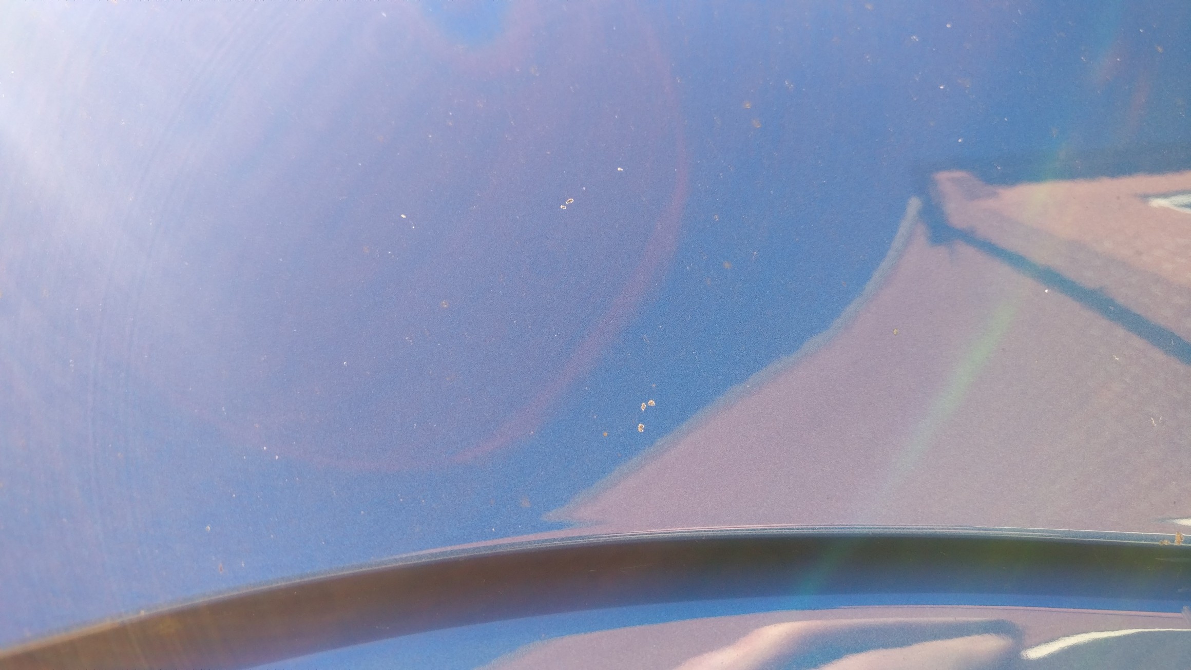

OK so I tried doing some stone chip repair today with this loew cornell nib thing... Great results and very easy to apply paint to your liking.
Before
After
Using this thing
Cheers for the link. Just be slow and steady.

Good job! My pen with thin brush thing has arrived so I'll have a go at the weekend if I get a chance and post results.

Great work, should have bought a box and sold them lol. Remember to keep it clean after use. Great to share knowledge :)
