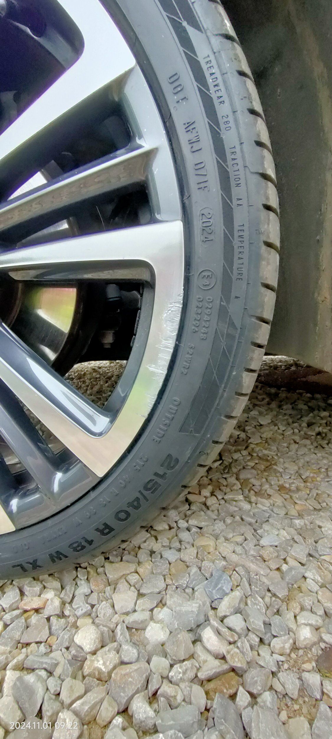

However, yesterday while parking the car and trying to manoeuvre into a space my front tyre touched and slightly rubbed against the kerb. Nothing unusual with that I thought, that was until I got home.

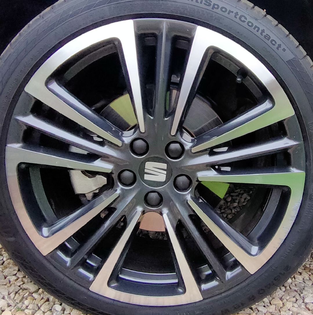

Why, because on the exact same front alloy wheel that has only recently been refurbished, there was a lovely scratch right along the mirror polished edging on the diamond cut alloy wheel. And to say that I'm gutted Is an understatement.
But what gets to me is that, the side of the tyre does not fit flush with the wheels but instead protrudes about 1/4" from the edging of the alloy wheel. So I can't understand how at such a low speed while parking the edge of the alloy wheel has got so badly scratched.

I fixed some marks like that on my diamond cut alloys on my Leon Cupra 280 a good few years back. I first rubbed down the damaged area with wet & dry paper, starting with a rougher grade and working down to finer. Then out came the trusty tube of Solvol Autosol and using that paste I polished out the last of the damage, I then covered with some lacquer and it looked great.
@motormadmarc - it’s so annoying when alloy wheel kerb damage happens; even more so when you’ve recently had that wheel (plus one other) refurbished. Unfortunately, I don’t think you’ll find a paint that’ll be a particularly good match to a bare metal diamond cut / polished surface. If you were trying to match a painted surface, then you‘d probably have greater success.
The method outlined by @Seastormer is what I’d try - assuming the kerb scratches aren’t too deep to be removed using appropriate grades of wet and dry paper.
