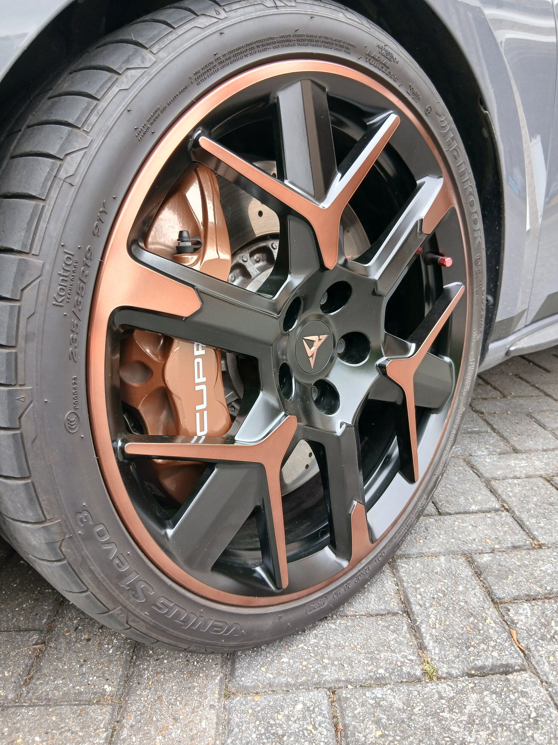

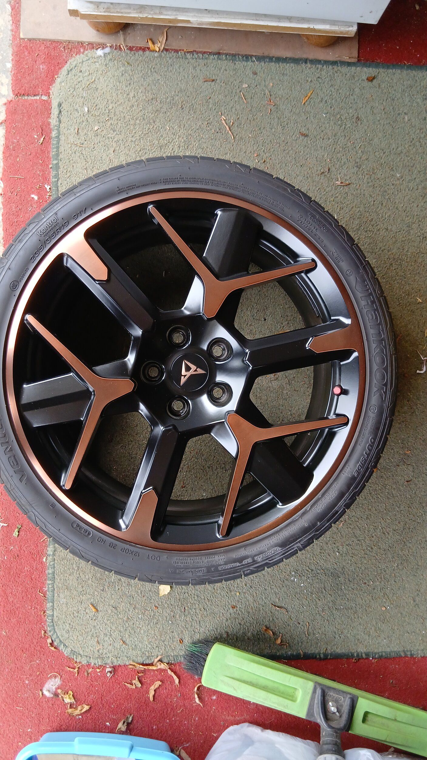

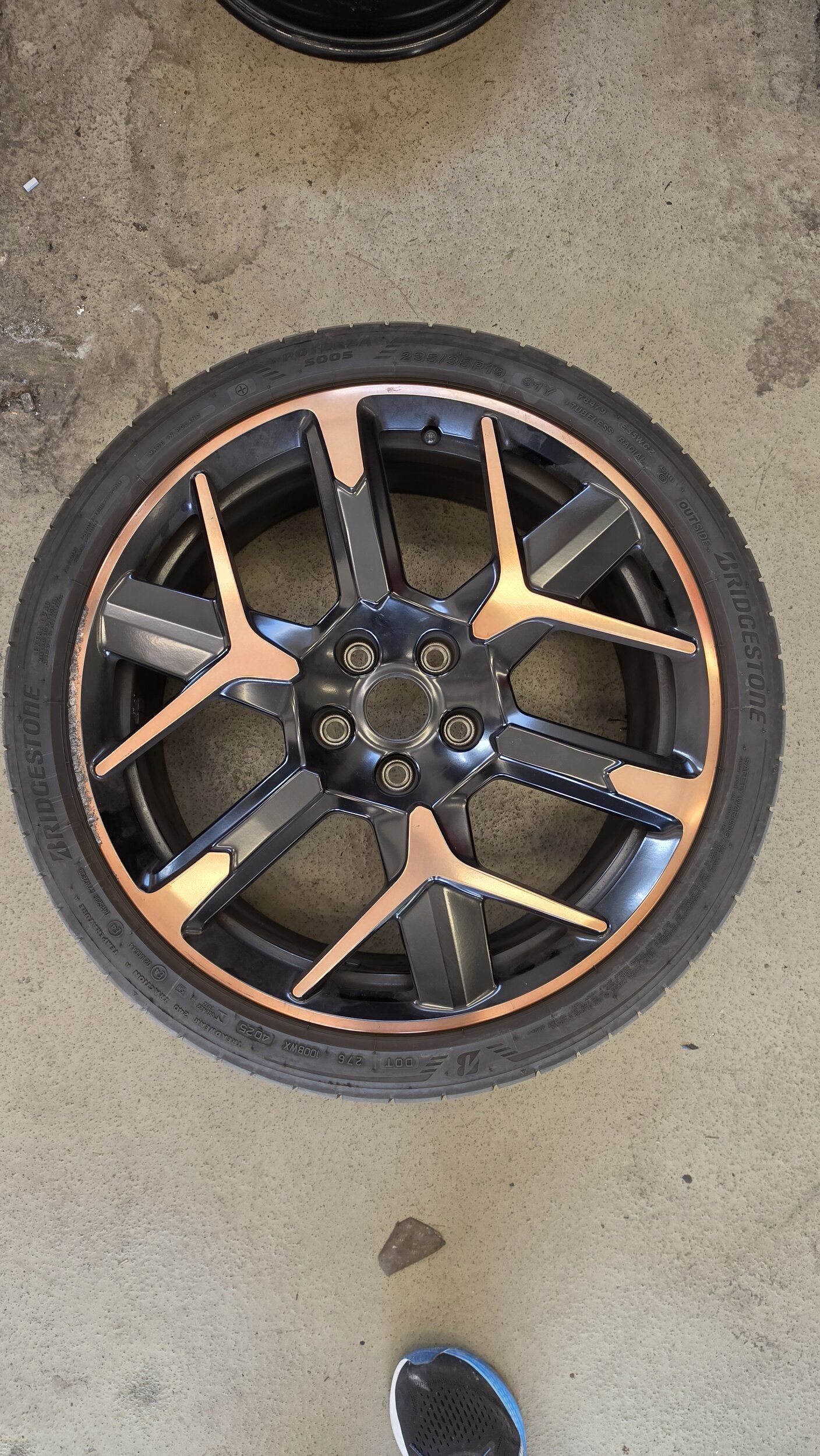

I'm very happy to report that the wheel repair went exceedingly well and beyond my expectations.
I was expecting a 'toning down' of the scuff at best due to the seemingly legendary difficulty of matching the copper colour, but Ricky at RMO Alloys in Sutton, Surrey, did a superb job. You'd need to look quite hard to see that any repair has been done.
Find him on Facebook and Messenger at RMO Alloys. He operates within a 70 mile radius of Sutton, so quite a wide area.
Highly recommended to sort out our copper wheels!

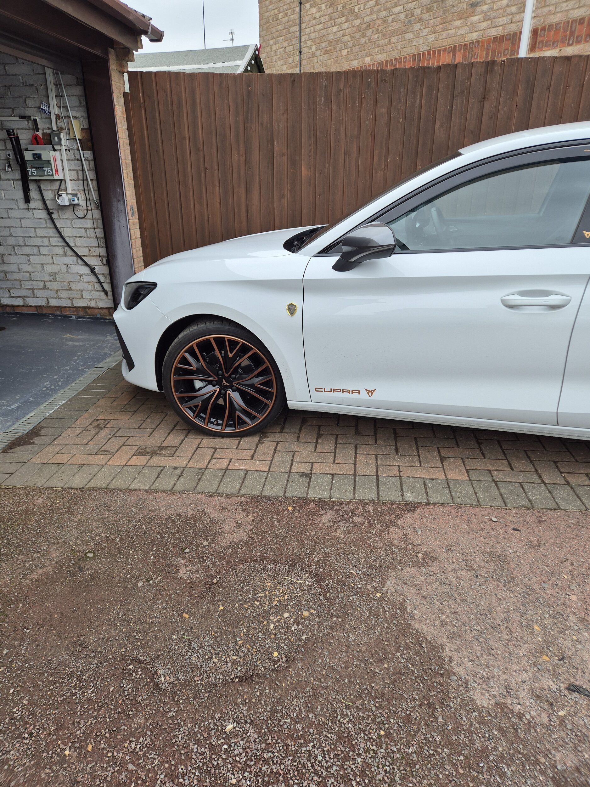

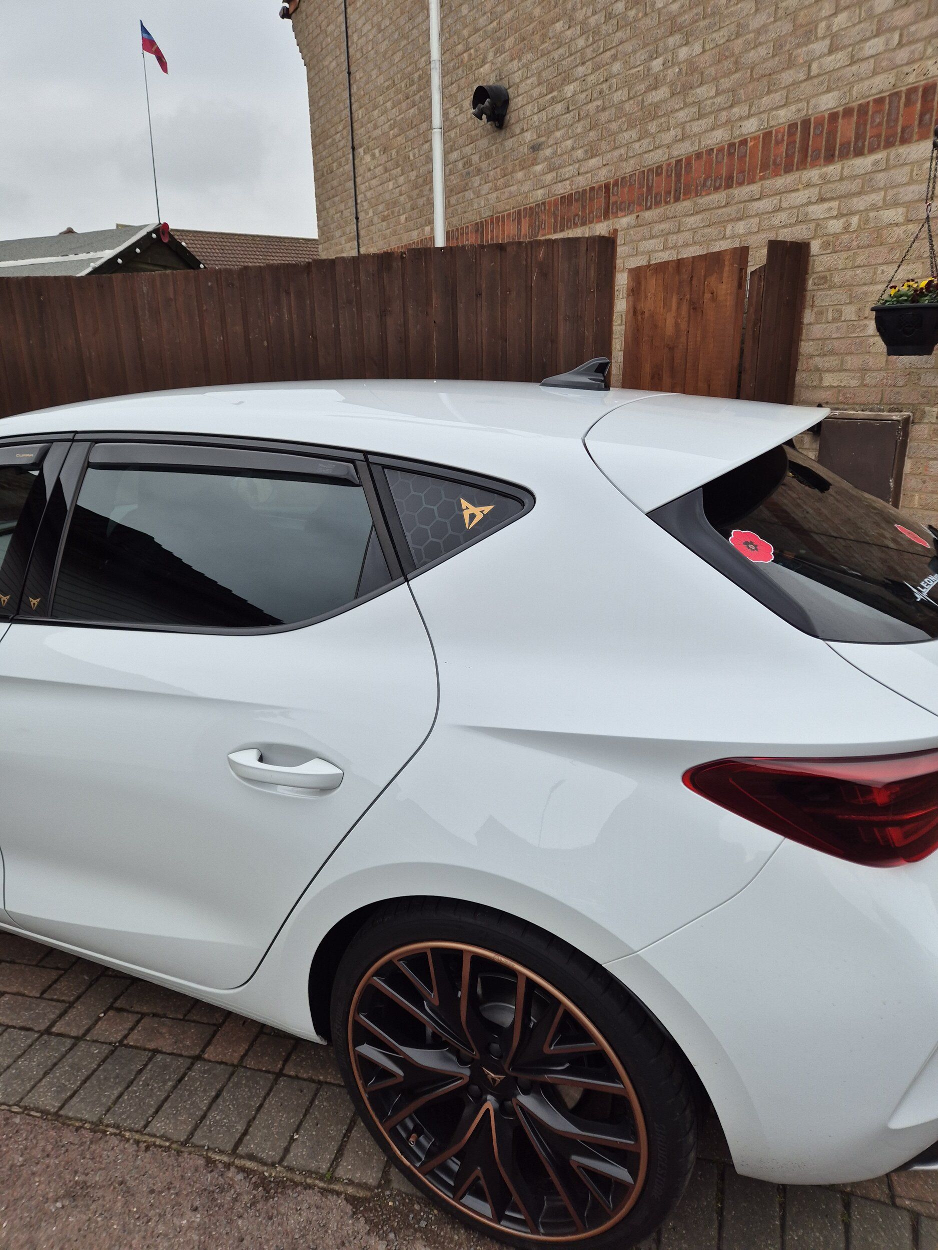

As soon as I picked up my V3 I went straight to an alloygator fitting garage and got gators put on.... Looks ok too!

Just a thought, I like the copper and got myself a set of these alloygators, inexpensive when you compare it with kerbing a wheel, and I quite like them on my Leon 3

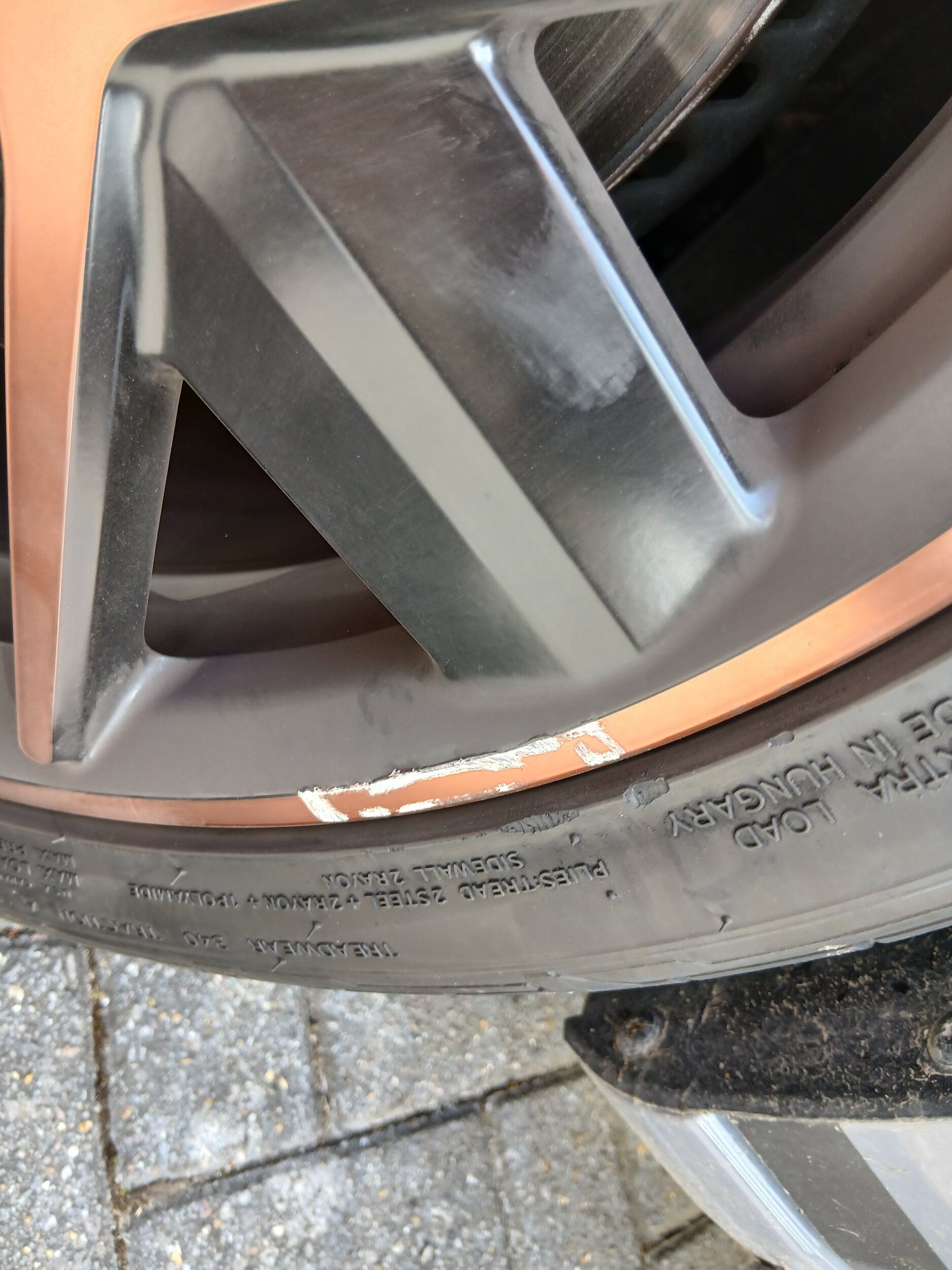

Any option to do a quick and simple repair on those wheel? I have a very small scratch on the edge between copper and black part
I don't need a perfect repair, it's just that since the scratch is white, I see it from far :LOL: So I think a simple solution by covering it in black would be sufficiant, are those repair pen worth it ?

You could even try a permanent marker pen. It wont be permanent as the wheel will see all sorts of road grim and cleaning etc but will do the job for a couple of months I suspect. i tried one on our previous Black Ibiza's stone chips and from 10 metres your couldn't see it.
I would personally by hesitant to go for Alloy gators as I understand, (only from hear say on a detailing site) that they can mark the Alloy underneath - not sure if thats the case.

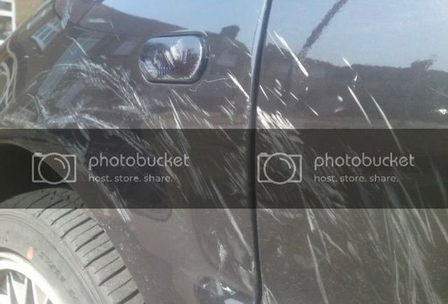

That’s my understanding too. Also hearsay on a detailing site from some years ago, if small particles of grit get lodged between the face of a diamond cut alloy and the reverse side of the Alloygator, the lacquered surface of the alloy can become damaged, allowing the ingress of moisture, road salt and oxygen and the formation of white worm corrosion which ‘creeps’ over the surface of the alloy under the lacquer. White worm can only really be successfully removed with a full refurb, and a good quality professional refurb doesn’t come cheap these days, especially if all four wheels need doing.
There can also be issues with the stick on type of rim protectors (I think Rimblades are stuck to the rim of the alloy with 3M type tape). There’ve been cases discussed on some forums in the past where the Rimblade becomes detached from the alloy at the point where the two ends are joined. The loose end of a Rimblade hitting adjacent body panels with each revolution of the wheel can cause significant damage to paintwork and the body panels; see picture below;

Yeah, with me having badluck all the time, this will definitely happen to me lol

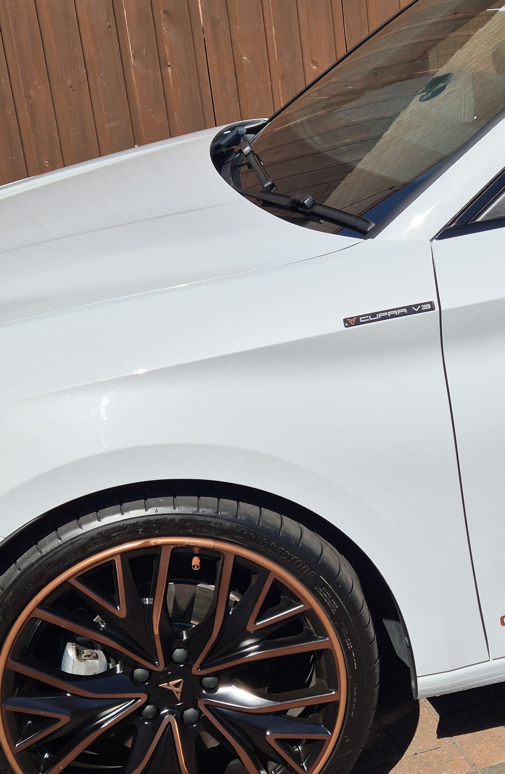

I've been using Allogators on my last 4 cars, I wouldn't be without them. I have never had a problem with them and I currently have them on my V3 which compliments the copper wheels I have as standard.
