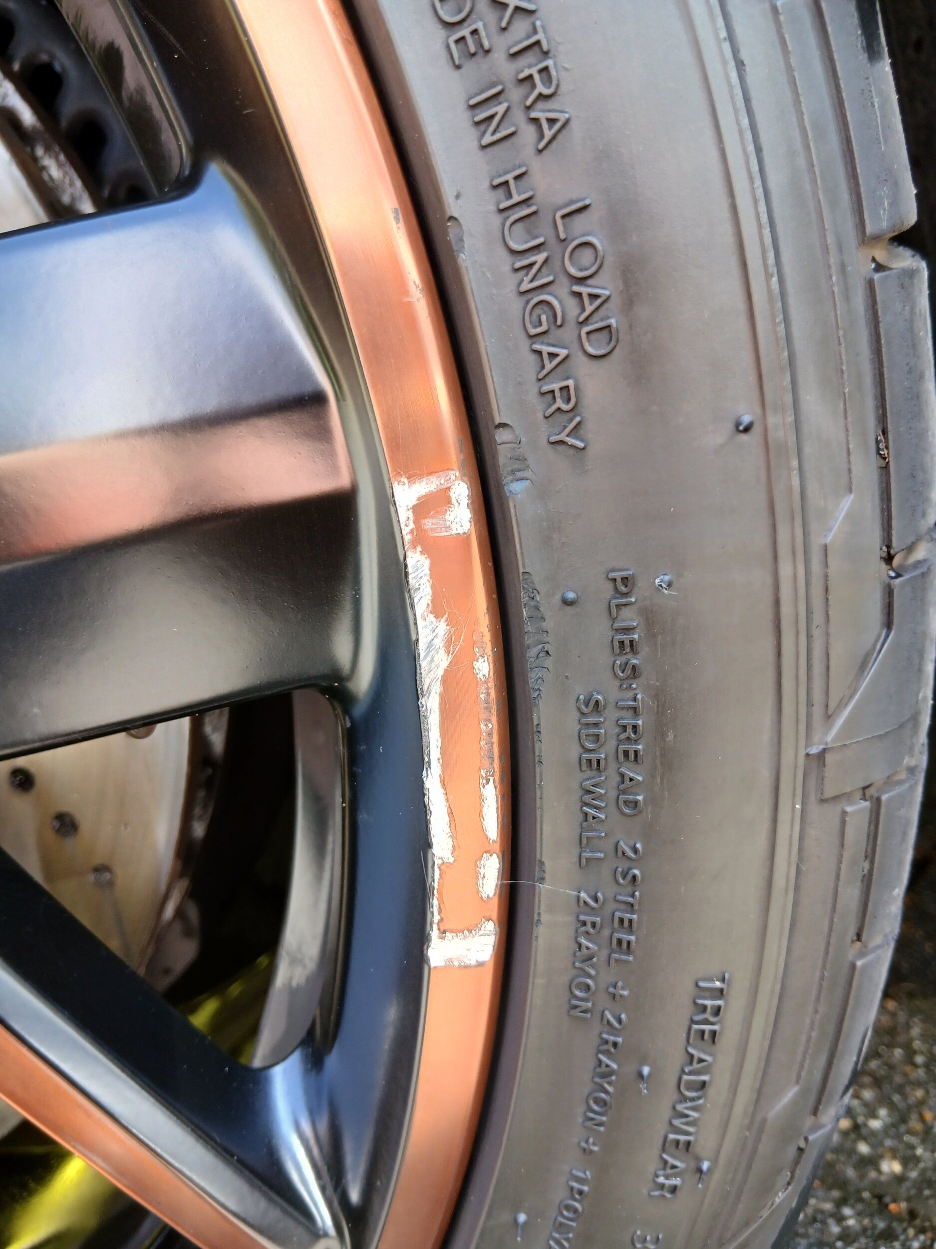

I remember visiting the local Wheel Works facility last year when I took a wheel from my 370Z into them for a refurb - I unloaded it from the boot of my Leon and as I was doing that, one of their employees walked by and commented "don't ever scuff those wheels", pointing at the Leon's wheels. I didn't respond and thought no more of it, however now I know what he meant.
Having done close to 1000 trouble and damage free miles last week driving to Germany and back, boarding the Eurotunnel at Calais I hit the low kerb with the N/S/F alloy after I was directed upstairs, where the roadway narrows at the crest of the ascent. Bo£$%cks!, to put it mildly.....
So, now I need a refurb or localised smart repair, but my options are less than minimal - nobody, apart from one smart repairer, is willing to give it a go because of the difficulty of matching the copper colour, which I've learnt isn't a paint, but a varnish over the diamond cut face. I've phoned two CUPRA dealers, who say that it can't be refurbed!
Any repair is better than no repair so I've no option but to give this one brave soul a go.
Has anyone any experience of this issue with your copper wheels? Any help or tips appreciated.

Ouch i know what you mean about that curb on the Euro Tunnel.
Have you tried Lepsons, they have a site in Kent and another in the Midlands, may be worth a call,
@Loadmaster748; supplying a car with alloys that - according to Cupra dealers - can’t be repaired is utter madness. I bet they don’t disclose that to customers when they buy the car!
Having said that, I’d be pretty confident in saying the Cupra dealers are incorrect. As you’ve discovered, the copper colour is a tinted clear coat on the diamond cut face and not all alloy wheel refurbishers will tackle diamond cut alloys with a colour tinted clear coat finish. However, as @Rob66 has suggested, I’d give Lepsons a shout. I’ve not personally used them but they get excellent feedback on many VW forums by those who’ve used them. They’re also reputed to be one of the best - if not THE best - wheel refurb companies in the country, so I’d be surprised if they’re unable to refurbish colour tinted diamond cut alloys back to OEM factory standard.
Please keep this discussion topic updated with how you proceed for the benefit of other forum members in case anyone else is ever unfortunate enough to find themselves in a similar situation to you.
I feel your pain! I’ve scuffed two Cupra copper alloys over the past five years and unfortunately it is impossible to re colour them exactly. They can be refurbished but unless you can put up with a colour mismatch (I couldn’t) you have to have both done on the same side. In the end I bit the bullet, bought two extremely expensive replacements and found two more second hand scuffed wheels. I had the scuffed wheel set refurbed (just polished no copper tint) and I now have a copper and silver set of the same wheels. My alloys are originally mk3 versions and were offered in both colours anyway.

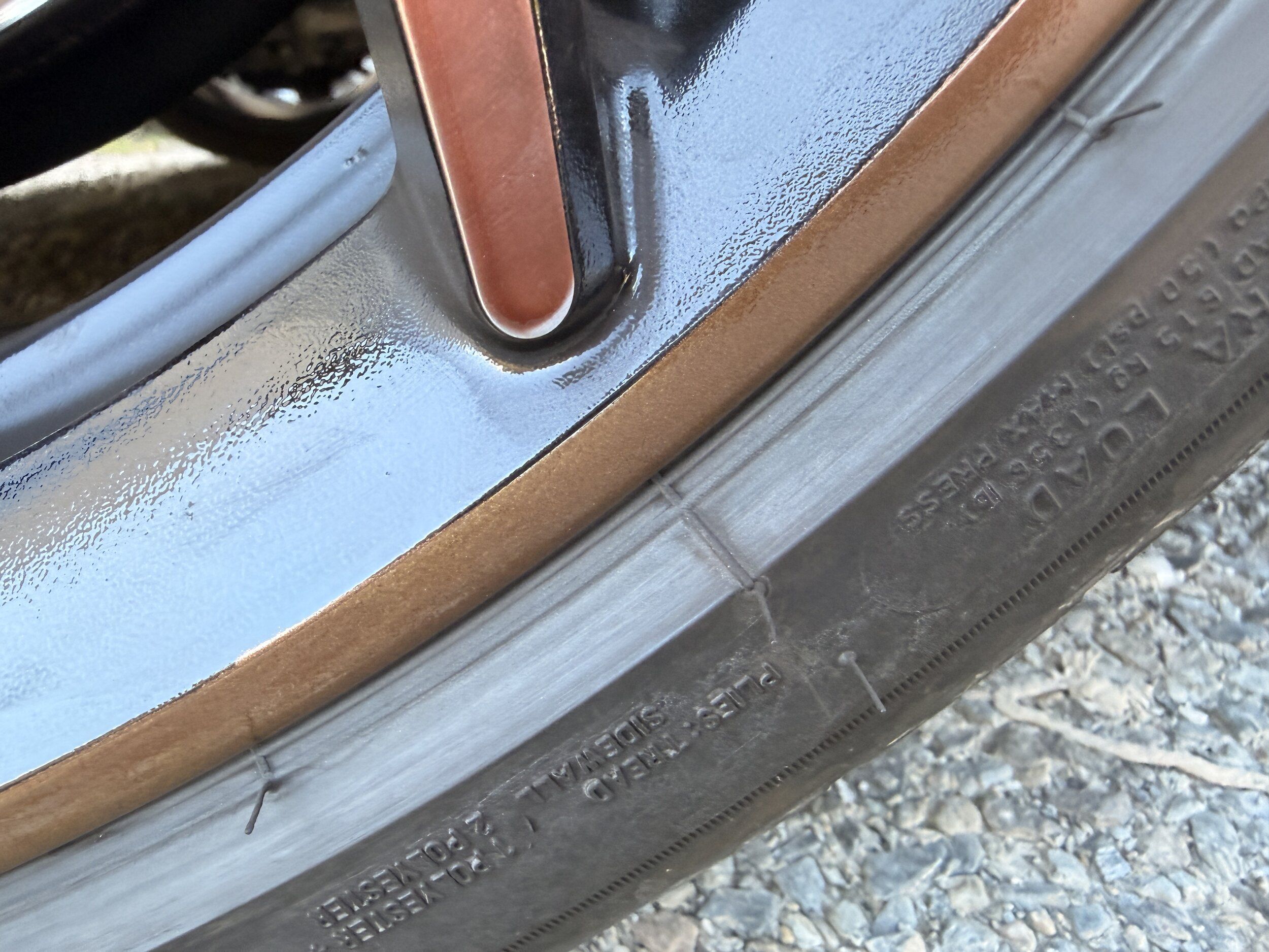

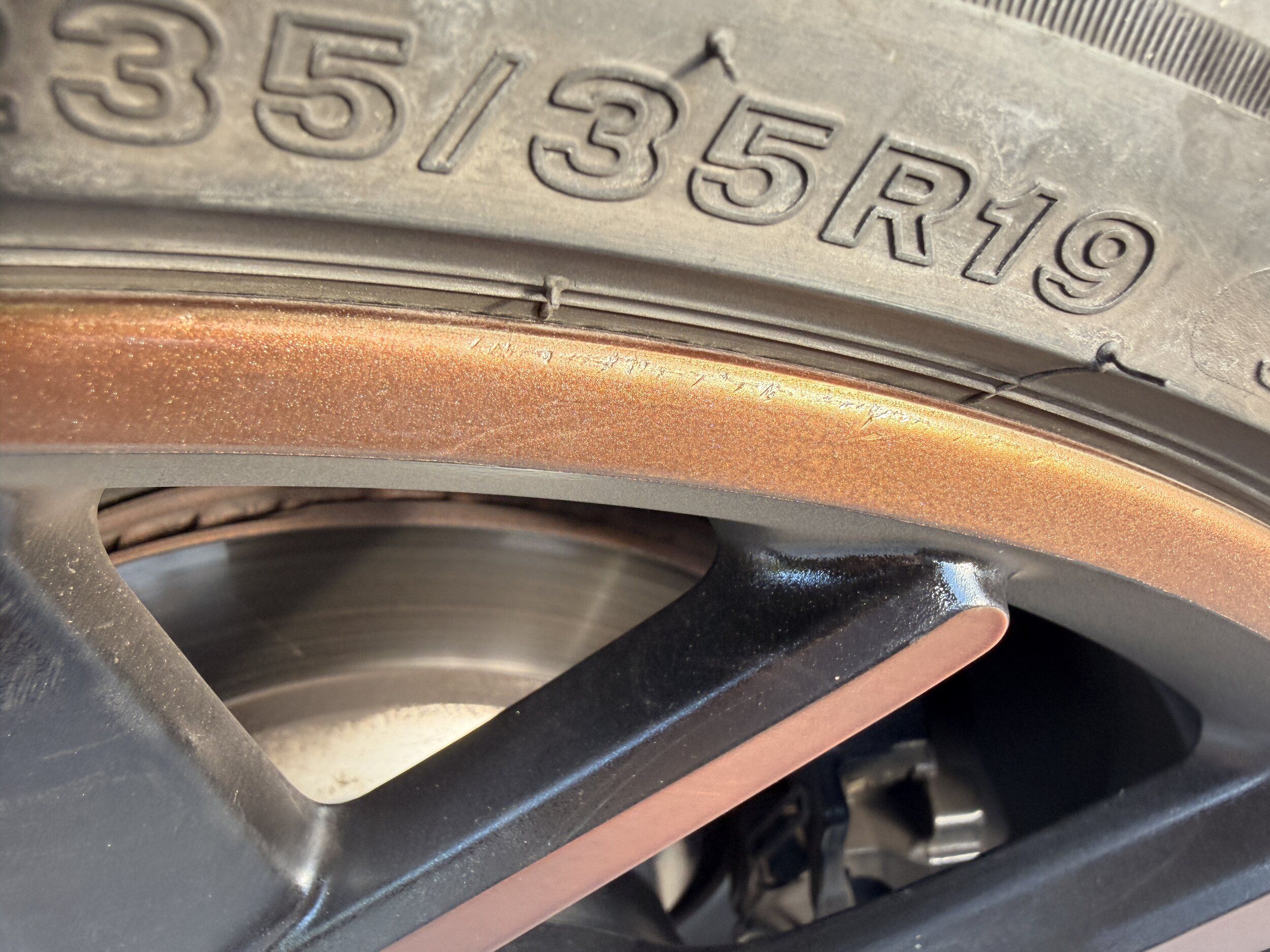

I’m currently in talks with the company that attempted to repair mine. Paid the insurance at the dealership for so many repairs in three years.
The repair was rubbish. Removed more material than was needed. Colour match was awful. The guy didn’t ever rotate the wheel to access the damage when he was repairing it. So I’m now pushing for a replacement. Spoken to 3 wheel repair companies and they have said they couldn’t do them. Because of the colour match they’d have to do all 4 also machining the face because they are at 3 different levels. Also because they are forged alloy it can leave a honeycomb type for finish which can be seen through the lacquer apparently. They couldn’t even match the black ffs

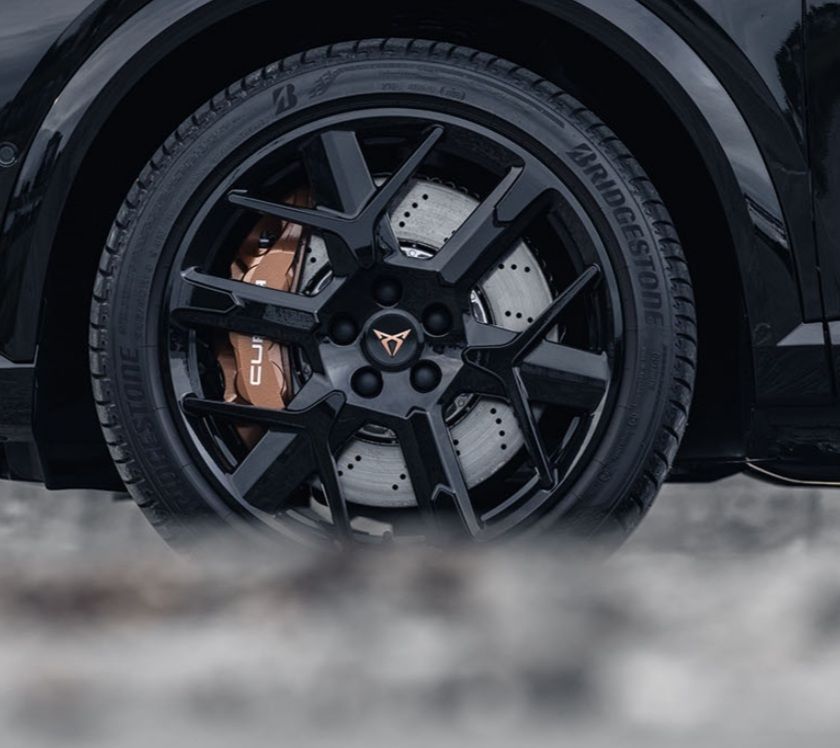

If all else fails you could go all gloss black and not live in fear of curbing them again. They look quite good in my opinion and make the copper calipers pop. View attachment 54382
I agree they do look good and there’s none of the issues associated with diamond cut alloys. However, if a car is leased under a PCH or bought under a PCP, you would need to consider the terms of the PCH / PCP contract(s) to see if such a change is allowed;
  • PCH; the car is owned by the finance company and under the terms of the lease agreement, modifications (changing the finish / colour of the alloys would be classed as a modification) might not be permitted or if they are, permission of the lease company would be needed first. It’s also likely that the car needs to be returned back to factory spec at the end of the lease term, involving the additional cost of getting the alloys refinished in the original black / copper diamond cut finish.
  • PCP; similar considerations apply to those under a PCH, although there may be a bit more flexibility if you exercise the right to make the balloon payment and keep the car at the end of the contract term.
My advice though - for what it’s worth 🤣 - would be to always check the small print of the PCH / PCP contract and get permission of the finance company before making any modifications, and also consider if there are any insurance implications.
Reactions: Lucas90
Good point! PCP you probably would be okay as long as you paid the final payment to own the car. PCH I doubt they would let modifications. Always worth checking though.
Agreed, this would be a good way to approach the problem and normally I might go down this route, however:
1. An all black wheel tends to hide the detail of the wheel's design, with the exception of simple multispoke designs.
2. CUPRA's Hailstorm design is, in my opinion, one of the best designs I've seen in a long time and with the copper accents looks so good against the car. So in this case, they will stay as they are.
