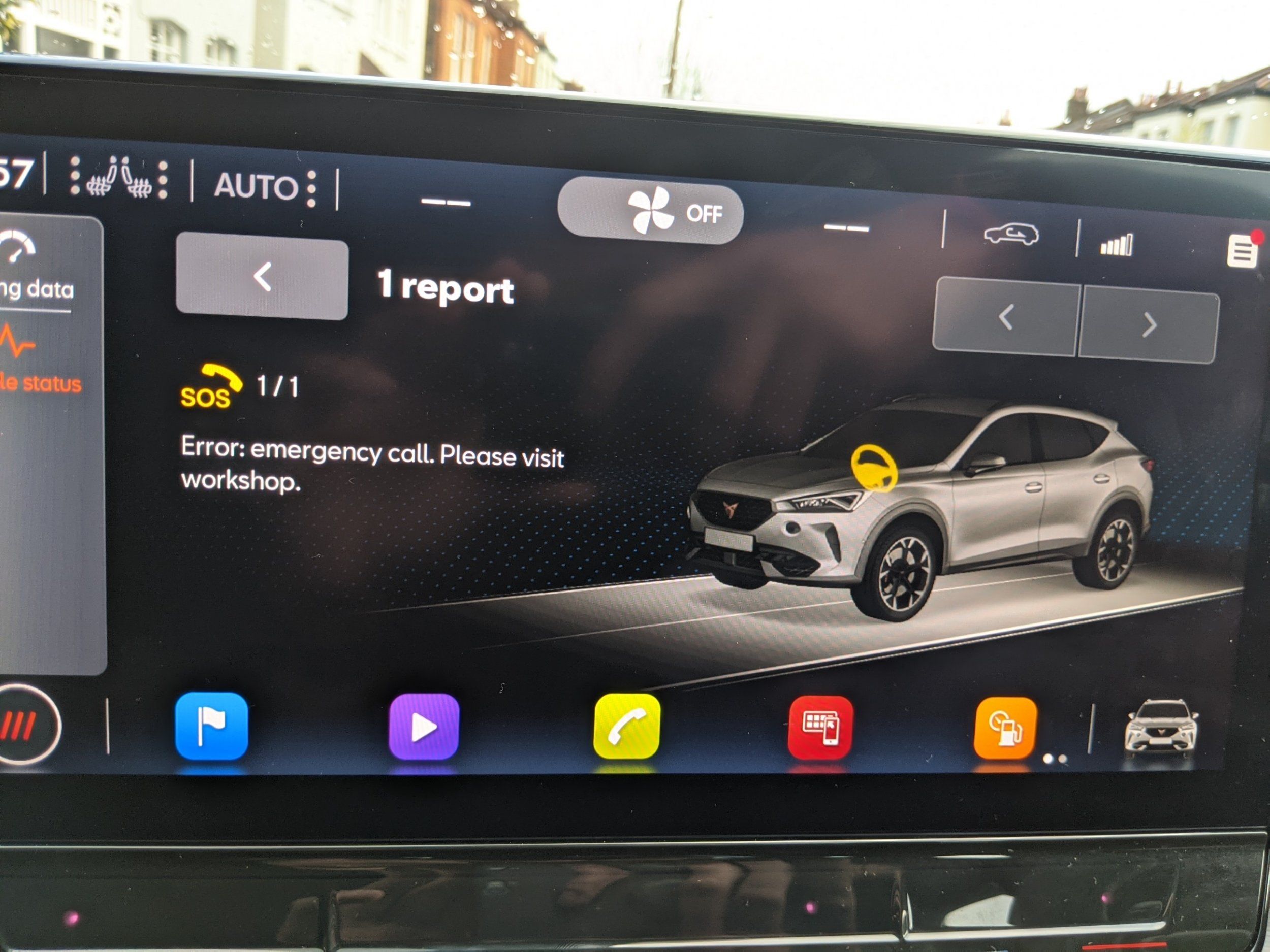

A week old and got a warning message this morning. Spoke to my local Cupra garage, one's a fault with the SOS system and second potentially more serious with the steering. Was advised not to drive the car... First available slot for service department... 6th April!!
