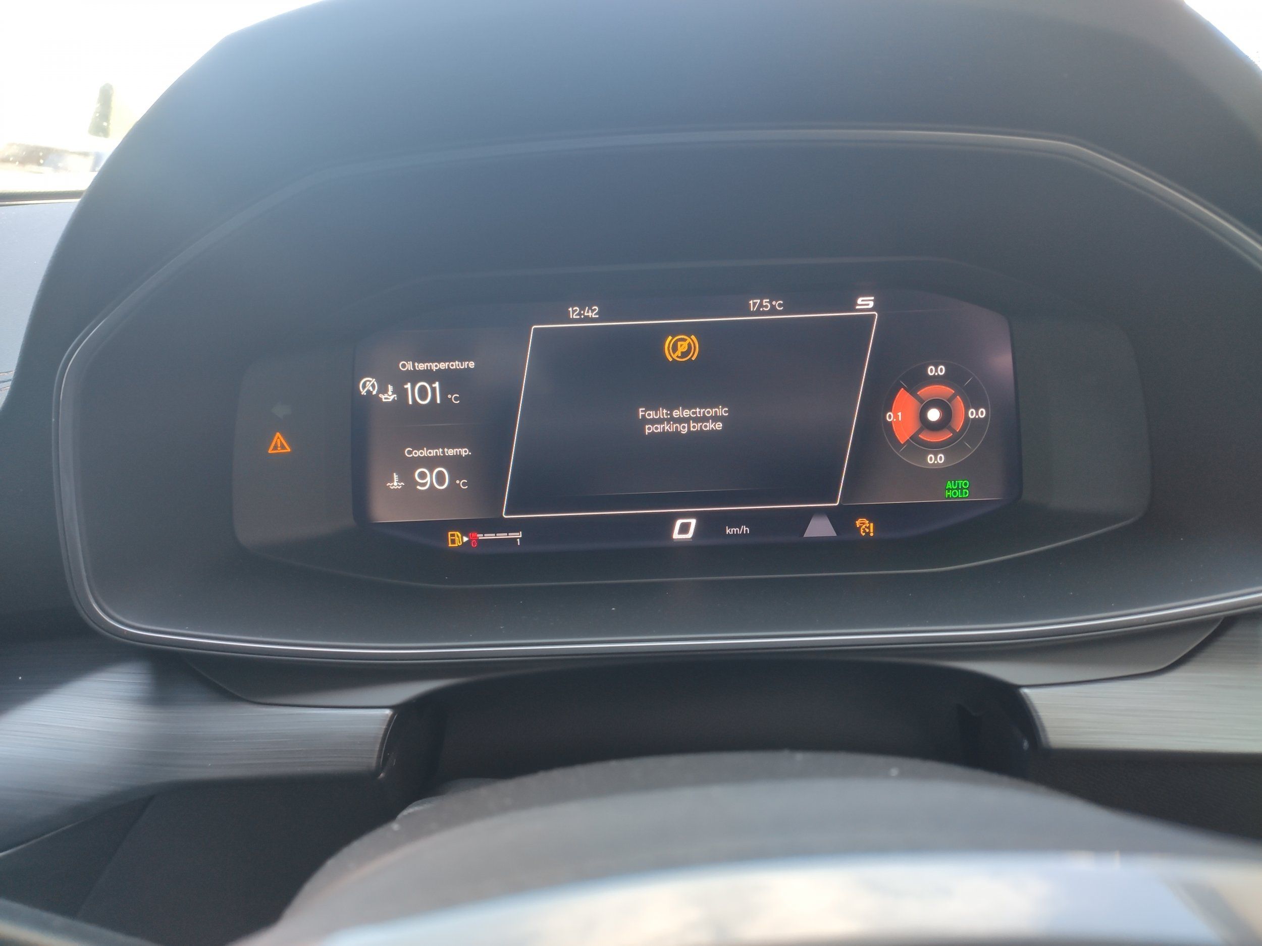

It's the new Leon though but I've had most of these - parking brake fail, lane assist fail, key not identified so was unable to start the car for 5 minutes, all kinds of bugs in CarPlay.

Today camera froze on me while reversing. It then threw up information on screen and dashboard about parking assist error. It unfroze when I was driving forward at low speed. It didn't come up when reversing again a few minutes later.
Also got Exit warning system unavailable error couple of times. Not that I care about it.
Hardware rev D.
I drove countless cars with reversing camera and none ever froze on me. I guess it's not really camera, it's the system.

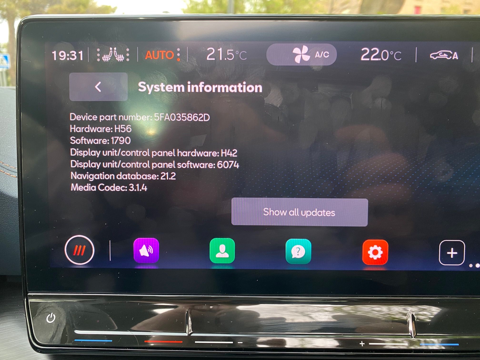

@Zephyr - just to make sure I'm reading mine properly, which numbers on the system information page change when you complete an update?
Sorry for being late, had some probs on the past week. This is what I promised you. Sorry for the fingerprints on the screen..
I read there's service bulletin for Formentor for cars with VIN numbers: 000226 - 007184. Only found info in German so far: "Es gibt nun von Cupra die erste Feldmaßnahme (18.03.2021) für den Formentor, FIN-Bereich 000226 - 007184" https://www.cupracer-hilfe.de/feldmaßnahme90q7
It something to do with CAN bus communication and coding some drivers. Update of main computer and Infotainment. Someone mentions that the only difference he notices, is Cupra noise when car is stationary, which before was only available when driving. Software version is now showing as 1672. Display Unit Control Panel version 6074. That was for unit with rev C. Work was done in dealership, 3 software packages to be applied.
I translated it from two languages, so info might look a bit chaotic.
My VIN falls within that group of numbers. Ive been having various problems with infotainment and safety systems. Think it’s time to discuss further with the main dealer.
