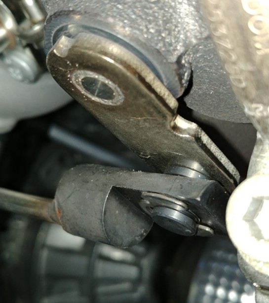

It will be as hot as the exhaust, hope you didn't lose any skin. Mine has a fair amount of play at both ends, on the exhaust end it's metal on metal and the circlip doesn't look that great to me (photo attached)
Skin all still intact thanx!
Difficult to see from your photo, but not sure that circlip is seated fully is it?
That's exactly it, thanks. The same problem with a slightly different design valve.
Once it's cool I'll see if the circlip can be reseated, otherwise there is an adjuster on the solenoid end.

My issue is nowhere as bad as the video, the valve itself is solid and the linkage has only a small amount of play at either end.
