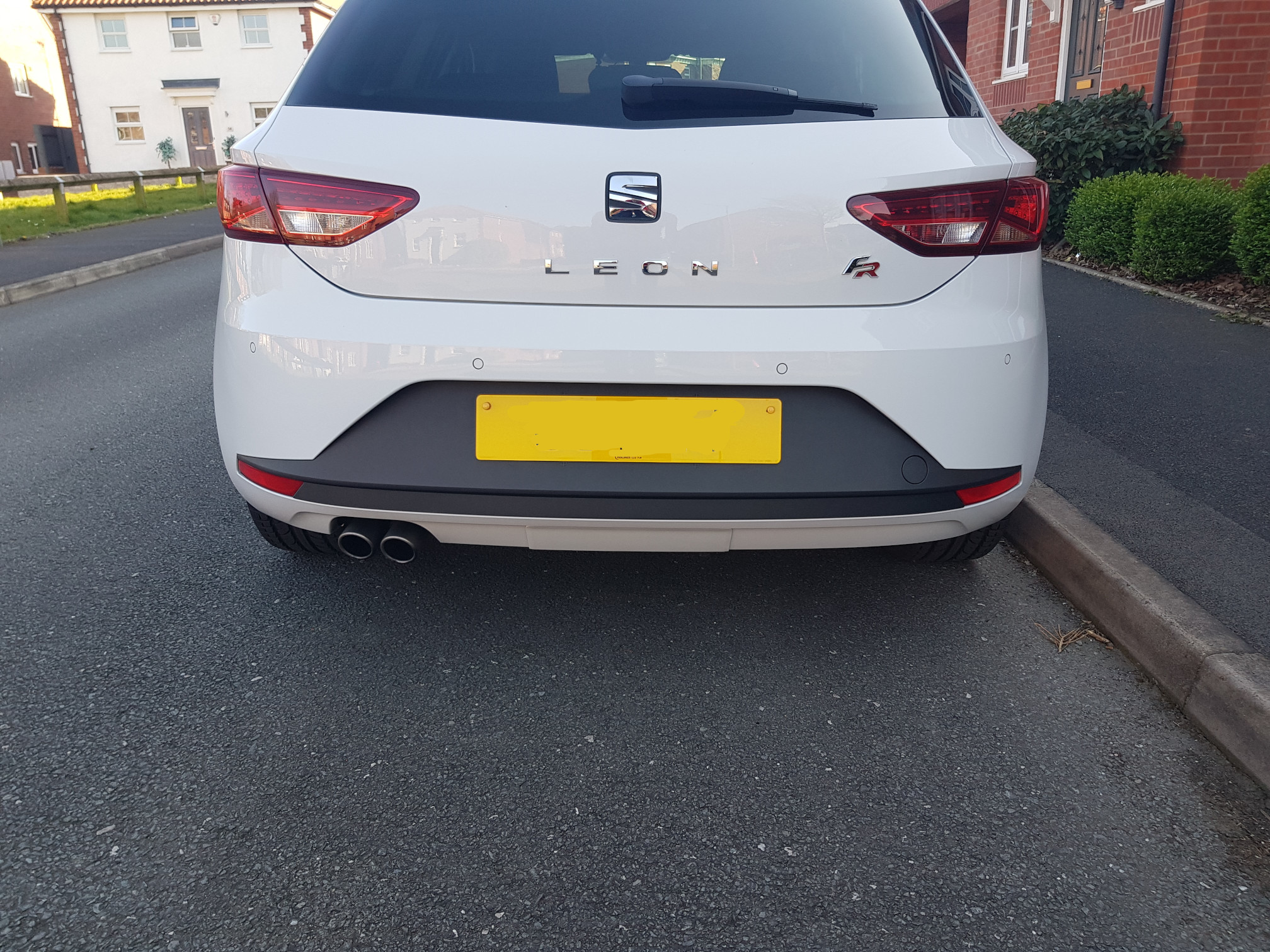

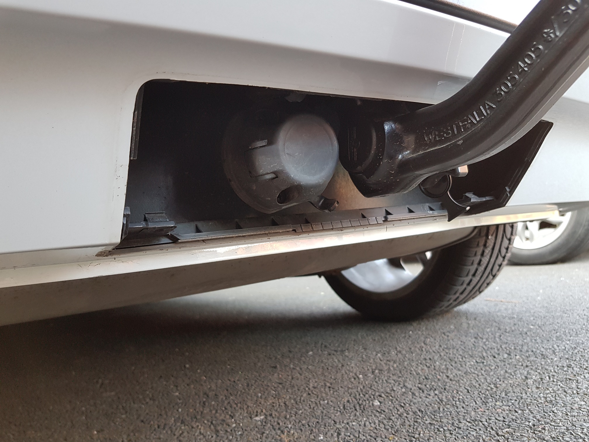

I have a westfalia towbar on my Leon FR. Again in White and you don't really notice the panel much.

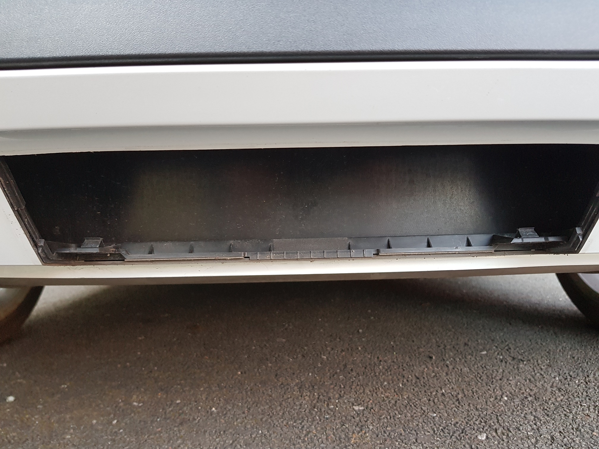

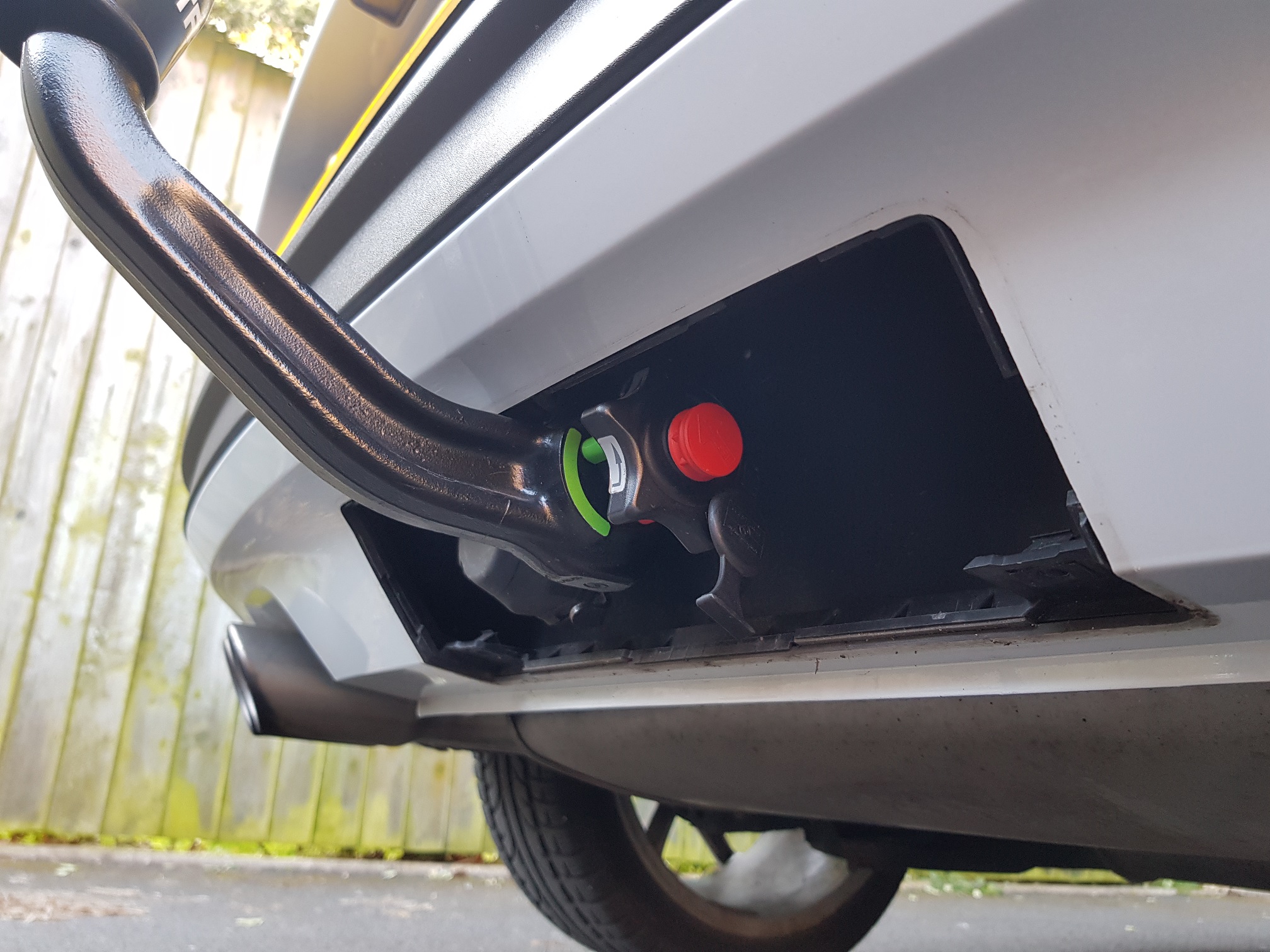

I used to have a 2015 FR184 ST with a detachable towbar and it needed to have that hatch cut out. I had the cover which matched the car and I hardly noticed it when the towbar wasn't on. The electric point swivelled so you just pushed it up out of sight before fitting the cover. I was always worried the cover might fly off when I was driving so I put a cable tie on it just to make sure it didn't. I have a 1300kg caravan (MTPLM) and it towed it brilliantly

2. Looking at the Westfalia mount on your car, would you say it was possible to avoid cutting into the visible bit of the bumper if I made the hole only large enough for the towbar (with minimum clearance) and mounted the socket elsewhere?

You can only get the cover direct from Seat. The towbar fitter I used got it and painted it prior to fitting. Unfortunately you wont be able to get away without cutting the bumper. It wraps under the car too much. Way past were the tow bar comes down.
