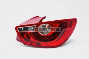

Hello,
Does anyone know if is possible to install the facelift Ibiza 5dr LED lights to a pre facelift 2009 5dr Ibiza. Looking at images, they seem to be the same shape and size and the connectors look identical.
Stock:
LED:
Could anyone shed some light on whether these would work?
Thanks!

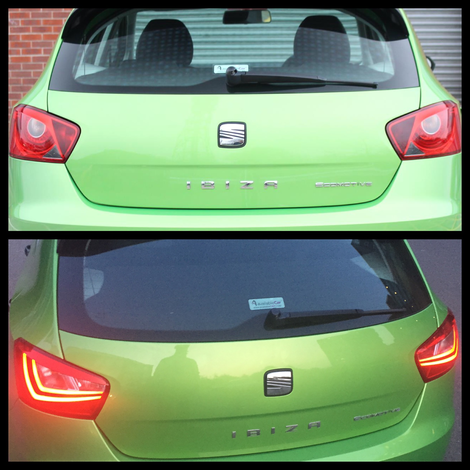

I’ve done it on my old seat Ibiza that was a 62 reg. it’s a straight swap, but be careful of getting the bulb error symbol on your car, even though it’ll work. You’ll have to clear it with a device like VCDS.
Reactions: Benjy3000
Just changed mine to leds too but can't clear error on the dash, could you explain please what have changed vith vcds? thank you
