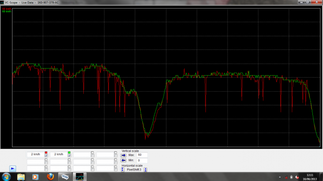

So I did a graph log on the car with the new sensor in (graph compares nearside rear (red) to offside rear (green). The Red line looks very erratic to me....

The mechanical fault is the hub, the hub is probably so corroded its started cutting into the abs sensor. Common issue, take the hub off to confirm.
Yeah, looking from underneath with a torch I can see the ring is a bit corroded and the old sensor was being rubbed, I had to put a thin washer between the new sesor and the rear of the hub to create a 1mm gap.
Thanks for confirming, I'll get a hub ordered up.
