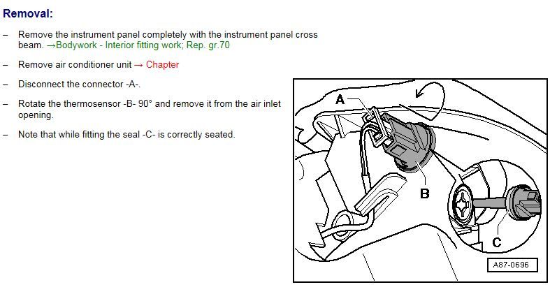

Can you point me to info on replacing the G89 fresh air temp sensor please? Without removing the dashboard
Is it possible to reset it via VCDS?
Many thanks
