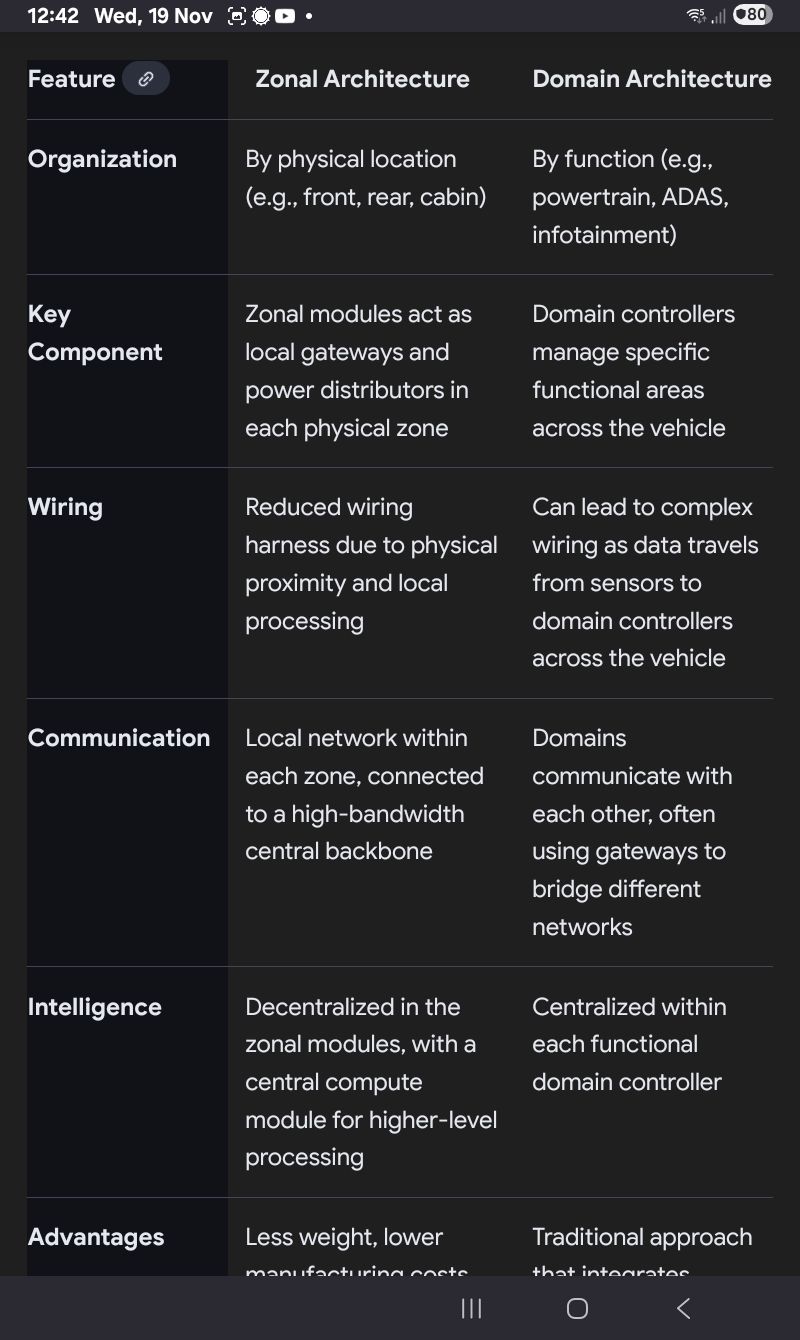

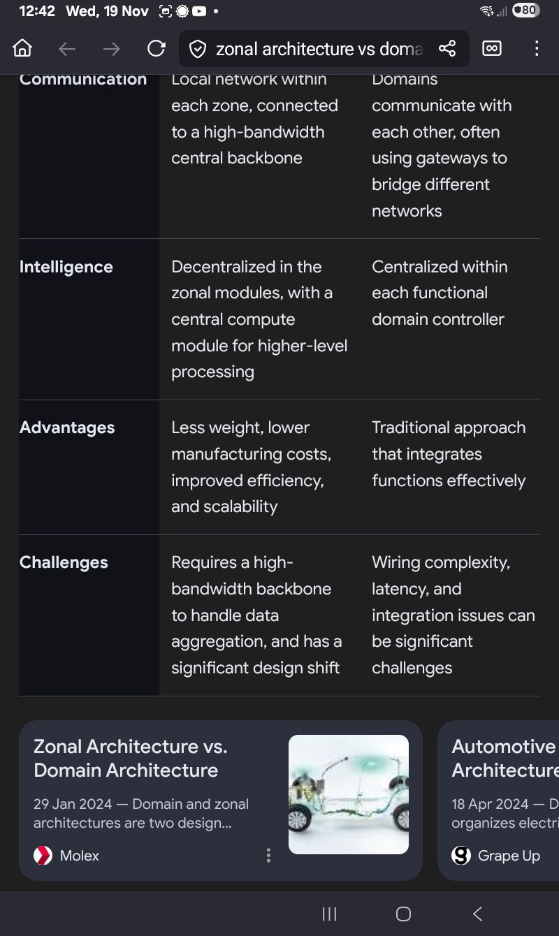

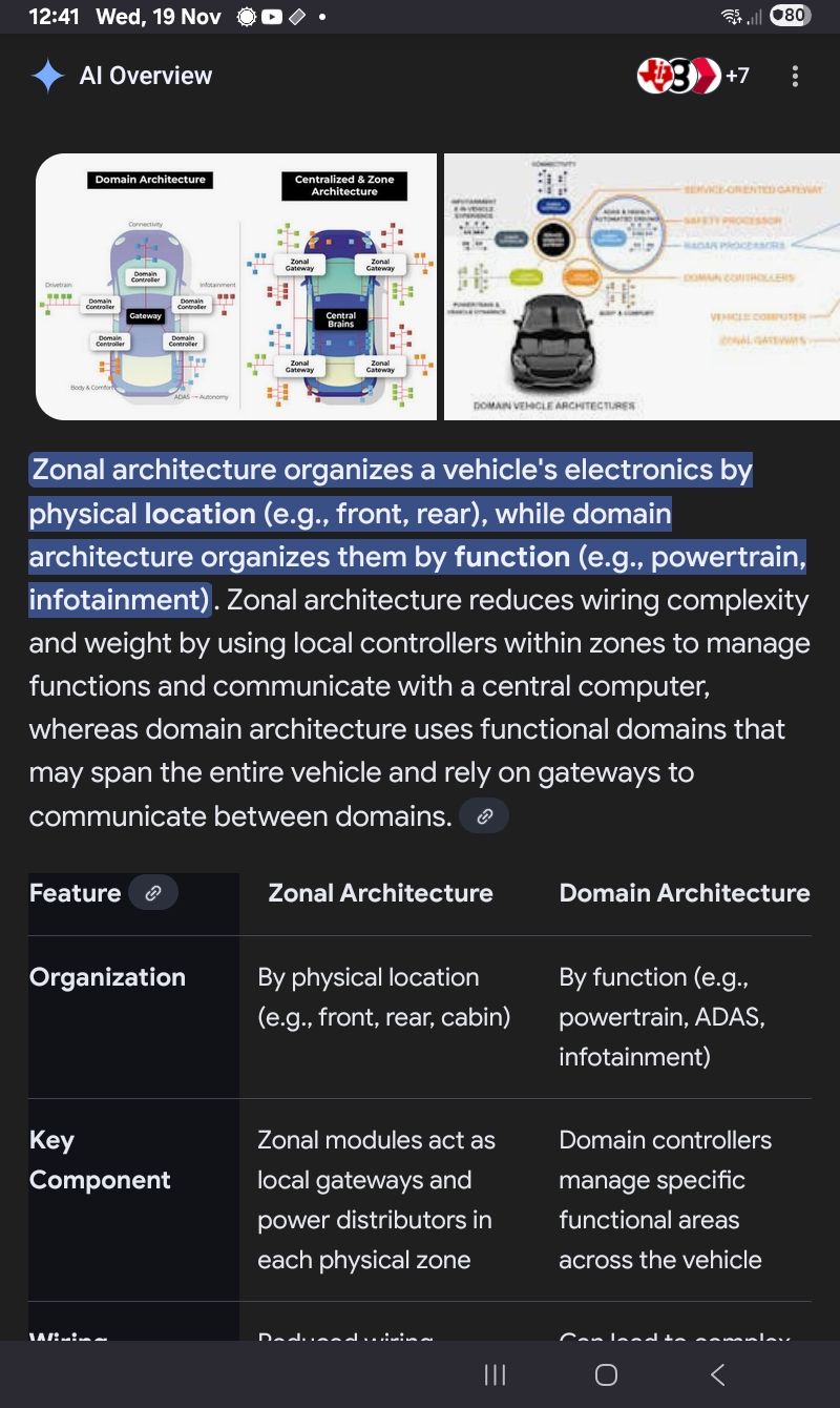

Zonal architecture is their thing:
So zonal architecture it will be... whether this is marketing hype we'll find out.

Control system architecture. You wouldn't think they would run with two so they will be dumping their own if zonal architecture comes to fruiting. Distributed control system with one gateway but the zonal architecture is like having networked control. I'll be corrected. So four ticking brains that talk to each other. There will be a reason why:
