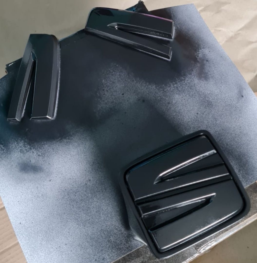

Not sure who could benefit from this but I came here to try find a simpler way to remove the front badge on my Leon ST. I for some reason couldn't unclip it from under the trim that sits above the top grill and by chance whilst I tried to pry it out using a trim remover tool from the exterior badge itself, the top half of the 'S' came off. I thought I broke it, turns out its clipped onto the whole badge housing. So I unclipped the bottom half of the 'S' and once I sprayed them black I clipped them back onto the badge. See images in case my explanation is rubbish.
The front badge in 2 bits top left of the image. Bottom of image is the rear boot badge/latch.
