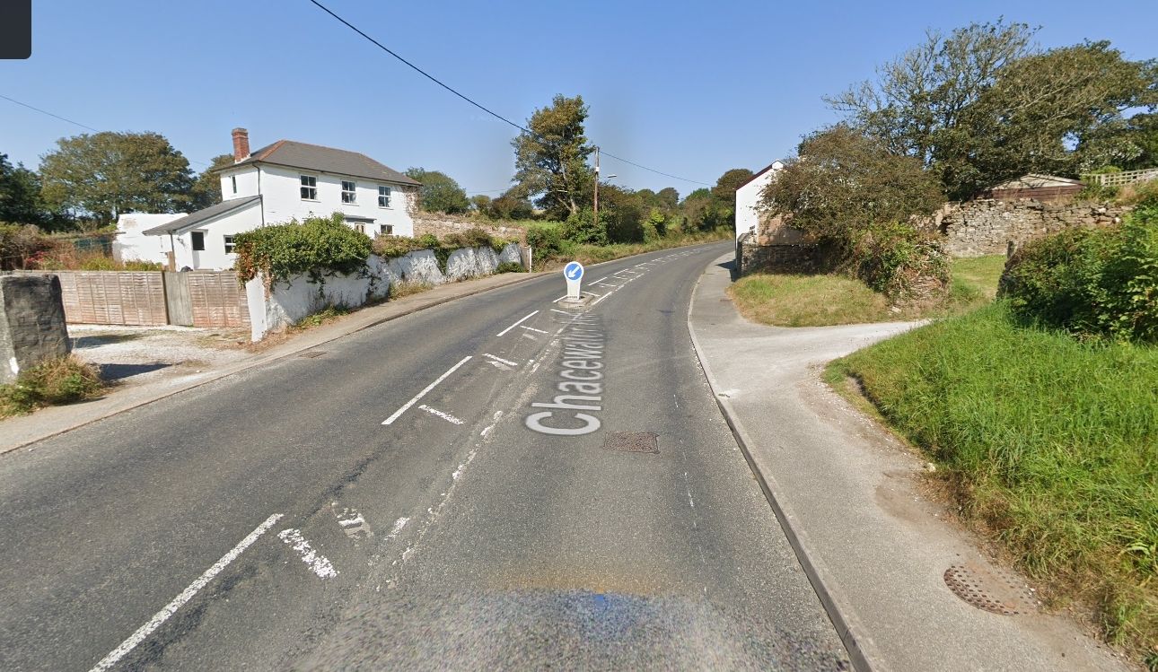

Mine causes issues, nearly always on examples in this image, i drive up the road and it must see that middle sign as some obstruction and has full forced the brakes on numerous occasions. Which I'm going around a mild corner so its not such an issue, but what when a car rear-ends me because of it?
I have the same as you Piles - on a very similar piece of road with a bollard in the middle like that. The odd thing is the inconsistency - one day it will scream at me, the next day it will scream at me AND put the brakes on pretty hard, and the 3rd day it will do absolutely nothing at all. It doesn't make any difference if I am accelerating gently, hard, not at all, or braking. I think the technology is not perfected yet !
