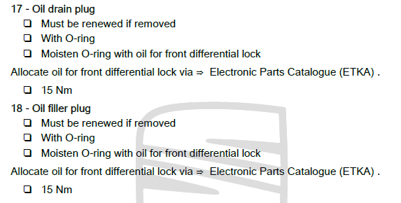

Thank you all for the information, all makes sense. The confusion must stem from the maintenance schedule manual which says
"Front axle differential lock: Oil change (only Cupra models)" but they obviously mean front wheel drive cupra only! The dealer should have known that though.

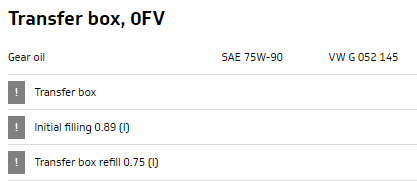

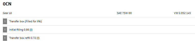

Fill for life quoted on the front bevel box (transfer box) OCN, OFN & OAV all say 'fill for life'
OFV doesn't say 'filled for life' and also has a slight difference in fill qty.
I presume this comment is referring to the OFV transfer box (all wheel drive coupling)
