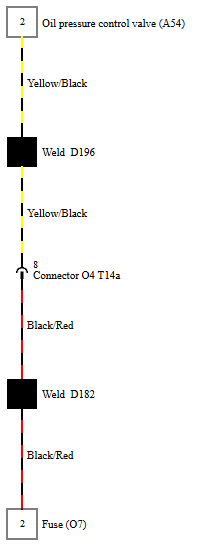

For that fault code:
1: check the solenoid supply voltage (pin 2)
Turn the ignition on. Measure the voltage on pin 2. Is it between 12 and 14.4 V?
Yes = pass.
No = Turn the ignition on. Measure the voltage on pin 2 (O7 Fuse SB4). Is it between 12 and 14.4 V?
No = check fuse
Yes = Measure the resistance between pins 2 and 2 (O7 Fuse SB4). The resistance should be less than 1 ohm. Check all wires; renew if necessary. See the diagram below for details on wire colours/codes, connectors, welds and locations (if applicable).
2: check solenoid operation.
You have a new valve so can probabbly skip this step!
3: check connectivity of pin 1.
Measure the resistance between pins 1 and B 17 (E1 Engine control unit). Is it less than 1 Ω?
Yes = pass
No = Repair the wiring. See the diagram below for details on wire colours/codes, connectors, welds, shields and locations (if applicable).
