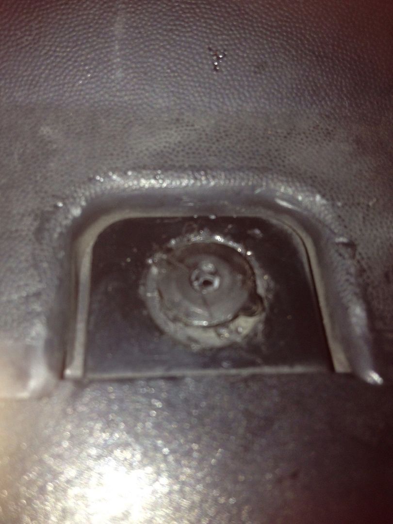

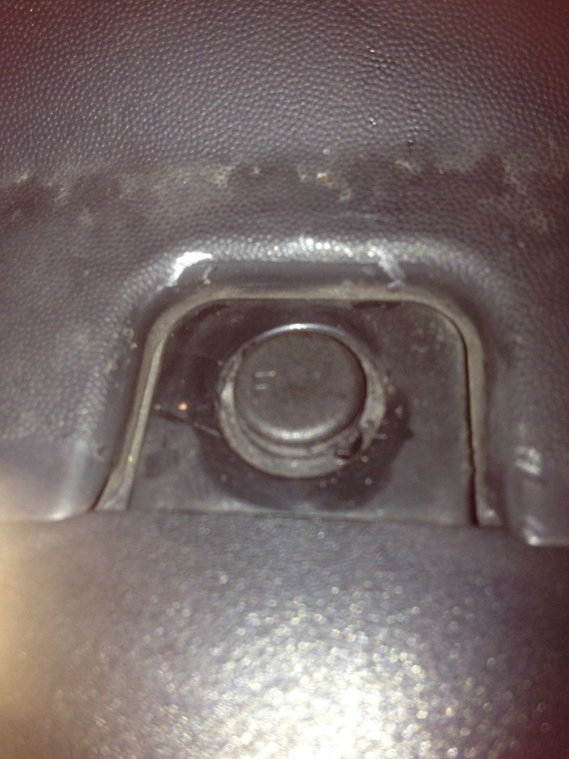

I tried the cutlery trick and it worked perfectly. Removed the unbroken pin in seconds! My only problem now is that broken clip. Some pics below to show the mess up I did on the broken one:
Unbroken
Broken
