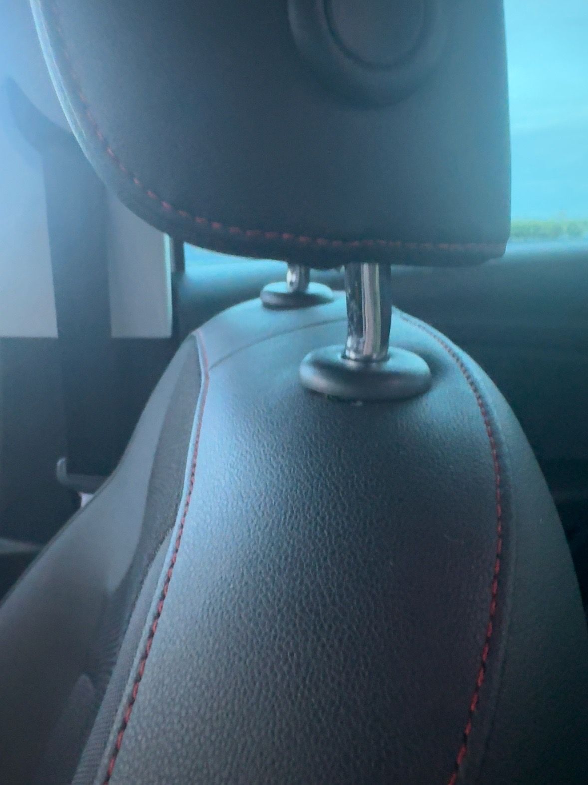

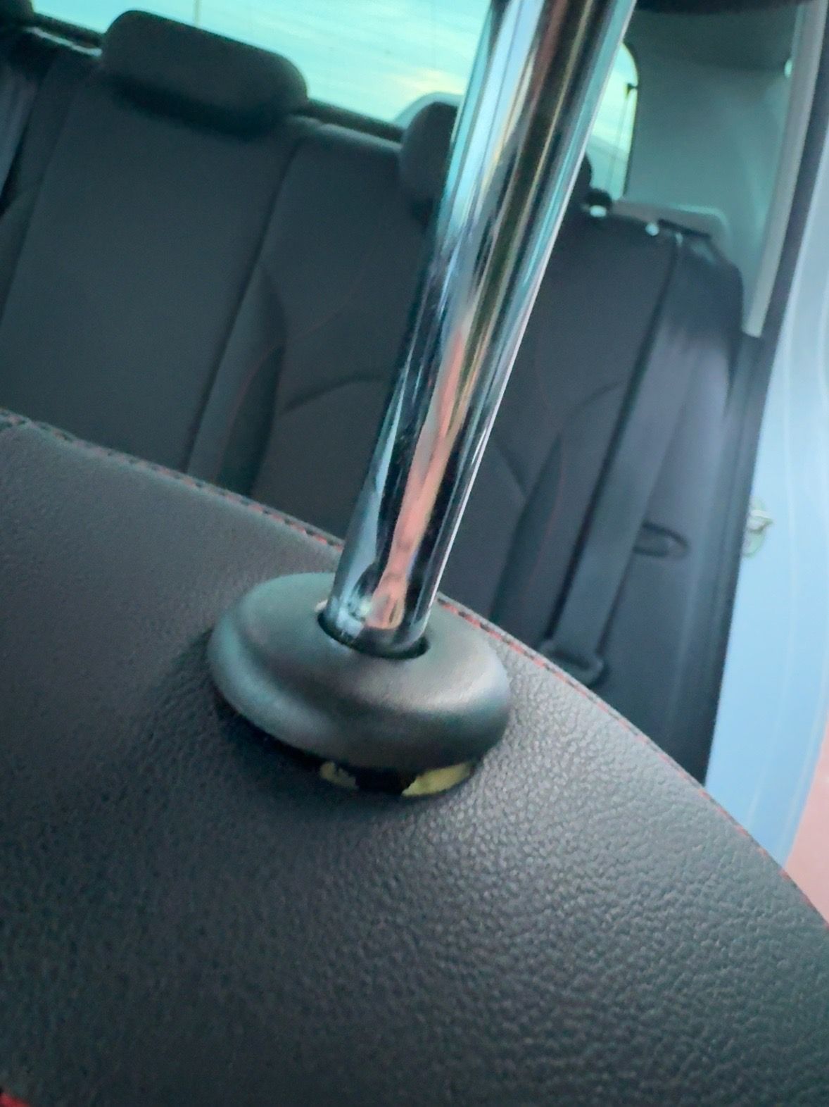

Just had a look, it does appear if you push the material down around the plastic ring on the seat back, where the metal pole goes through, there is a pin on the underside, don't know if pulling or pushing that out or in on each side will alow the headrest to be removed?
Obviously you do this at your own, but might help if you really need to get your headrests out

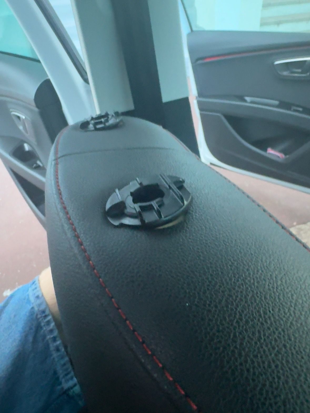

You can remove them, it's not easy as the buttons are really small and hard to push, you need to pull down the upholstery a little bit and plastic ring will reveal itself and you will be able to locate a little button. It's hard as you need to push the headrest up and at the same time push the button - use screwdriver or something hard as you will destroy your fingers trying to push it. I have custom made covers and it took me a while to figure out where those little buttons are but once you'll find them you'll find a way to pull them out.. Oh and it's on the one without the button to regulate the position of headrest.

That is that little fecker, u will need a flat screwdriver or as I did... A metal spoon :)

I have these buttons under both plastic holes, both metal foots of head rest needs to be released by pressing them. It worked like a charm!
No need to press them simultaneously, just be sure to press one, move metal foot at least 1mm up and not to press it back. Then press second one and easily slide head rest out.
